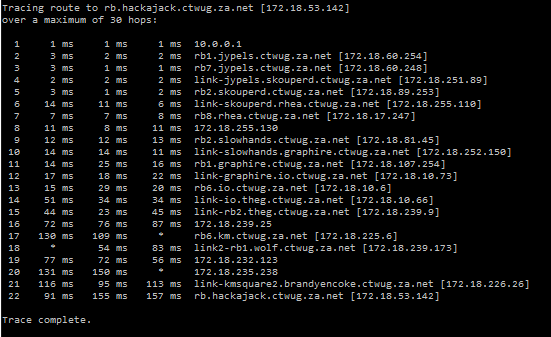

HackaJack is still active according to Tracert though

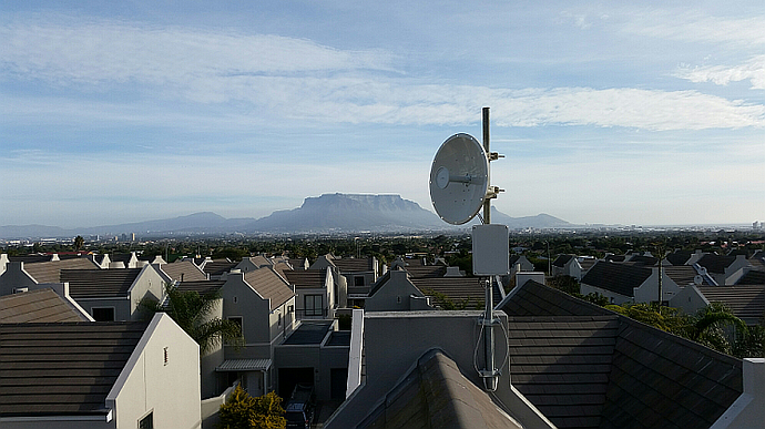

@darkwing I managed to get some proper pics from the roof, and @Sandman is looking into the test kit for me again to do a proper scan now that I’ve found a way onto the roof.
Does this look like Atlas or Ganymede to you? I’m hoping I just might have an option between the trees and edge of the reservoir there…

I think Atlas is behind that tree.we will have to look at bb links in edgemead or monte vista

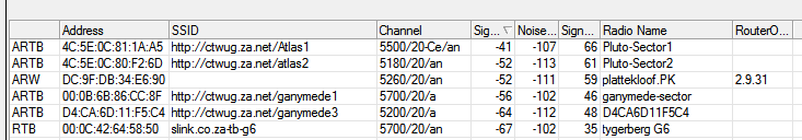

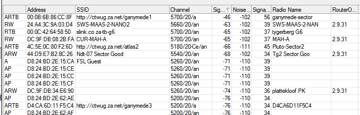

I completed the scan - Atlas2 indeed is well reachable, but Ganymede’s sector even more so…really great signal.
Is Ganymede an option, or must I concentrate on Atlas2?

Thanks, will swop out the grid for the Rocketdish asap (I didn’t want to scan with the dish…roof is precarious and steep so used the grid as it’s lighter :smiley: )
Put it all on a pole, so left it mounted…RB and grid are still up there and bolted down at the moment.

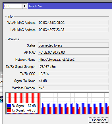

Connection with the grid looks so so - have disconnected but here the info while it was connected:
Got everything installed…signal to Atlas1 is dreamlike - is that not the better option to connect to?
