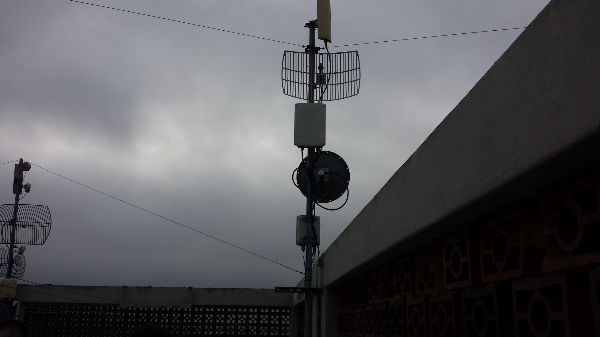

Installation happened on Saturday, this site is now up and running and we have made a plan to temporarily connect it to airwolf. Thepark has its first client Bushwood who was moved from Airwolf to thepark. We have aligned the three links to ariel Airwolf and mimas.

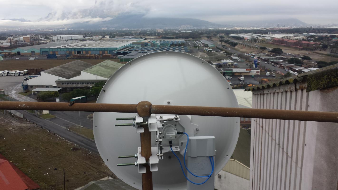

The installation happen as planned, the link is up and running and is really performing well.

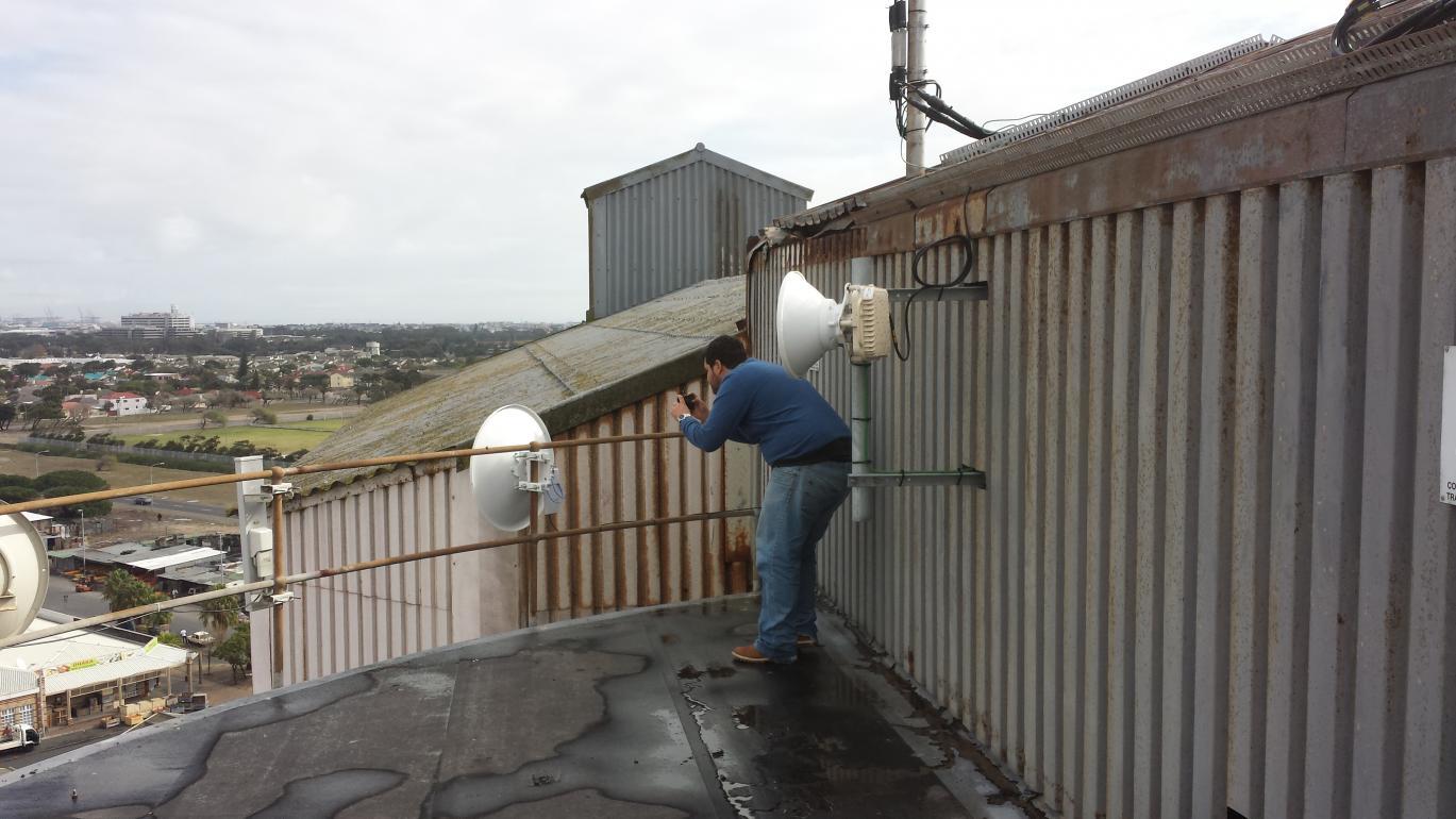

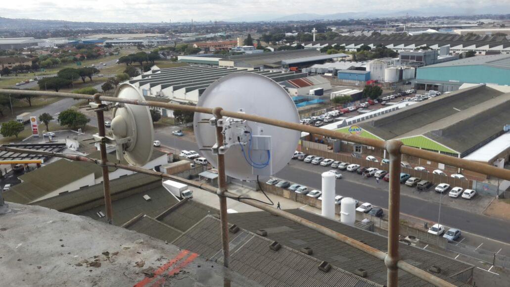

Airwolf install for the Lapetus link did happen today with no downtime, good news is the link is performing very well, big thanks to the guys that came out to help, I know it wasn’t the best conditions(very cold and misty) 7am but you guys did an awesome job.
Wolf
Mighty_mike
Dan
Landrover
Weasel
I will upload some photos at a later stage
Some pics

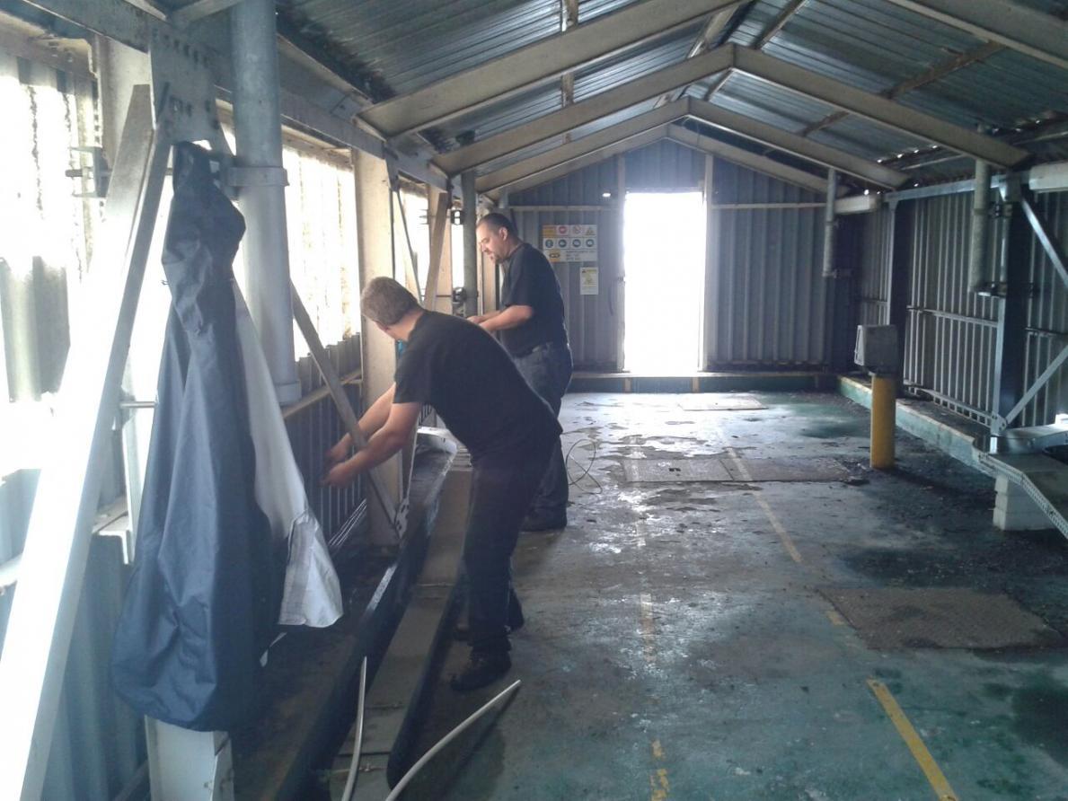

Mimas 5-4-3 is alive!!!
5 men 4 hours 3 links is what happened today. Myself, Dan Hyperlink, Wolf and porky went up the silo this morning to get the links up in only 4 hours.
The hyperlink and lapetus links are up and running, still need some fine tuning. Ironman links needs a bit more tuning from ironman side and alignment and should be running tomorow some time.
I would like to take the time to say thank you to everyone involved that help make this happen.

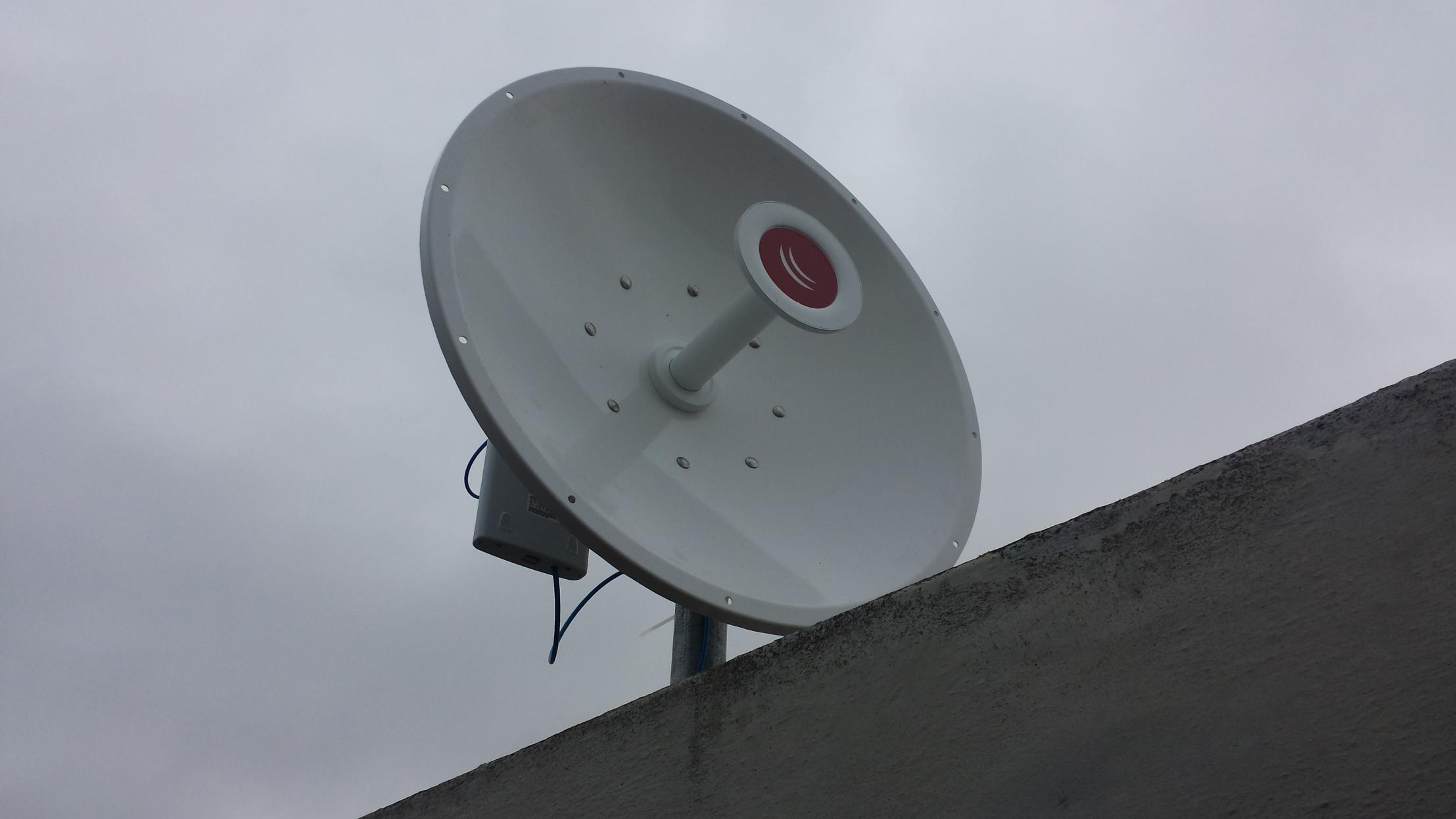

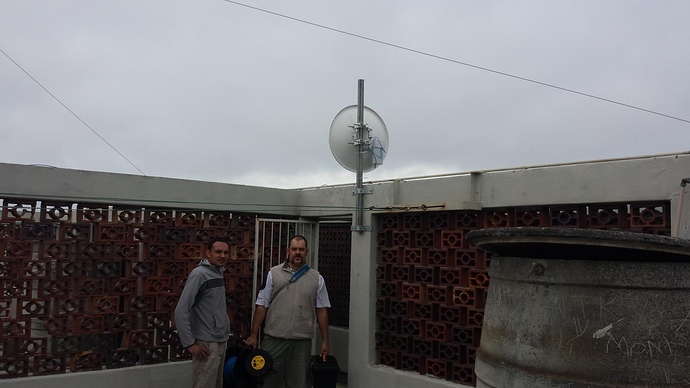

Ariel install
Dan and mde
Airwolf install
Weasel, wolf, Dan, spotpro Mighty_mike and landrover
Lapetus install
Bushwood, Dan and Wolf

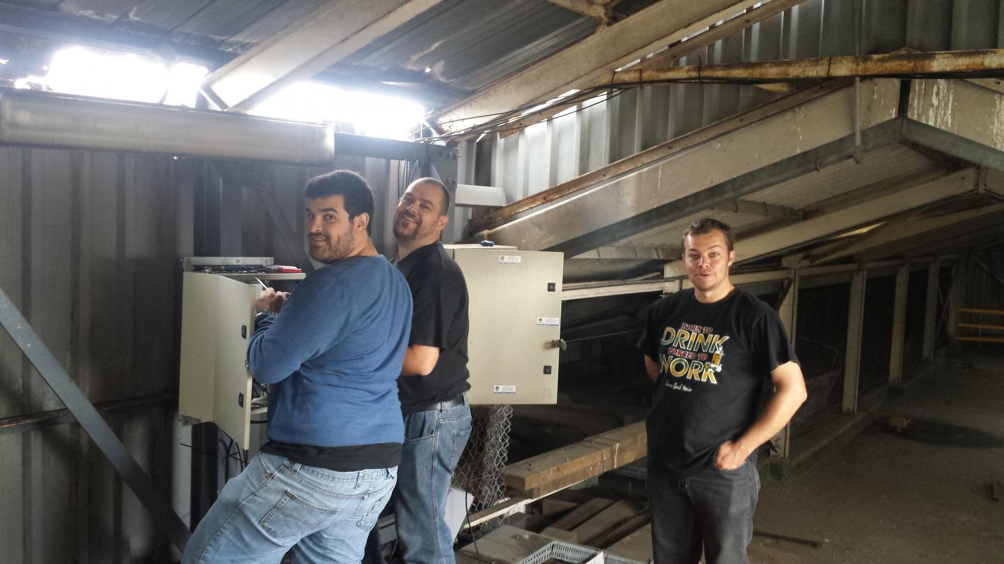

Mimas install
Porky, Dan, Hyperlink and Wolf
Thankyou nextlevel for assembling the the enclosure for us, a job well done
Also thanks to the committee for supporting the project all the way and lastly thanks to Ironman for all your patience let hope it pays off with the alignment.
Pics will follow
