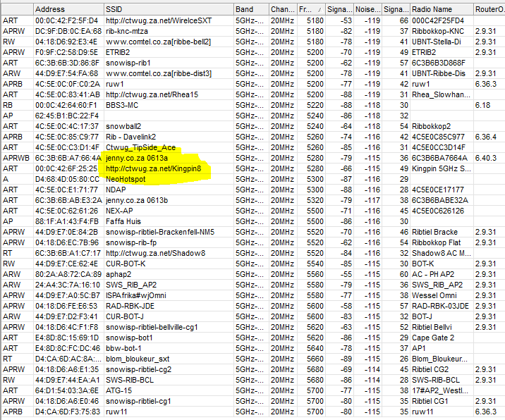

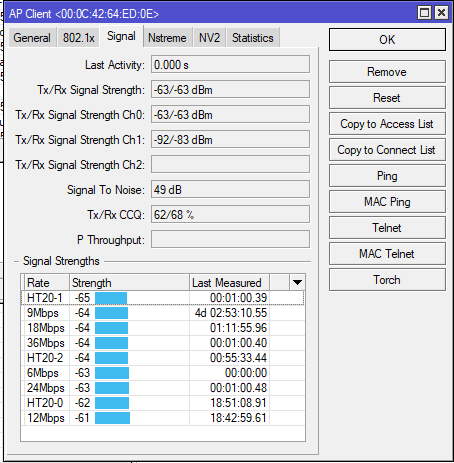

Hi there, I am connected but my link is really slow and i am not sure why or i suspect why but cant do anything about it. My ccq is utter crap I have checked for line of site and all looks good, I can see alot of dishes on Rhea

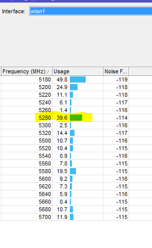

I can see that someone has started transmitting on the same ferquency (Jenny.co.za) which may be my problem, pls see below.

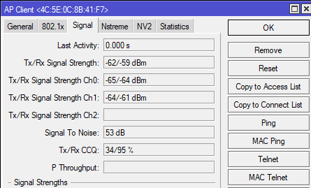

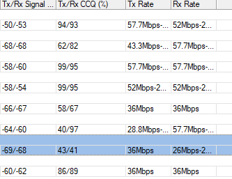

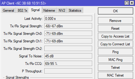

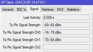

Hi Markg
You signal is a bit high.There are currently 4 guys with good signal and perfectly fine ccq and 4 of you with bad signal and terrible ccq. Below i highlighted yours.All of the 4 with bad signal and ccq have a chain thats terrible. Perhaps try and realign first. Please bare in mind we are experiencing some heavy winds lately so it could be highly likely some things could have shifted causing bad signal & ccq.
Below one is yours.:point_down:
I will try but -69 the best i can typically get I have a rocket dish on the roof

Thanx Bronny but he dosent seem to be connected to Rhea and is not on a sector as i am and is most likely on a different frequency
@Ogon Razor1 helped me to setup the RB … the signal and ccq are alot better
