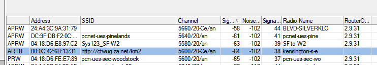

Managed to put the longer 3m pole up for a better scan and am getting decent LOS to KM.
@Dan perhaps you can help - is there any space available?

Hi,
7.6km is unfortunately to far to link to the sector.
There will be a new sector at Atlas shortly which is 1km from you.
I would advise you link there when it is installed.
Regards
Dan

A sector tends to be low in gain due to the area(beam-width) it has to cover.
So your TX signal would be good as you have a high gain antenna, but your RX won’t as the sector can’t see you as well as what your dish can see the sector.
This will cause a overall degradation of performance on the sector, thus affecting the other clients.
+1 As diabolix has stated.
It can look something like -64/-78 (TX/RX). Your scan only shows TX.

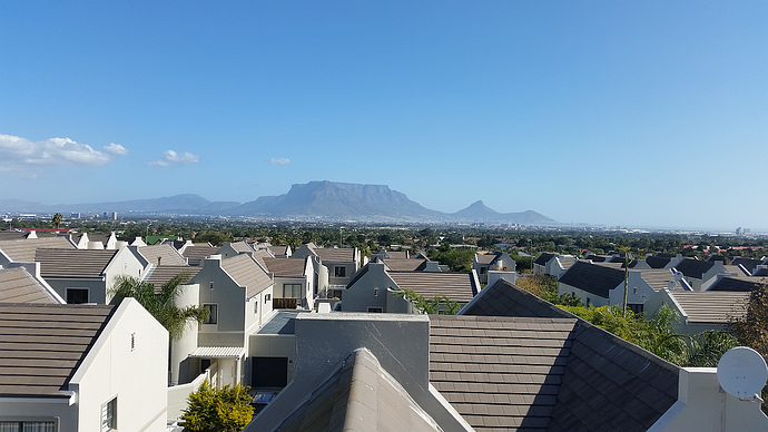

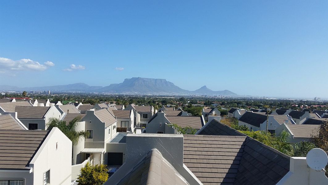

Got onto the roof and took a pic toward Jupiter / Pluto
(I’ll have to get the test kit again I reckon) But anyone who is more familiar with that part - do you recognise something to give me some hope?
Or are those trees in the way already?

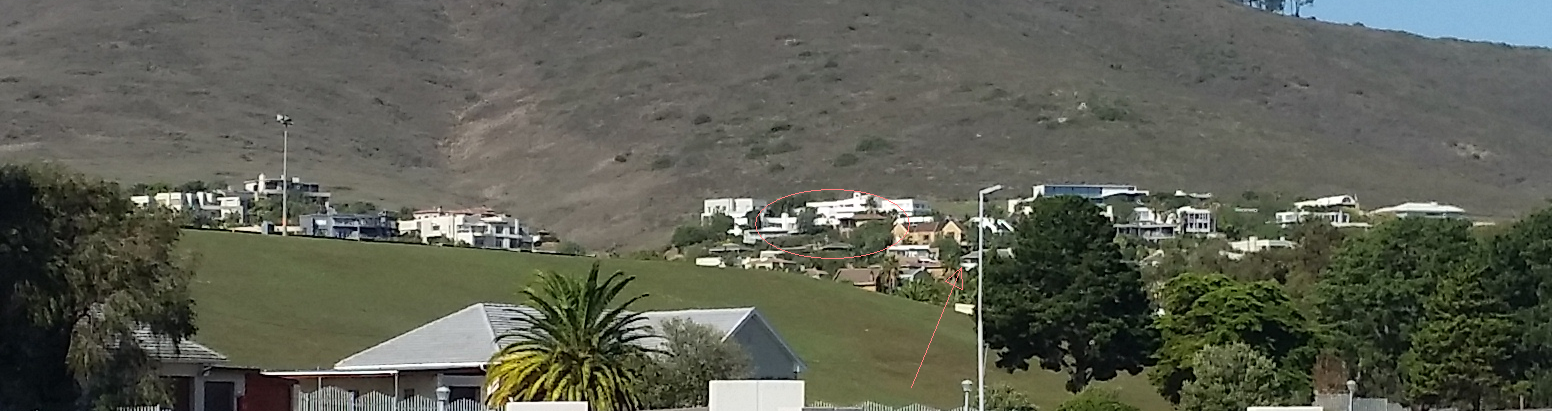

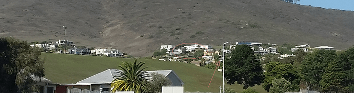

If I can get a solid connection, I’ve the opportunity to help folks as the view W and NW is good and open - here’s the pic:
on the 1st pic it looks like the trees are definitely in the way and no connection will work. From the second pic your best bet would be to do a test scan and hope you pic a backbone node up. If you pic someone up at a reasonable signal and have clear LOS then you can ask to make a Point to Point link, Although that this would also most likely mean that you have to host a sector or make another backbone link to make it worth the while of the backbone node as they have to use more frequency and space on their mast.

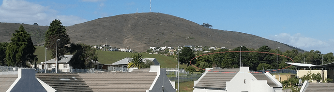

I would be keen to host some bb links - I have the other rb available and a grid (willing to invest in another dish but will need some advice)…I guess the right discussion might be: to where would this best be done for the benefit of the network? (What would be the ideal? What if…?)
I’ve posted before that I picked up bb links to brandyencoke, km2 is in sight, neptune/MajorTom/Nextlevel/HackaJack etc are near and I approached moontop right at the beginning of this quest. I guess folks might have seen it as just getting myself connected, but perhaps we need to think bigger and doing bb?
Also, I think there may well be LOS to ganymede (circle) and atlas (arrow) - is this not them on the pic?
