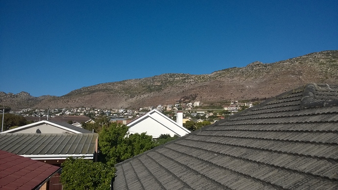

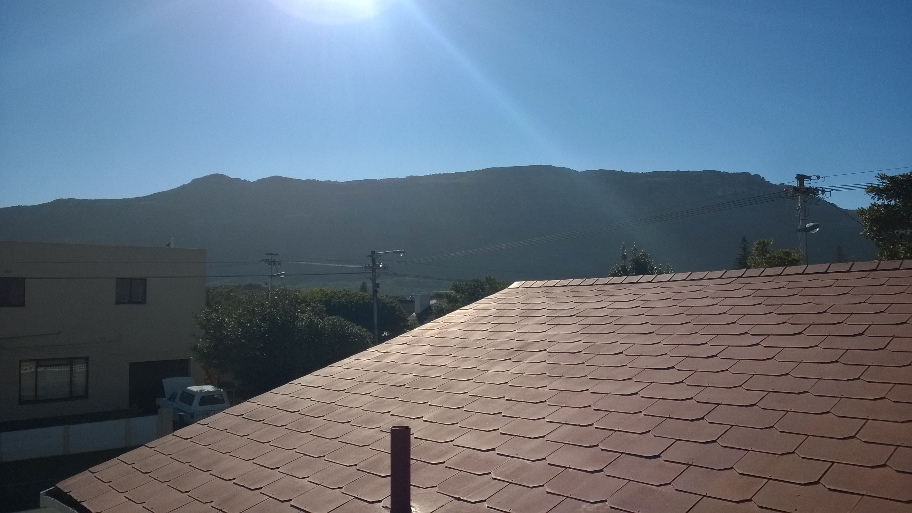

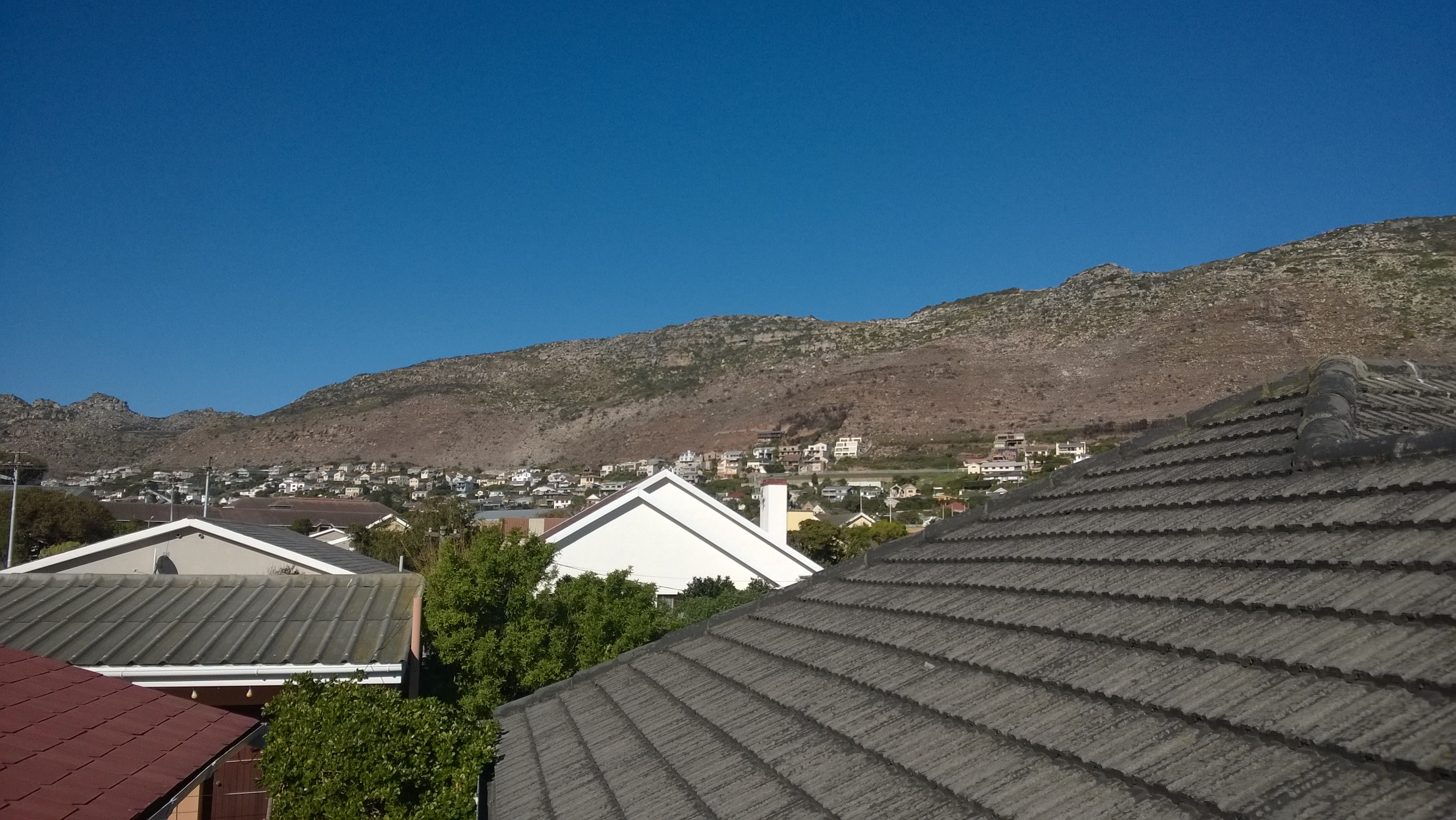

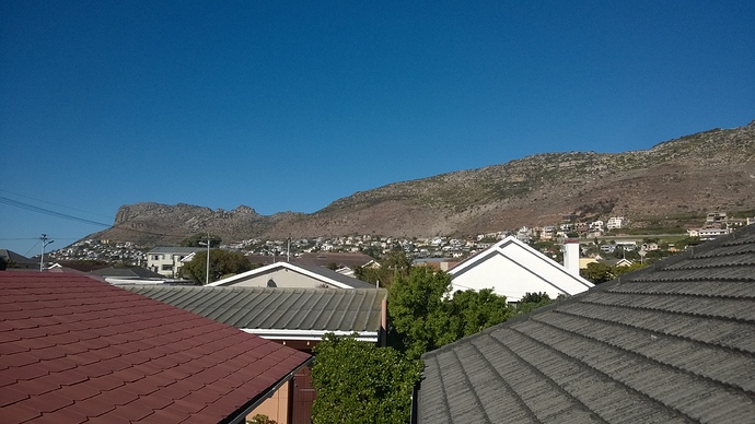

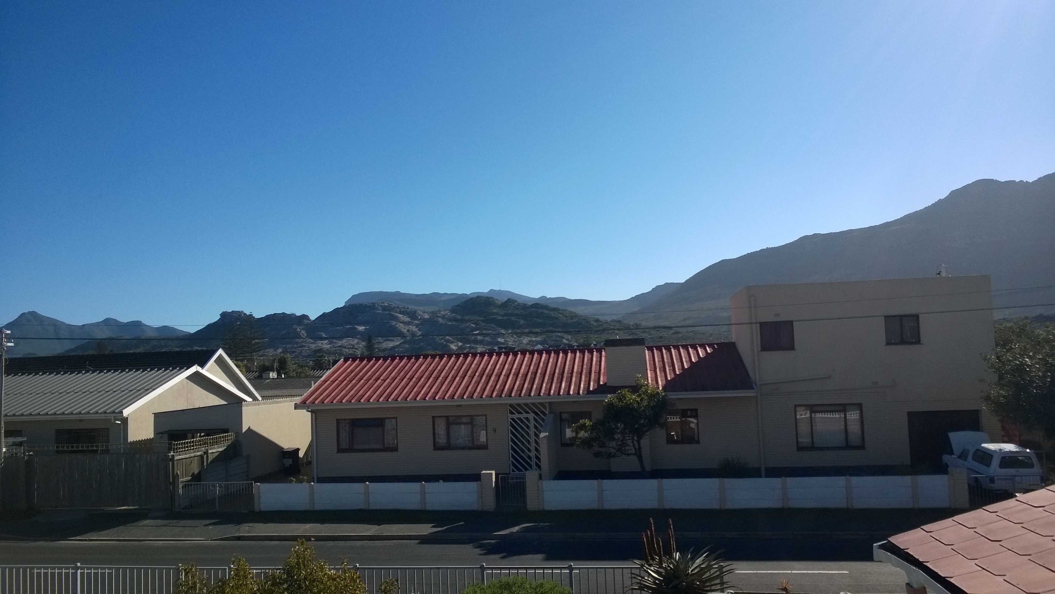

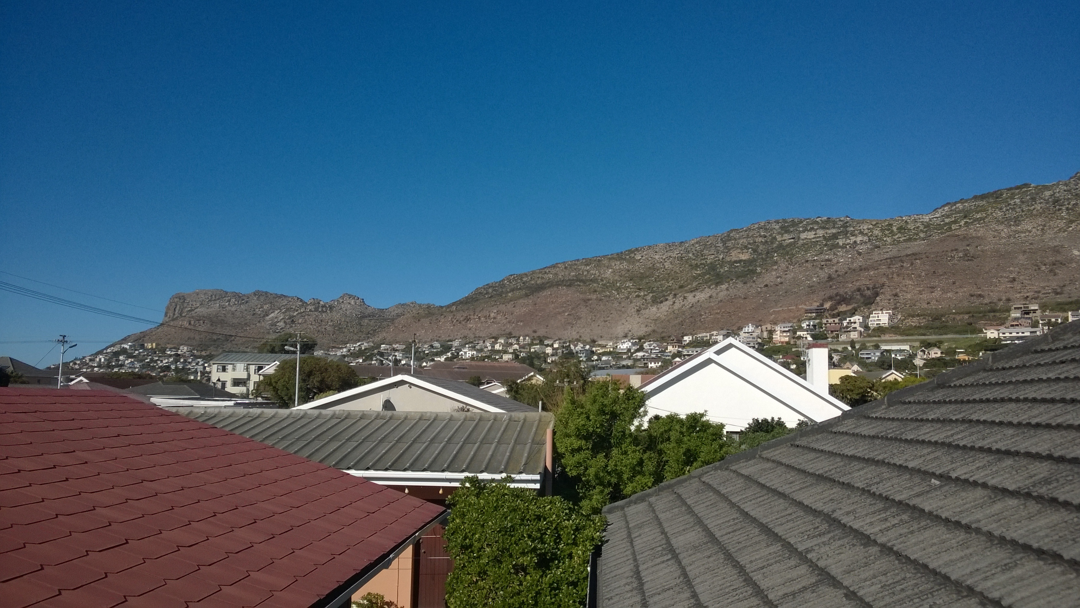

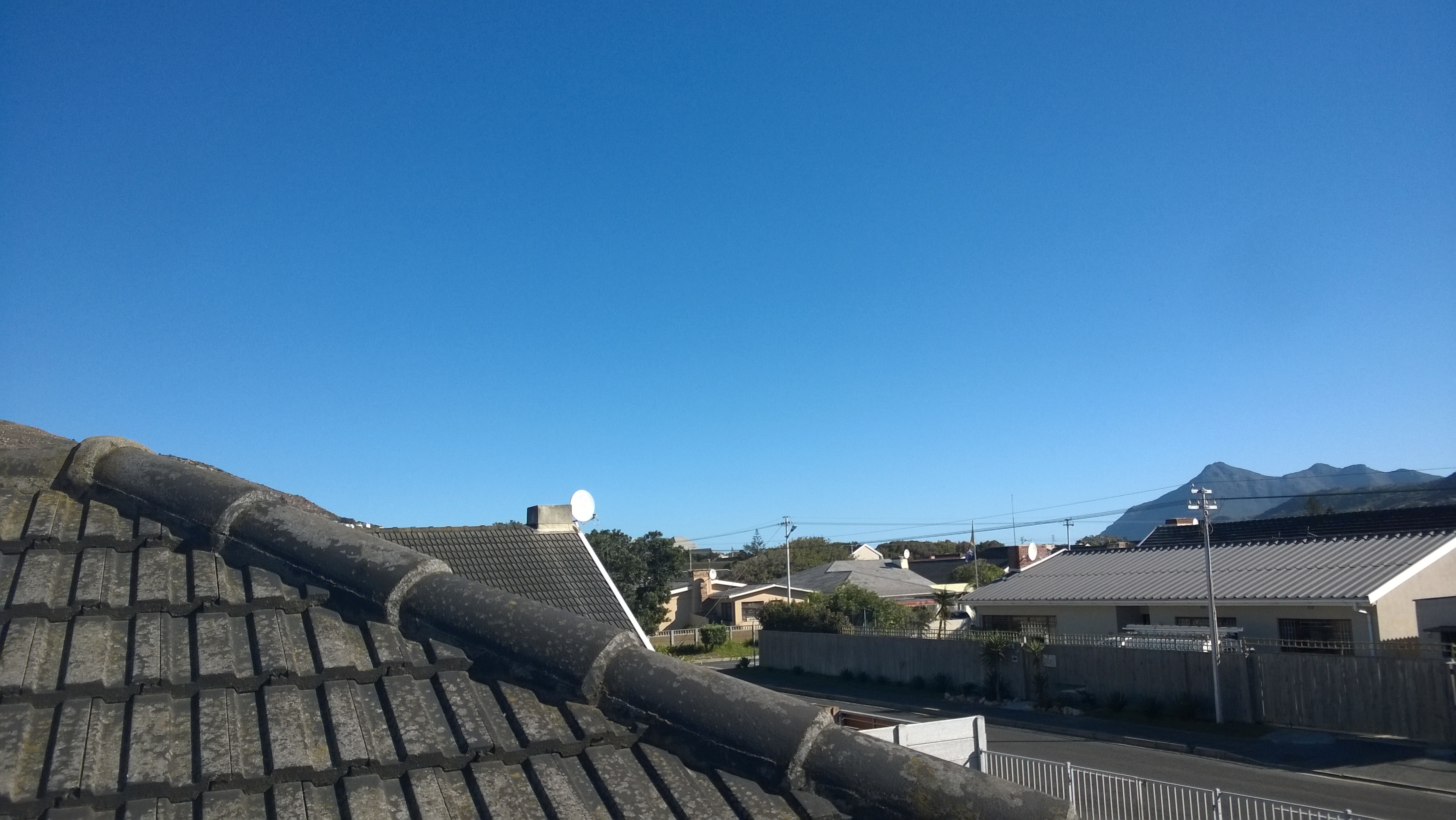

I have borrowed a ladder and gone up as far as i can and taken pictures of what line of sight i do have… I’m concerned of the flats that i think are in the way…
Post the pics here, or on your node?
