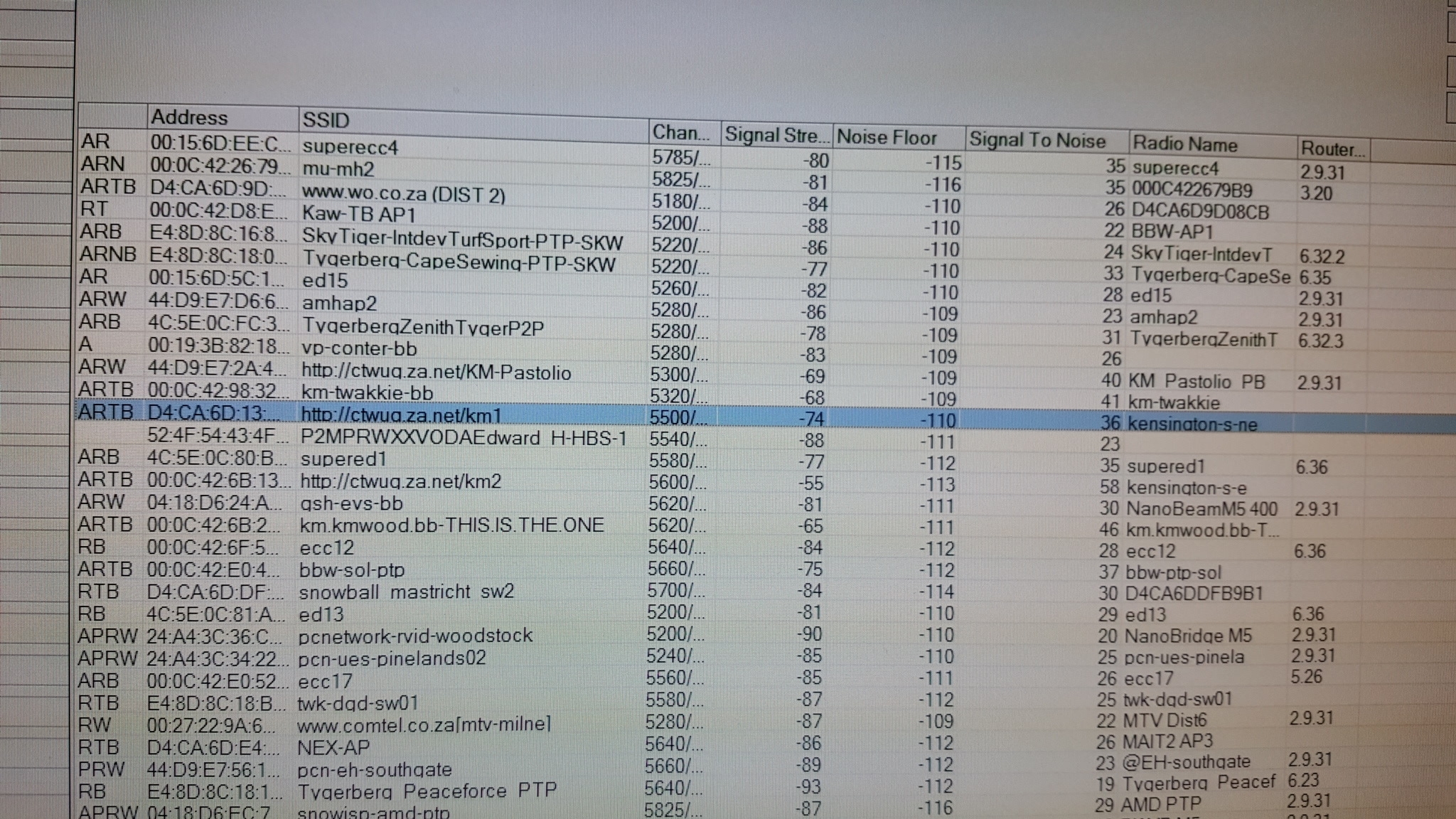

Connection been up and down since Sunday ,keep on searching for network , what info do you guys need to investigate

I think your sxt could have turned, could you please realign. Here is the reason why you are disconnecting
KM sectors are set to disconnect clients as soon as their signal goes over -75

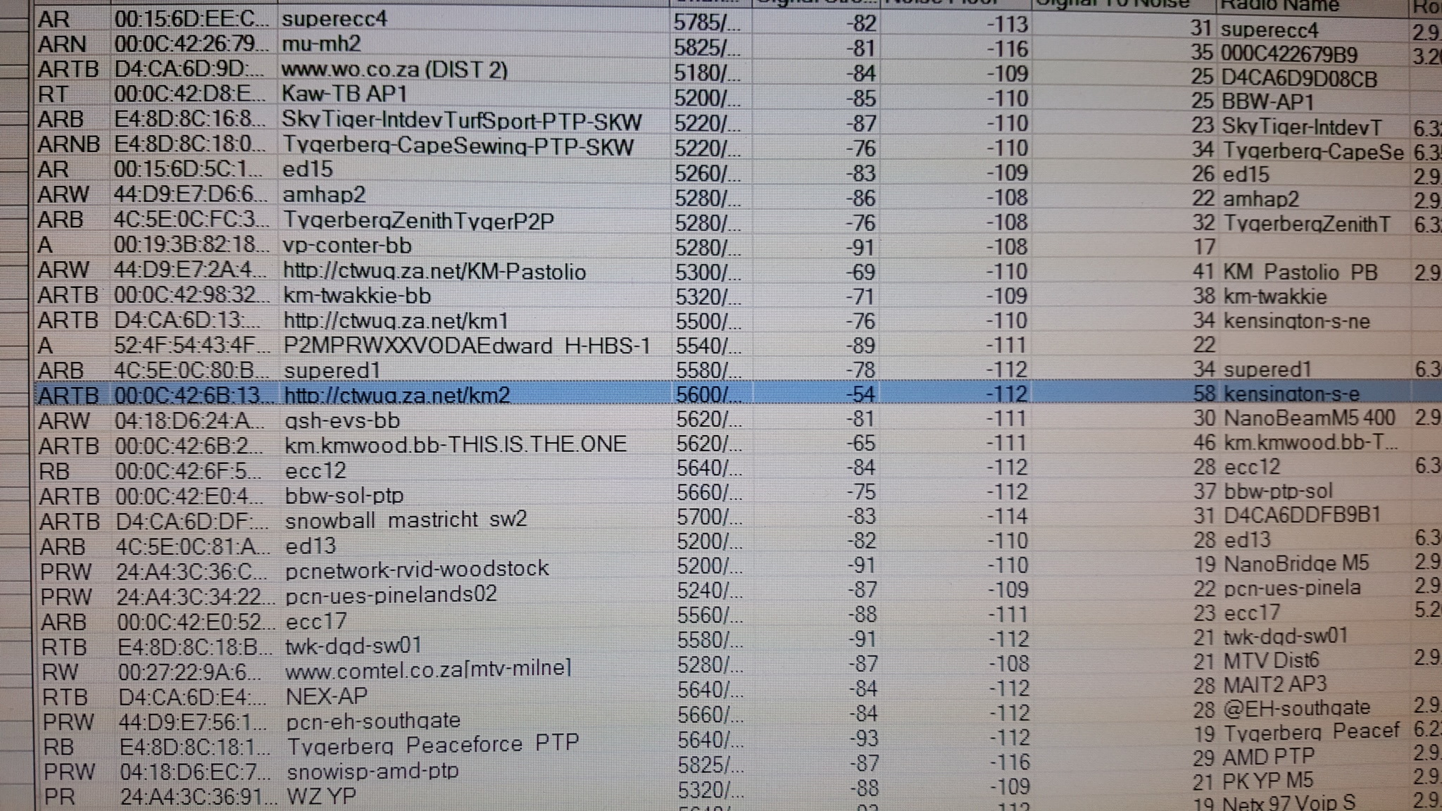

Candyman please scan and see what you get sector 2 and 1 at.
Candyman I move you over to sector2 please connect there.
