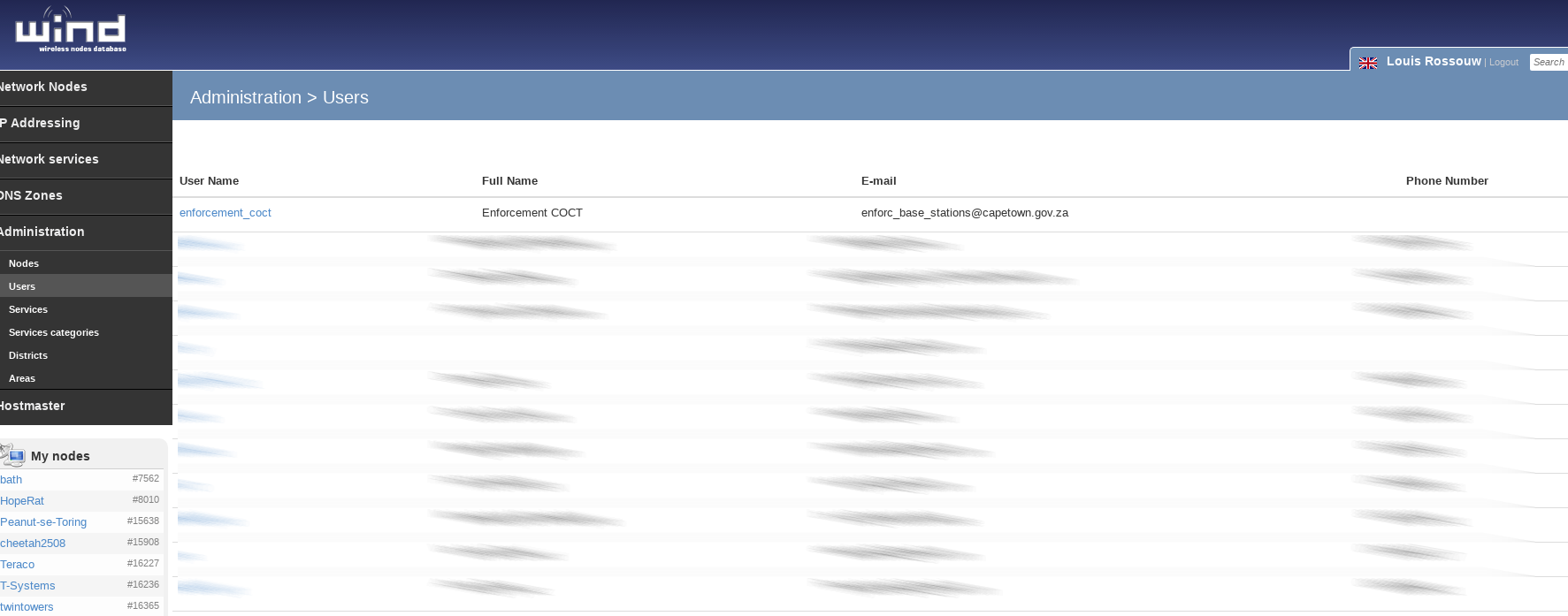

I’ve just figured out that City of Cape Town is logging into WiND and check for our nodes/sites. I spotted this while checking the logs and seeing logins from IPs that appear to be coming from the
I just noticed a user that was registered on WiND as well:
Seems like they are targeting masts and communications base stations (basically anything on the roof that is not a DSTV dish or TV antenna).
Please reply below with practical suggestions on what as the @Committee can do?
Any ideas how to hide radio dishes on the roof? Perhaps build a roof like frame over it? Disguise them as DSTV dishes?
Has anyone been contacted by this user?

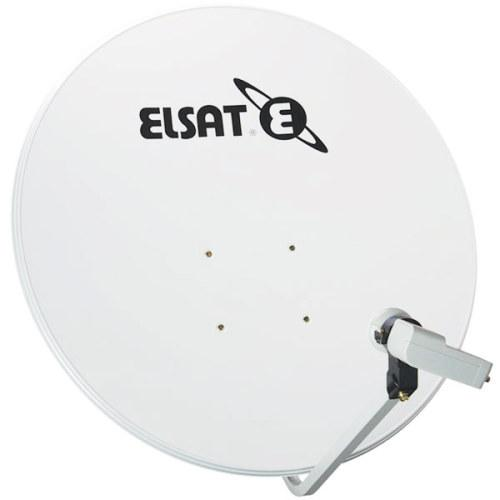

Can someone make a stencil/logo like this?
Want to spray it on my dish so it looks like DSTV.
Will spray paint affect the signal?
Just saw this as well:
@spin I just asked the guy that owns the local sticker/printing shop in my area (delft). He says he will charge about roughly R40 a sticker. Didn’t ask for bulk as he is in festive mode.
Just be careful for using names that has copyright on it, don’t want an infringement case either
Can just edit it a bit. Just needs to look similar at a distance.

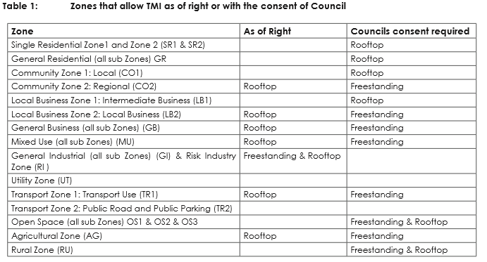

Long story short, the definitions that you will be nailed on if your zoning does not allow it:
Note that if your mast connects to “any part of the building” it will be seen as an RBTS station, this would include devices mounted on walls.
FTBS does not connect anywhere but the ground.
As you can see here, any residential zoning requires consent. This consent is for ANY device(s) to go up at all. Note that there is no height limit at all, consent should be obtained, full stop. If your zoning has the right to RBTS, you would need consent to go higher than 3 meters above the roof at the point where the structure is placed.
Now, note that the devices are legal, but the structure to hold it in place is not. These do not apply only to wireless devices, but ANY electronic devices that can be use for “transmitting or receiving of electronic communication signals”.
How many of you have Electronic doorbells? Or intercom/video doorbells? Did you apply for consent? Please do, you would need plans showing these devices drawn up to submit, as well as around R3500 for them to consider your request.
Security cameras? outside booster for 3G/4G antennas? Alarm connected via radio with antenna mounted outside? Motor on gate in driveway? Please do as above to have compliance…
How many of the COCT “police” knocking on doors are actually compliant to these?

You can spray Satellite dishes with a NON METALIC paint. If the paint contains metal particles, it scatters the signal instead of concentrating the beam to the focal point of the L.N.B.
