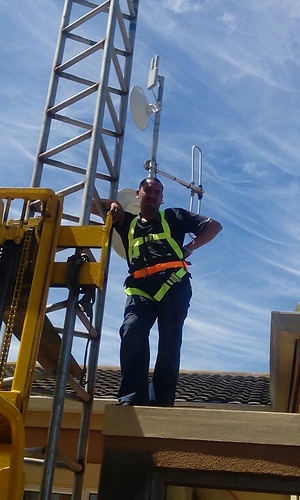

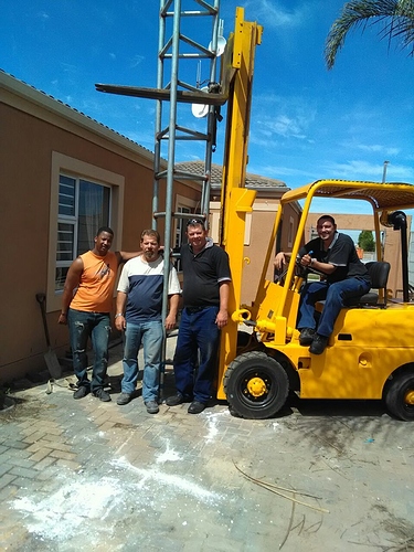

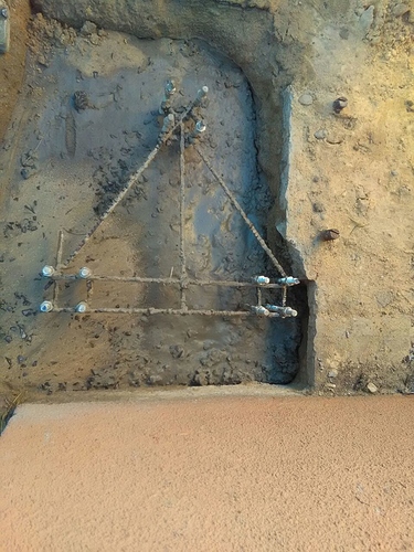

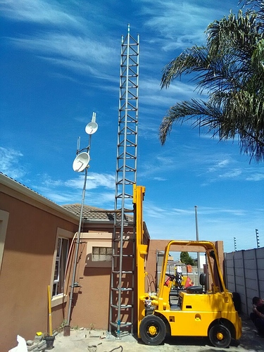

By Friday morning the foundation has settled and ready to install mast, it seems Coms has many friend and organised a fork lift in a residential area to lift the mast into place:stuck_out_tongue_winking_eye:

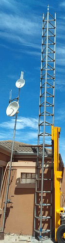

Mast specifications
Height - 9m single 3m pole could be added soon
Round tubing - 48mm x?
Pieces - One piece mast
Staywires - yes 3mm one more will be added
Welding - will be treated with gold galvanize

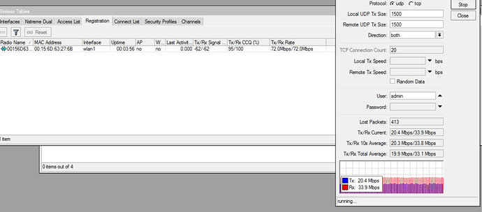

Ogon can you have a look at some settings on the mossel2 sector…seems I can’t ping or tracert beyond the sector…shows connected…everything seems fine from my side…ccq @95% and tx and rx rate at 98%…
Hi ogon. I have connected to mossel2 sector, ccq is 96% signal is -40 I have created a user account for ogon. Pls could you help with the config to get connected to the wug. Thanks.
