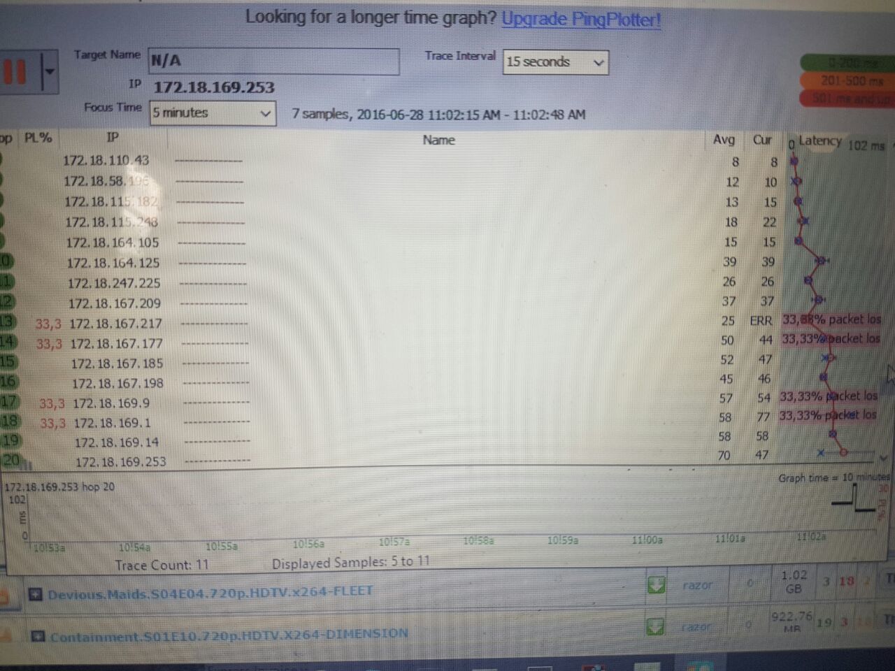

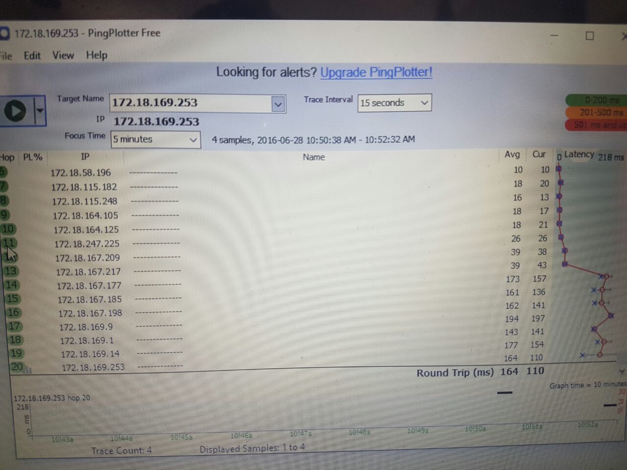

Yes please see the following:
and…
Very Erratic link
If you log in to the rb you cannot even properly ping the next hop as per the first post.

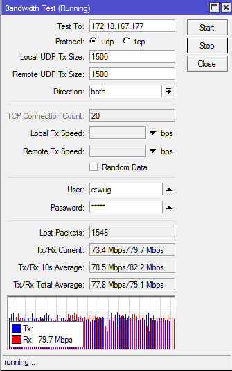

Please see bandwidth test from Roukie to Raptor.

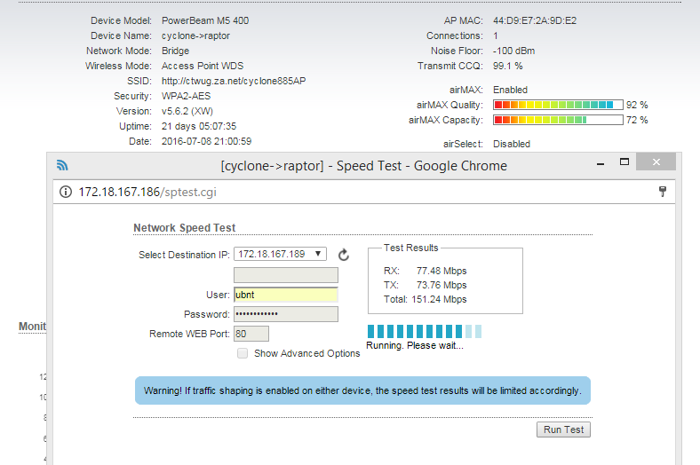

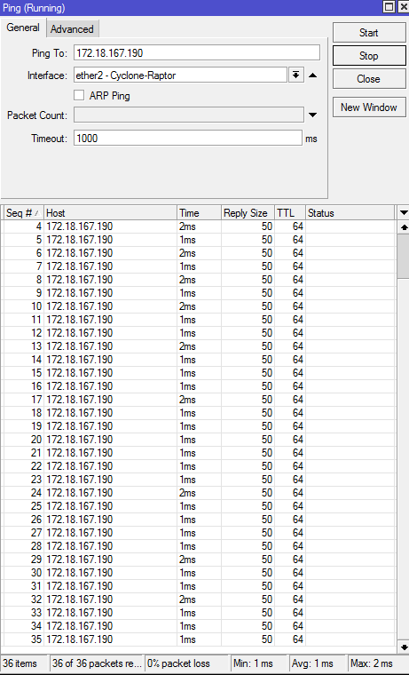

@Spin… Please see attached as proof that link has been sorted…
Is the PPTP on the RB also removed?
Yes it has… It was the first thing I did thus the reason for posting
