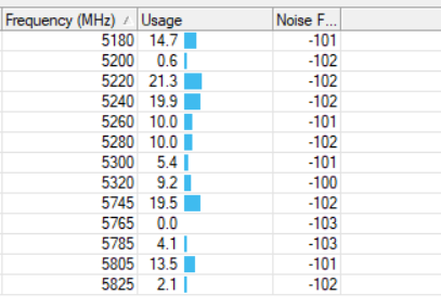

These are legal - did a frequency usage scan in winbox
Setting up my routerboard as follows
Channel-width 20Mhz
Country South Africa
Frequency mode Manual-TX-Power
