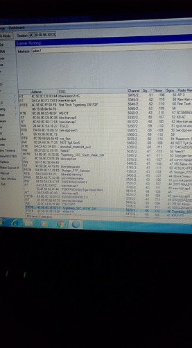

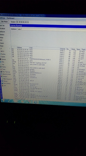

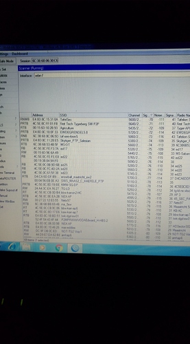

Got the test kit still testing

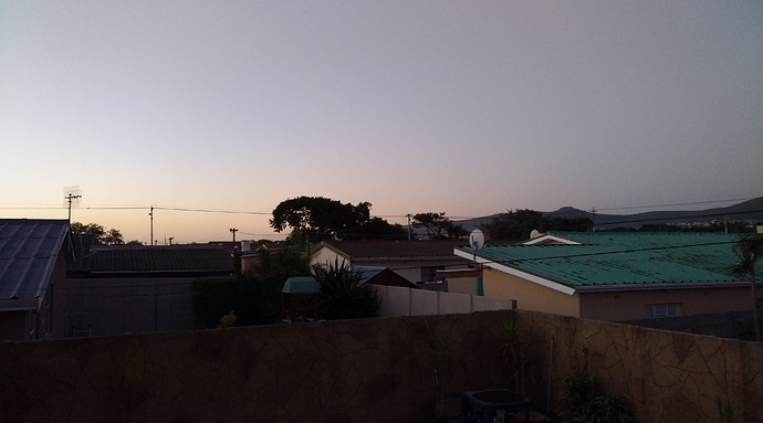

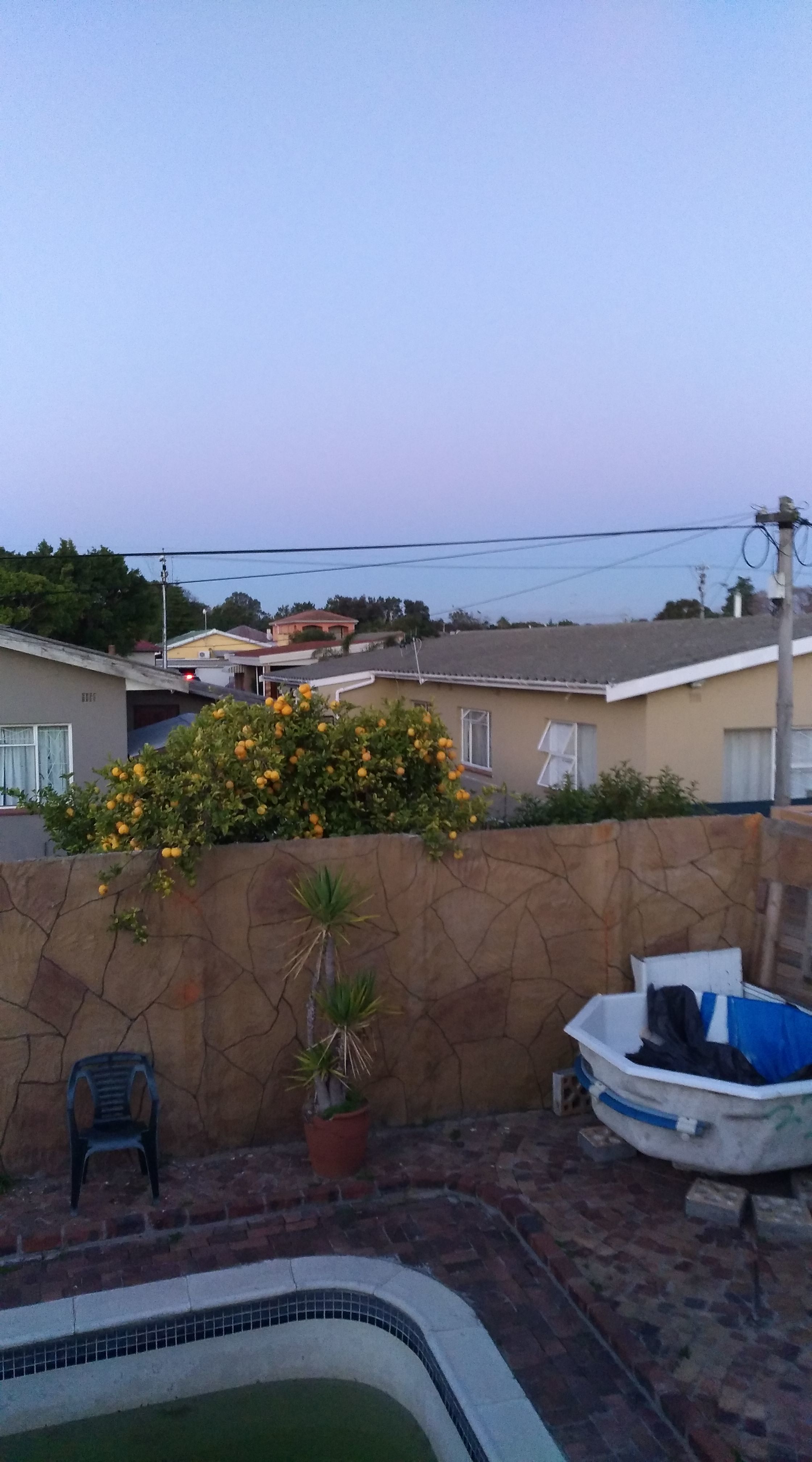

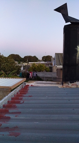

Kyk hier @Deathm

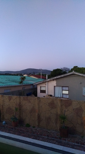

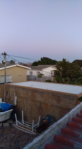

No WUG ssid’s there. You need to get higher up dude.
@Deathm, the two nodes you should be scanning for:
Sneaki - @sneaki - Goodwood Area, close to you
Quincy - @quincy - Parow Park flats

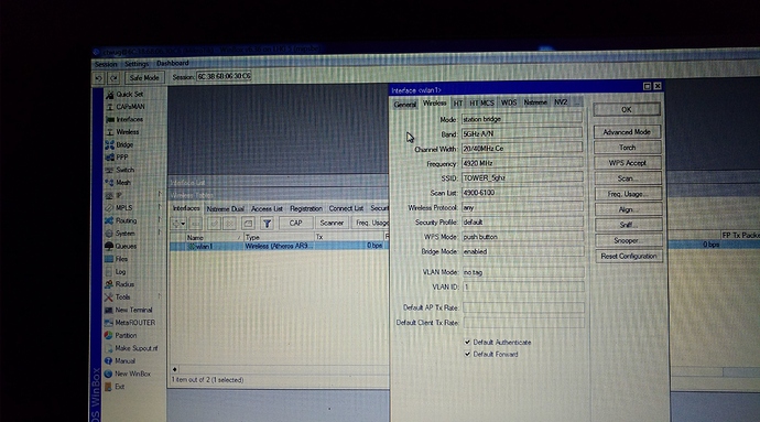

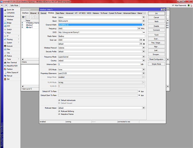

please just make sure about your settings. you need to change your channel Width to 20/40Hz eC.make sure your on super channel under advance mode and your wireless protocol must be nstreame
