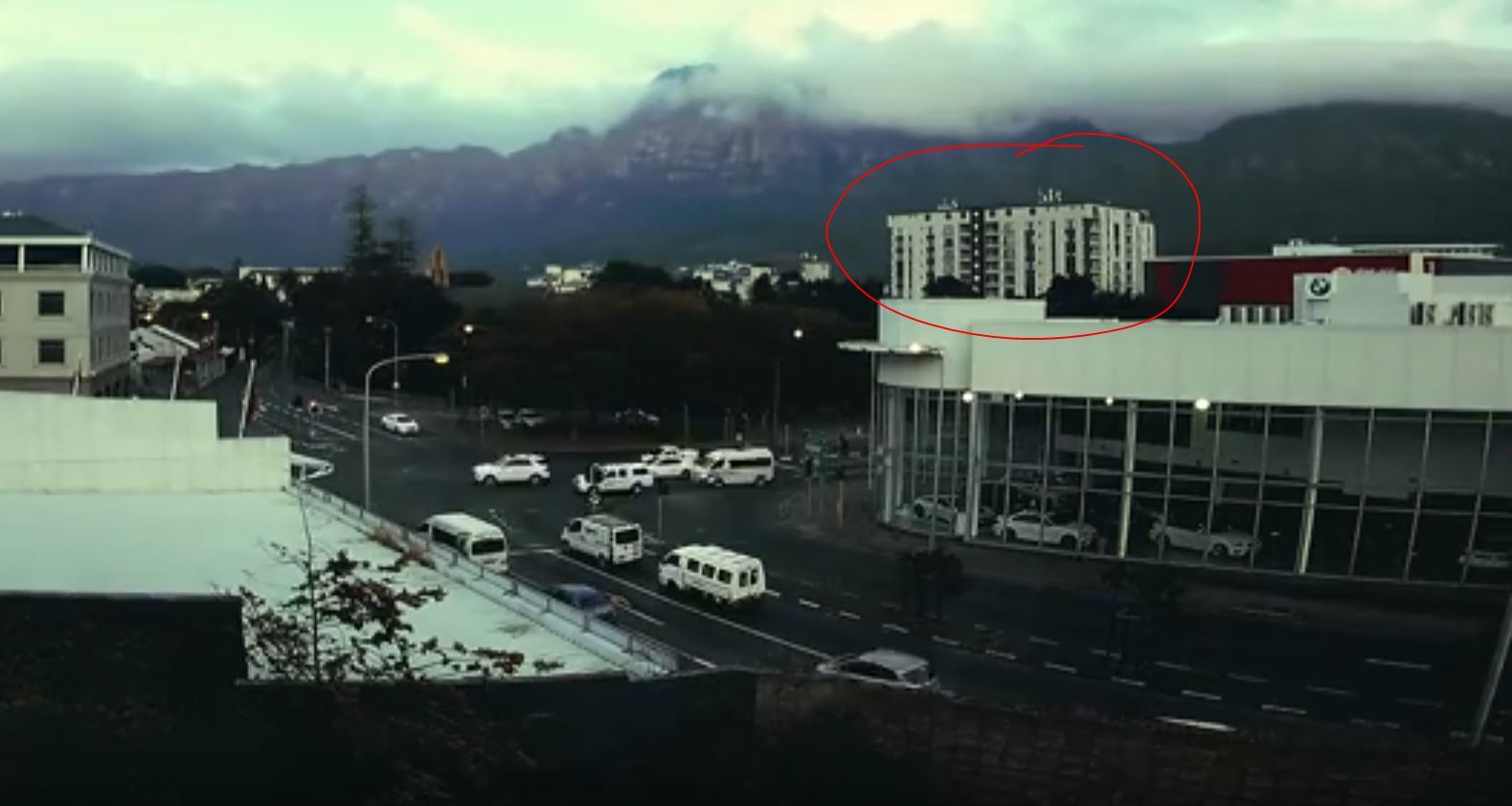

I am connected to a Wireless connection across the road, through WiFibre, they are based in The Beaumont flats and I am in Marlborough Park, across the road 4th floor - so “decent ish” LOS
I am however not able to get my signal around the magic -60dBi levels… it’s always hoevering around 70-80
Is there a way for me to optimise the output / tweak it for better results, as I suspect the hardware is trying to achive distance rather than the 200 odd metres I need to cover…

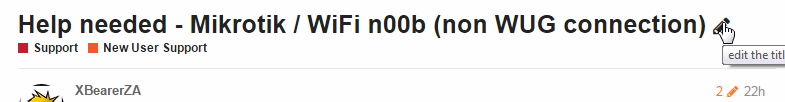

Ask for support in support not in tech discussion.
You can move it yourself.
Click the edit button next to the title
Then change the category.
Would you look at that, nice feature - tx
