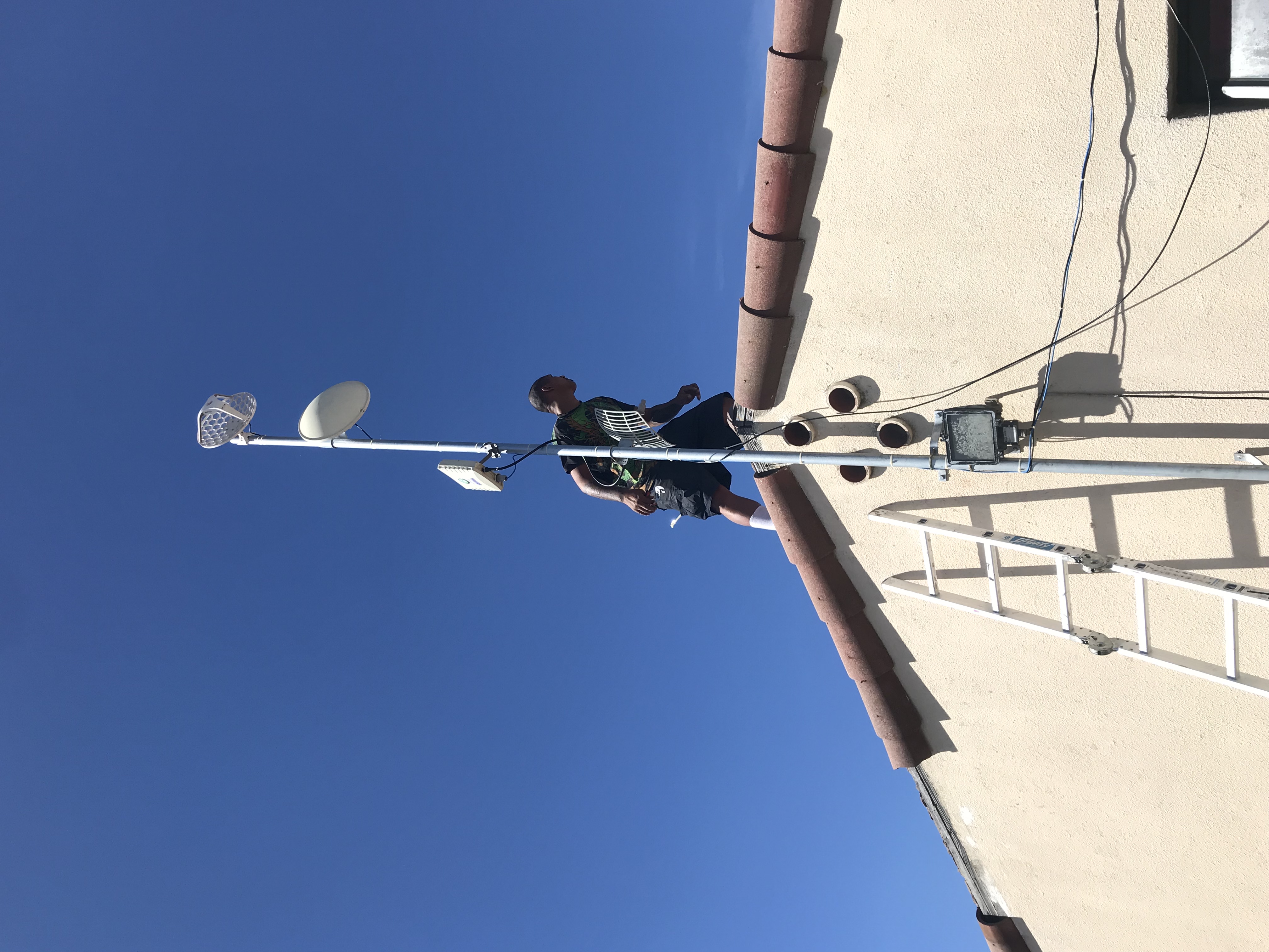

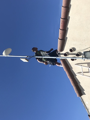

Issue i am now sitting with is Blackheath HS is finally completed but i do not have IP Range for the area and currently area is sitting with 8x clients and growing fast.
My question is what do i do now? If any advice can be given will be helpfull as currently sitting with complete HS with no IP Range
