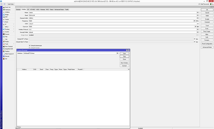

Tried scanning now, can’t see Venus sector 1 anymore…
Seems like I cant ping any clients on the sectors, but it is online, maybe just needs a reboot?

Make scanlist 5700-5800
reboot your rb perhaps.
also perhaps upgrade the ROS its extremely old

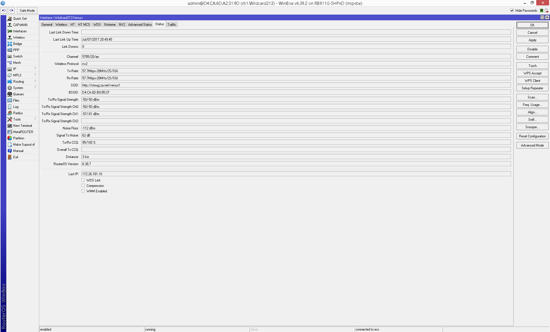

According to the screenshot its on the new version

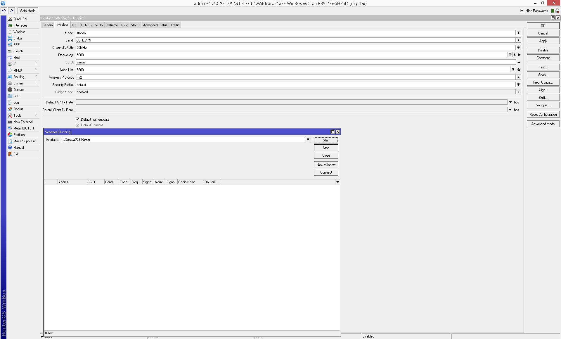

Seems that I am down again and can’t see Venus1 in my scan list again…
Any suggestions as to what I can do on my side ?
Set scanlist on default and see.
Back up again, thanks… seems the channel I was set on was 5600 and Venus1 is set to 5540. My scanlist was set to 5700-5800.
