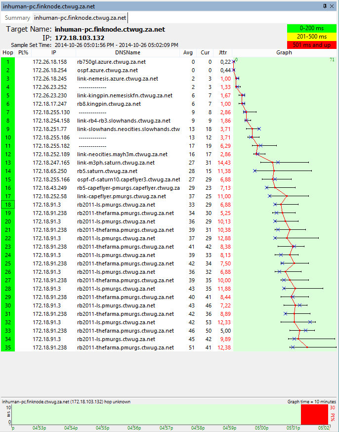

Having the following issue on Pmurgs:
Confirmed by a client in the Deepsouth. The lack of RADIUS on Pmurgs makes this impossible to diagnose from here.

Radius at pmurgs wouldn’t help you. I do have radius, but only on my Mikrotik rbs which connect to the main wug. Remember, the DeepSouth uses Ubiquiti, not Mikrotik for it’s links. We also use static routing for part of the DeepSouth (my part of the DeepSouth) and a custom firmware with ospf for Ubiquiti built by Aragon for his area. The target ip in your trace is in Hout Bay, which means there could be a link failure anywhere between Sun Valley (next to Fish Hoek), Kommetjie or Hout Bay which is preventing you reaching your target ip, and TheFarm where the first device on your route where Aragons ospf resides is reporting it cant reach the target ip, hence the bounce back to my node.

Edit: Checked my emails and got one from Aragon, the one Ubiquiti device at TheFarm is constantly rebooting itself. Will get the owner of the site to reboot it and if that fails, then I guess we have to do a site visit.
Wow… that was a pretty demanding post, being made to a private node…
Reboot has not solved the problem. Suspect the device has failed, so now we need to sort out a replacement with aragons ospf config and install it.
