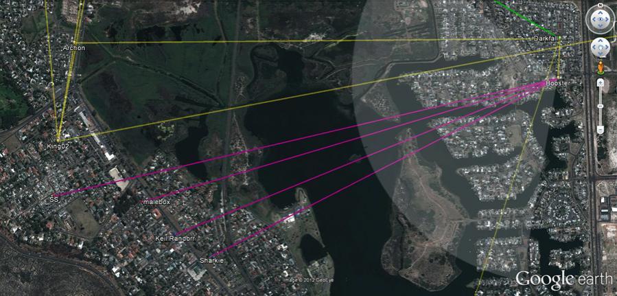

Please use this thread to discuss and plan new links or changes to existing links within the SouthPen Area.
To kick things off here we are going to be installing a 19dBi 120⁰ Dual Polarity Sector at Booster. The sector will provide coverage for users in Lakeside parts of Klein Wassenar and a small portion of Marina da Gama & Muizenberg. The sector is being funded by the clients and as such future clients would be expected to pay their share of the costs if they would like to join.
Once this upgrade is in place we will be removing the Sector at Darkfall to make way for additional backbones.
If anybody else would like to connect to this sector then please let me know as the more people we get to join, the cheaper it becomes for everybody.
Below is an image displaying the planned clients & coverage area.

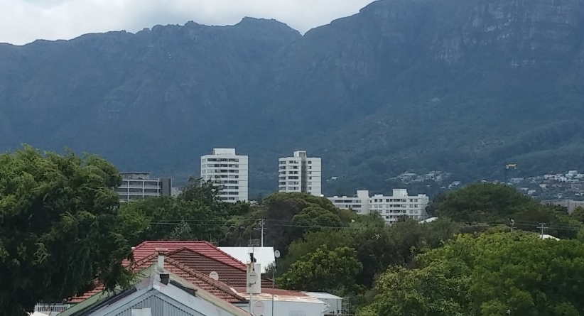

Hey guys, was thinking that we can expand to greater coverage in the Claremont, Harfield, Kenilworth area by adding a new high site.
It could ideally connect to Ariel.
I see there is a lot of unconnected clients in the area.
So if anyone nearby has any thoughts?
Also how would equipment and hardware be determined?
Image:
EDIT: BODY CORPORATE VOTED AGAINST ANY NEW ADDITIONS TO THE TOP OF THE BUILDING.
Do you have permission for us to use that site? If so then we can look at establishing it as a CTWUG HS. We would help you spec it from the ground up, load up a project and go on a fundraising drive.
If not then obtaining permission is the first step and is probably the hardest part of this process. There’s a form that we will need signed by the owners/body corp giving us permission to install kit etc. When you’re ready for this part just pvt me and i’ll help you with the forms etc.
