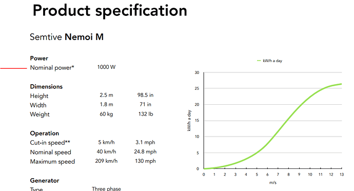

This is the wind speed/power curve:
Cape Town wind is 5 m/s in slower months on average or something like that. So that would generate 5kw/h on an average day.
That combined with a solar panel or two and a Tesla battery and you should be not hearing from Eskom again.

Also need to look at your own power requirements, that is 5 units per 24-hour day, so I would need multiple R61K’s to make it worth it

It’ s 5 kw/h in a day. So a full day of 5 m/s gives you 5 kw/h. 5 kw/h is 1 1000w device running for 5 hours or whatever. Most homes would need more than one.
In summer you’ d do better. Wind’s closer to 7 m/s on average giving you 10kw/h per day.
