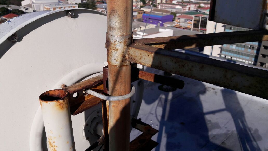

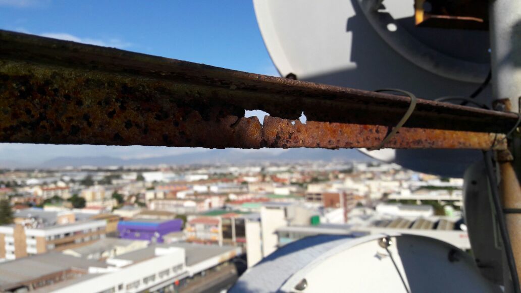

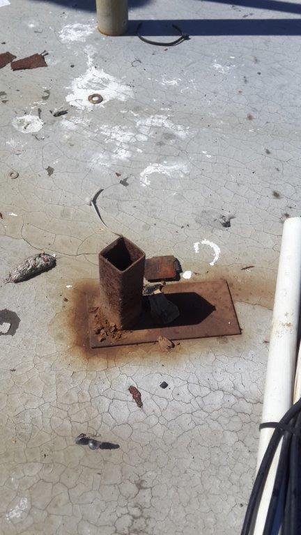

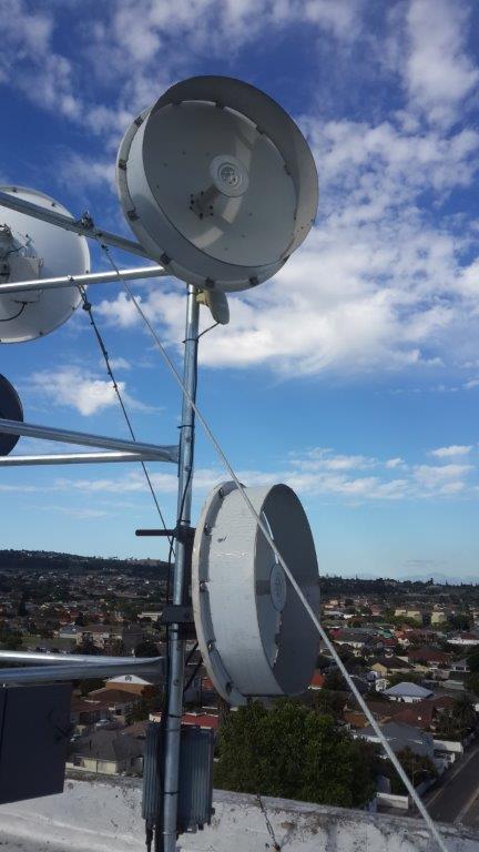

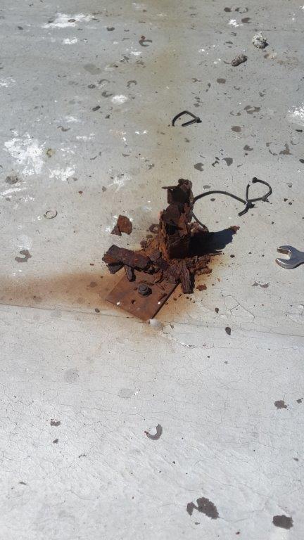

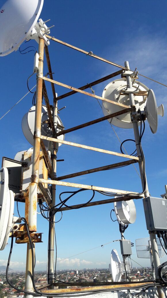

The MARS Mast is in quite a bad state (see pics below), as this is a CTWUG high site, the committee has agreed to replace the mast at a cost of R3000.

out of interest , how current are these photos? whats the specs of the current mast? was it Galvanised? how long has the current mast been inplace?
Im asking these things cause we should look at possibly upgrading/reinforcements , if u know what i mean.
About a month old
Upright poles are 3m long and galv but holes have been drilled through them.
Crossbars are angle iron and rusted badly
The 3 bolts mounting the mast to roof is also rusted.
Age of old mast is 6 to 8 years, this a guess.

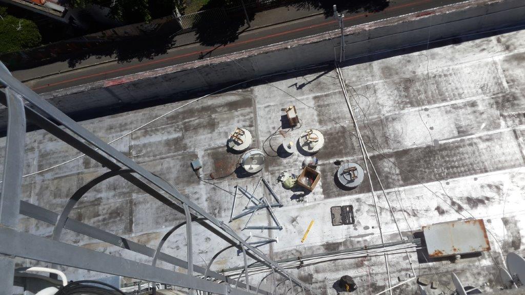

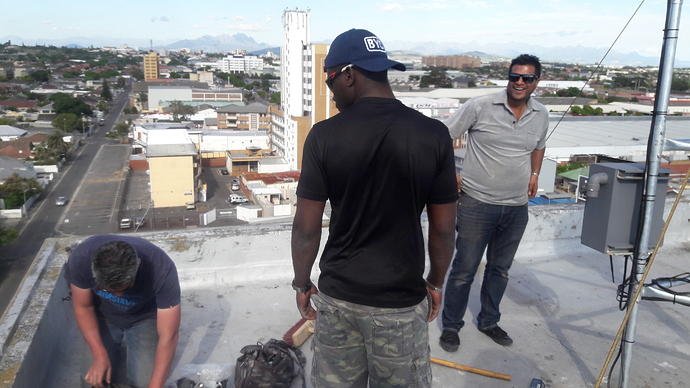

Here are some photos I took while taking a small break in the heat:sweat:
A huge THANK YOU to the guys that came to help today!!

@Ogon - thank you for organising the mast! and your never ending support and effort !!
@Committee - Thank you for funding this, the pics below show that the old one had served it’s time!
Also huge thank you to all who donated towards the upgrade of the Sector RB’s, these were also installed today and are performing MUCH better than the old equipment. Project Page

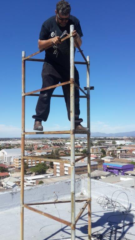

Here are some of the pics, @others, please upload what you took.

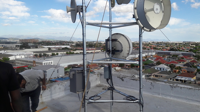

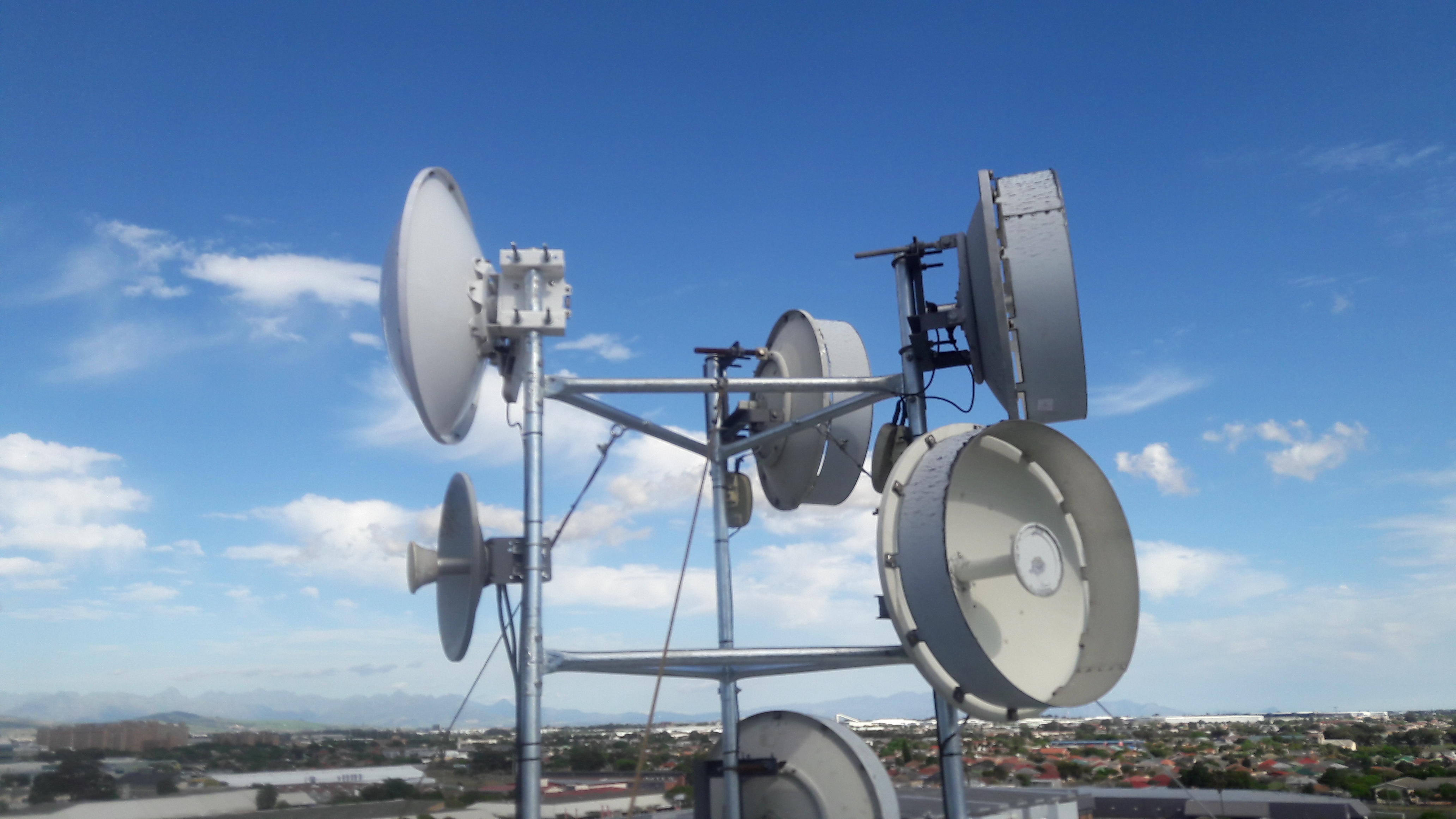

Mars deconstructed
Sectors getting a brain transplant
Die pote is poot uit!

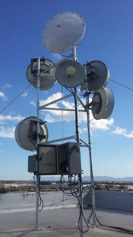

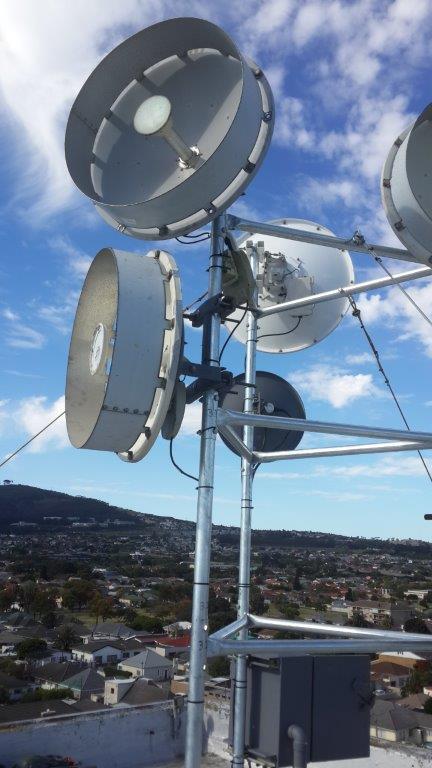

And here she is in all her glory!
3 x 3m 50mm Legs
4 x 38mm tube braces
