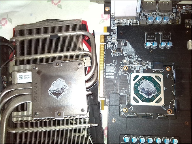

It looks like it’s time to try a fresh layer of thermal paste, like parowdude said.

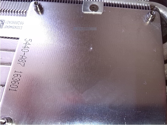

I applied a fresh layer of thermal paste on the GPU chip.

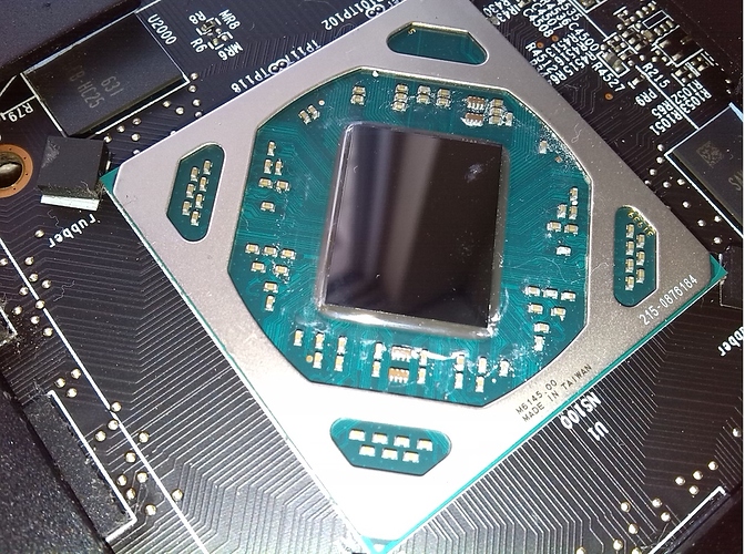

When I took apart the GPU it looked like half the chip didn’t have paste on it.
I noticed a small spot on the chip and heatsink which isopropyl alcohol couldn’t remove.
I ran Heaven Benchmark 5 times with no crashes. Still busy testing.
No more crashes.
Thanks for all the comments and suggestions. They helped me find and solve the problem.
