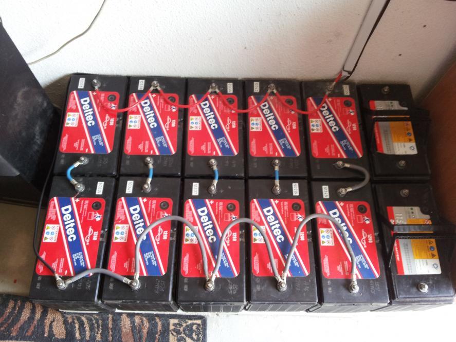

My little project is nearly ready to go live…i have been slowly installing a p.v. solar system in my house and on Monday / Tuesday i will switch my computer room and all wug sectors and links over to free energy. Then it’s still my light circuit to do…
As i can afford to add to it, more panels and batteries for storage. i have 10 x 102ah so far.:wink:

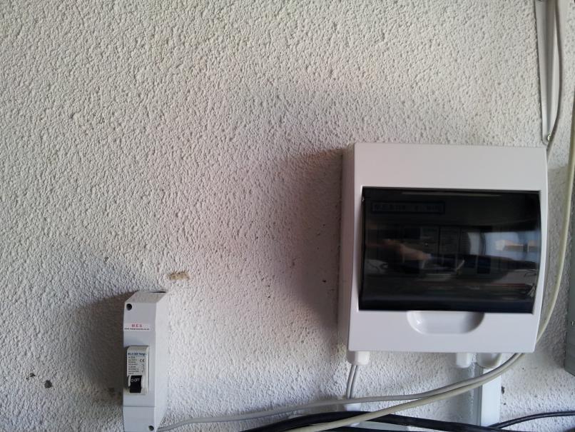

and also a 5.5kva genset for the bad weather days to boost the charge. I will update as i go along. Tomorrow is to reroute cables and fit trunking…

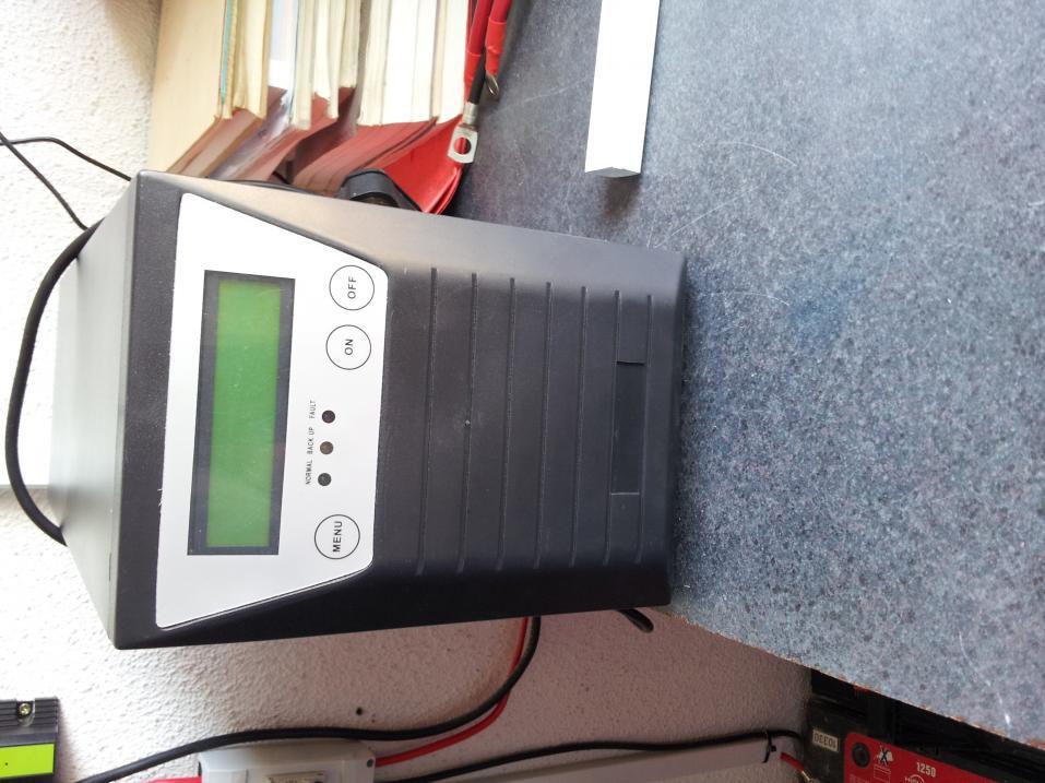

What regulator and inverter are you using?
How many solar panels? How many watts?
24V?

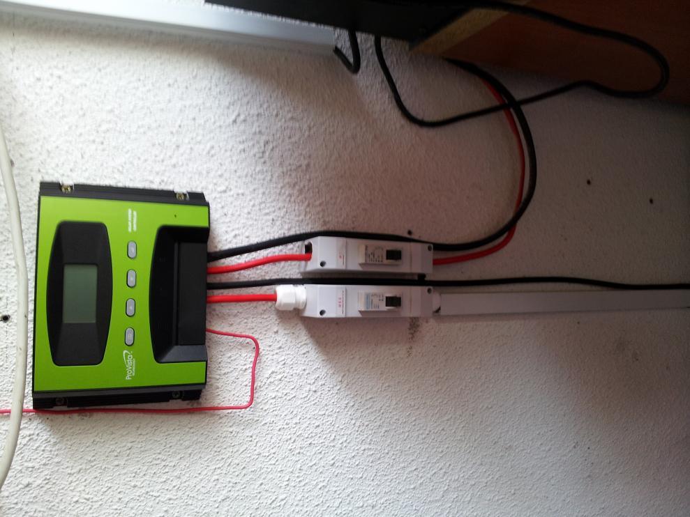

it is a 30A MPPT Load Controller with a 1kw pure sine inverter ( temp…going for a 3kw ), Panels picking up MOnday 2 x 235w Polycrystaline p.v. panels, It’s a 24Volt system. Want to add another 10 batteries and 4 more panels when i can afford them. With 20 batteries i will have 3 days backup for bad weather. At the moment i have 24 480Wh of energy or 1020Ah

Nebular as soon as i am finished i will post a full breakdown of costs. I must say the batteries are the biggest costing to date at R1030 each.

You may want to contact Current Automation to get a second opinion on prices and options. I’ve moved away from the Deltecs and now only use their Royal batteries for high sites.
When it comes to PV cells / panels. Is there really a difference between the expensive German stuff (I’ve got a couple of Solarworld panels) and the new cheap stuff from China?
Portcullis, the Mppt controller is from ManTech. The pv panels, i have been told to steer clear from China Solar and rather go for a quality manufacture. The Solvino panels carry a 20 year gaurrantee, and apparantly the French have the best energy ratio, but i will take a look at Current Automation but have never dealt with them… do i need an account there? I do need to get a 5 or 6kw pure sine shortly and dump my 1kw temp…
what are the Royals like? are they 105ah deep cycles?
The Royals are fantastic.
When I go into server rooms in big companies, all I see are Royals. Lots and lots of Royals. I bought two, two years ago and put them on Simonsberg. As of last night’s voltage report, they were still delivering the same power as when they went in. Two weeks ago there was a huge power failure, at which stage they kept the entire site (4 x RB411AH, 6 x Rockets, 1 x Nanobridge, 1 x RB493AH, 1 x RB750) up from lunch time Saturday, to Sunday 7:00pm when the power was restored. At that point power was down to 12.1V.

Also with your existing solar charger, you might have a problem going with more PV cells, as 470W/24V= 20Amp.
Adding another PV bank would/could overload your controller.
