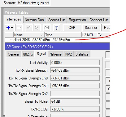

We have replaced the RB on the Rhea-link as the old one was doing funnies. We also replaced the cable, allowing us to extend the pole by another 30-40cm.
The Panel was removed and replaced with a 15dB UBNT sector with the old Rhea-link RB
Another sector was added, pointing towards Badboy
The Stoffel-Grid was removed, with the above sector taking it’s place

I have temporarily disabled OSPF on Nemesis-side of Nemesiskfn-Rhea link, ccq’s are running sub-10%. Once Rhea is properly aligned, OSPF can be enabled again.
