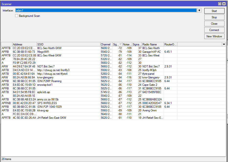

Please do a 360 degree scan & post screenshots containing all nodes with ctwug in the SSID here…
Details as to scan settings to be used: https://wiki.ctwug.za.net/wiki/Scanning_using_Winbox

Ok, so after spending the day up and down from the roof, I have determined that the high site at Callisto also has an AP called “DS”, link to the screenshots of my signal and Wind images at the end.
According to Wind it is an AP…
Also, quite strange is that the Callisto2 SSID I spoke about is now disabled…
I’m assuming that Callisto is also run by the DSTech guys as I know exactly where there offices are and I can see them from my roof, now how do I go about asking for permission to connect?
I am not going to post all the boring screenshots I took today but simply the one with the most acceptable signal, being to DS.
I can’t upload images yet as I’m new to the forum but here are links to images:
Singal test: https://ibb.co/C2gMX2W
Link to Wind image: https://ibb.co/LxZGdDZ
Please let me know? @Wolf @Stiaanm
TIA.
DS (Suppose that would be DS Tech) is actually a service provider, with no affiliation to CTWUG (at least not to my knowledge).
You will have to post the boring screenshots, looking for ctwug in the SID name…

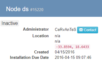

Correct, DSTech are a local IT business, but their node is listed on Wind as an AP:
https://wind.ctwug.za.net/index.php/nodes?node=15220
I will redo the signal test later in the week if I have no luck with them…
It is an inactive node. No point in contacting them.

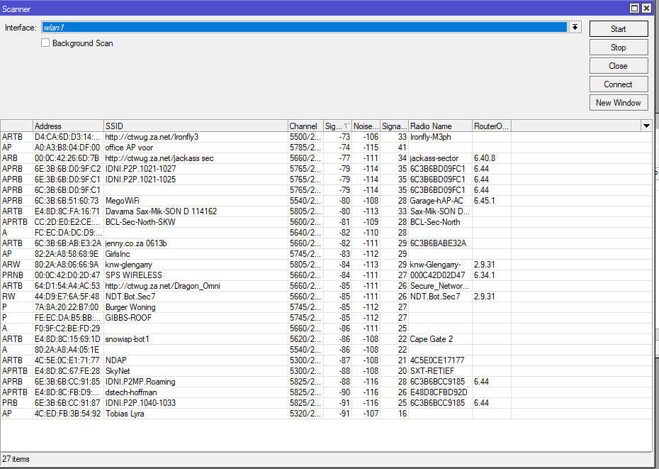

Scan 1
Scan 2
Scan 3
Scan 4
Scan 5
Scan 6
Scan 7

  • DSTech is an ISP, the Hoffman link is a Backbone they use, no affiliation to CTWUG.
  • Ironfly-M3ph is a Backbone, cannot use this one (BB’s are 1 to 1 links).

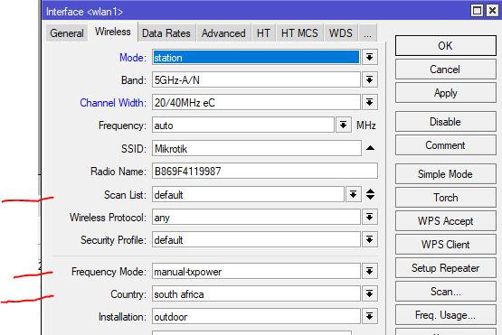

What are the settings on the Wireless interface when doing the scan?
Please post a screenshot of this (in Advanced mode) as per this example
<img src="/uploads/default/original/2X/c/c1a27514f1c8ca967cc6d5d9cd7161aed412d9ec.png" width=504" height=“400”>

Change these settings:
  • Scan list = 4900-6100 (type this in)
  • Frequency mode = Superchannel
  • Country = No_country_set
Once set this way, please redo your scans…
Maybe this would also be helpful: https://wiki.ctwug.za.net/wiki/Scanning_using_Winbox
Hi Stiaan,
Here’s the screenshot in the current direction it’s facing (7 on the map), the rest I’ll do tomorrow or in the week (positions 1-6): The Aquarat-Pot wasn’t available in my previous scans, I guess I should have checked the settings beforehand.
