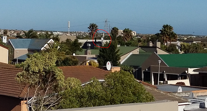

I will check this afternoon to see if I can spot the pole from from my place. Then I will proceed to book the test kit and do a scan.
Cool . Take some 360 degree high res photos when you are on your roof and add them at the bottom of your node page while you are at it.
You can have a look on my node page if you can see your house. But best to get on your roof and take some pics.

We should be good this weekend - you can see the sector clearly from your house:

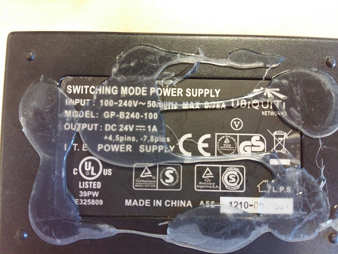

Also when you have a chance come drop off the Power Supply :wink:
Hi Ray
I will drop the PSU this evening in your letter box between 5pm and 6pm.

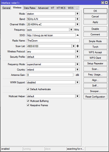

Kindly see my attached test results. Unfortunately, I could not pick up Ray’s node on the scan. Could of be off not sure. However, I can see Venus.
Please advise me on how to move forward.
Kind Regards
Mario
Hi everyone
Checking scans i dont see ray on it
@ray dis use pm mario the settings for the sector cause atleast he had to pick it up but nothing shows on scans ?
Or is sector not working ?
daai scan list is ook nie reg nie set dit op 4900-6000 en frequency mode op super channel dan sal dit meer goed op tel adjust it according to this picture below and click apply then scan again don’t worry to set Radio Name and SSID
