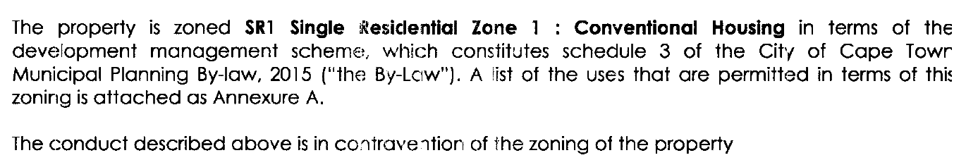

The freq issue is a load of bull yes, but did focus COCT’s attention on my tower, prompting the investigation. According to the paperwork, I am breaching building regulations, and am not willing to put up court battles and fines as per below:

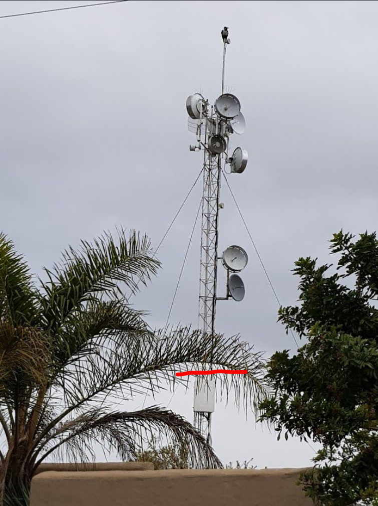

Based on what I have read (unless somebody can point me to a different solution), my tower will reduce in size dramatically due to me staying in a flat-roofed house lower than any of my neighbours, to be cut at the red mark:
What issue did they raise? As long as you don’t exceed the 15m length mark then you should be fine? Although, I think that is from the ground up, so technically you should be able to just move your mast to the ground instead of it being mounted on your roof.

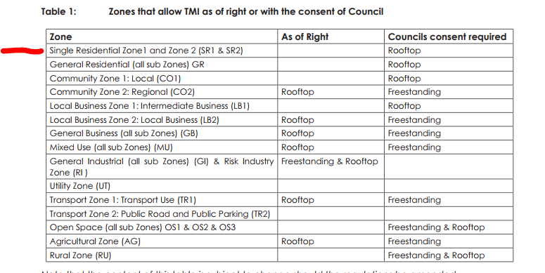

From what I get: COCT by-law, free-standing not allowed in residential zoning, rooftop max 3 meters from highest point
That doesn’t sound correct, can you forward me the documentation? Some municipalities are trying to scew the rules quite a lot.

If you can forward me those for COCT I’ll appreciate it. Another excerpt from that doc:

May be a line to pursue, will have a chat with them to see what is possible. What does contradict that from the same document is this:
