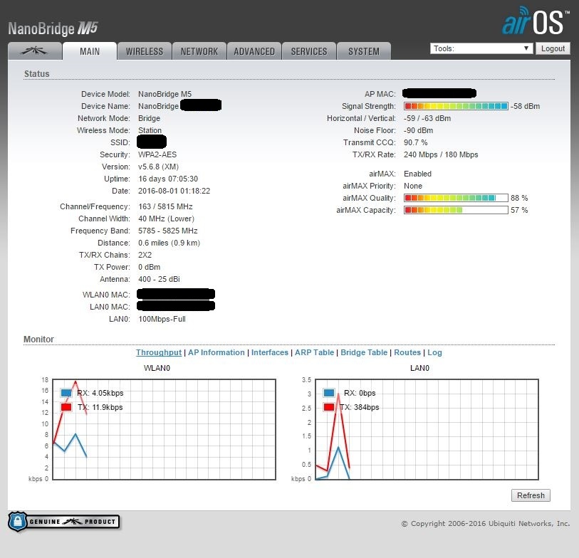

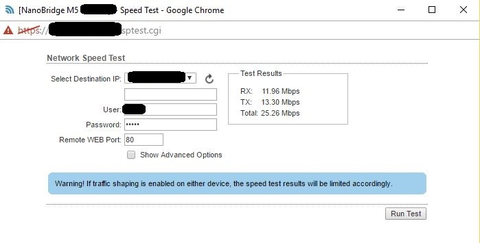

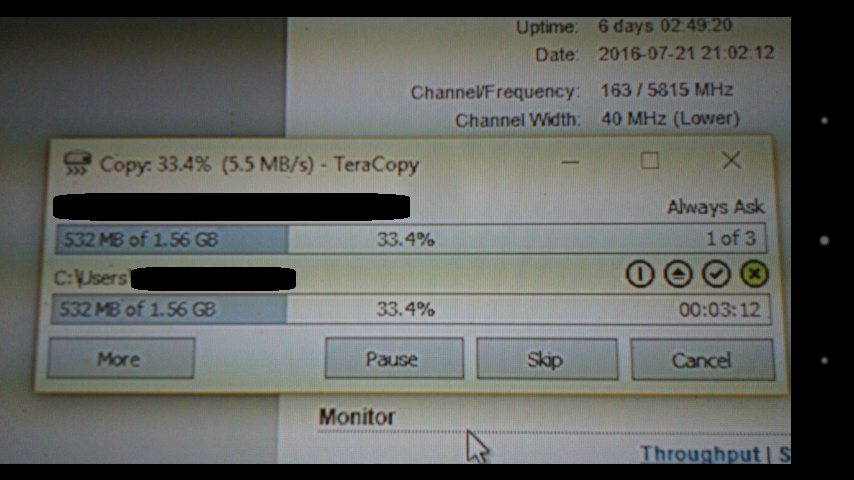

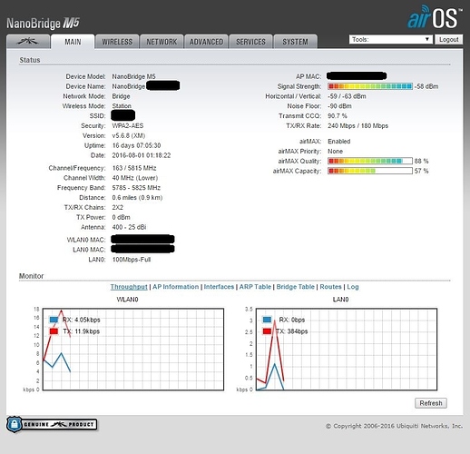

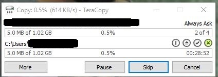

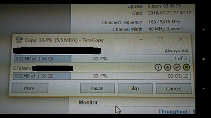

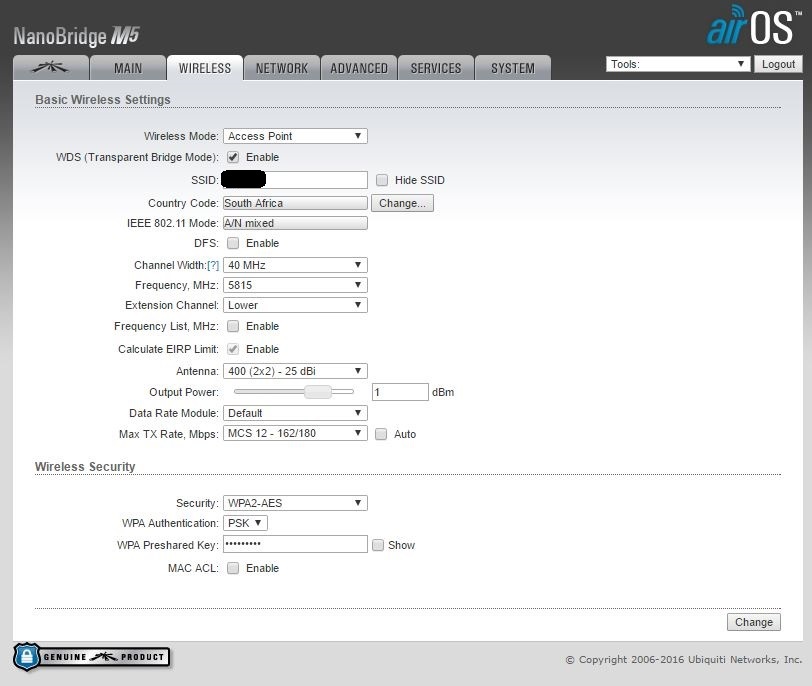

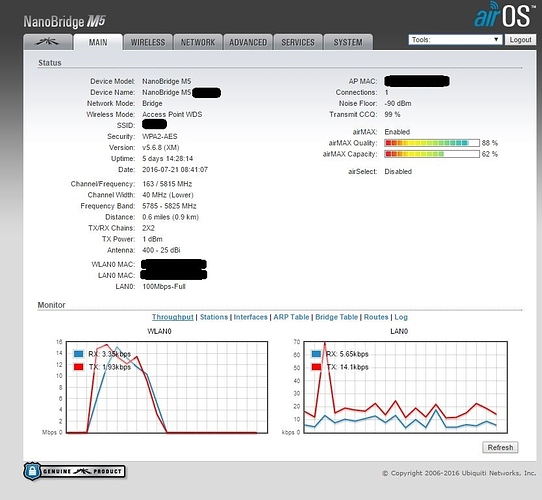

I hope that i’m allowed to post this here, I recently purchased 2 Nanobrigdes M5, they are setup 950m apart.
The connection speed between these two units is terrible and i cant seem to figure out why. I previously had SXT’s which was going good for the last 5 yrs but a month ago one unit failed (From the first SXT units made, ram chip near the door got wet). Thats when i purchased the nanobridges.
Im thinking of rewiring the LAN cables to the units.
Both running the latest Firmware
Aligned a few times and adjusted power to get V and H closer to -50dbm
Tested with airmax off and on
Did Airview and selected the least busy freq
Tried different channel width

You can try the following to see how it affects your throughput.
  1. Remove encryption from the link.
  2. Lower the MAX TX rate, so that the data rates don’t hop around.
  3. Also make sure you have the latest firmware, as they have made a lot of improvements over the past few months even with just the N kit.

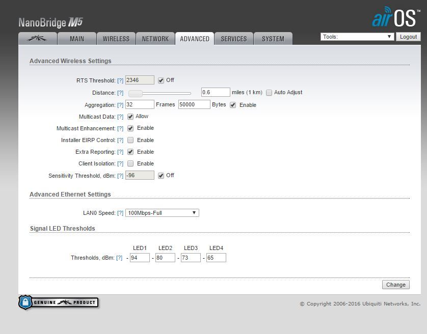

Problem sorted, thanks alot gents.

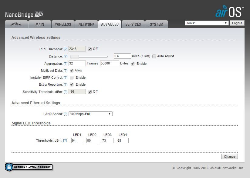

LAN: 100mbs-Full
Switched it to auto…speeds increased dramatically :slight_smile:
