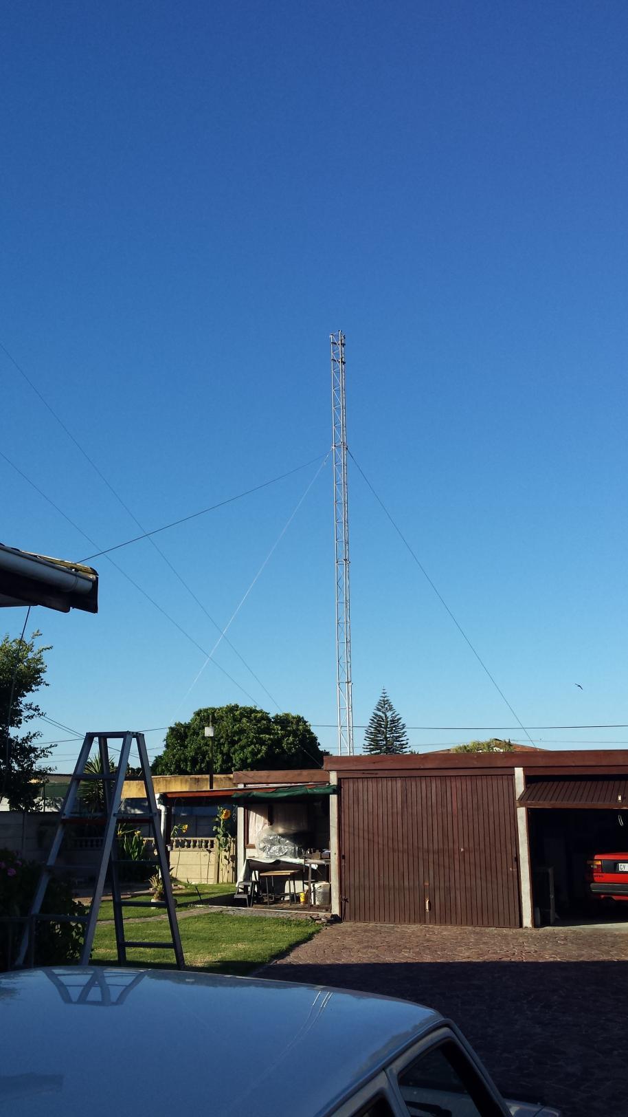

Its still standing :hail: I want to say thanks to Sandman for all the help and support with the tower and thanks azure, deathnote and nuclear for the help lifting it up. Nightsight and tubby thanks for the help the other day. lol I almost forget about Johan thanks for all the support with the beers :wink: thanks stiaanm for offering to help and want to supply stays for temp use
Nice job guys . . .:grouphug: :cheer::cheer:Well done, reach for the stars boyz . . . Razor , nou kan jy nog beter sniper vanaf daai hoogte ;). . . how much did the project work out in total ?

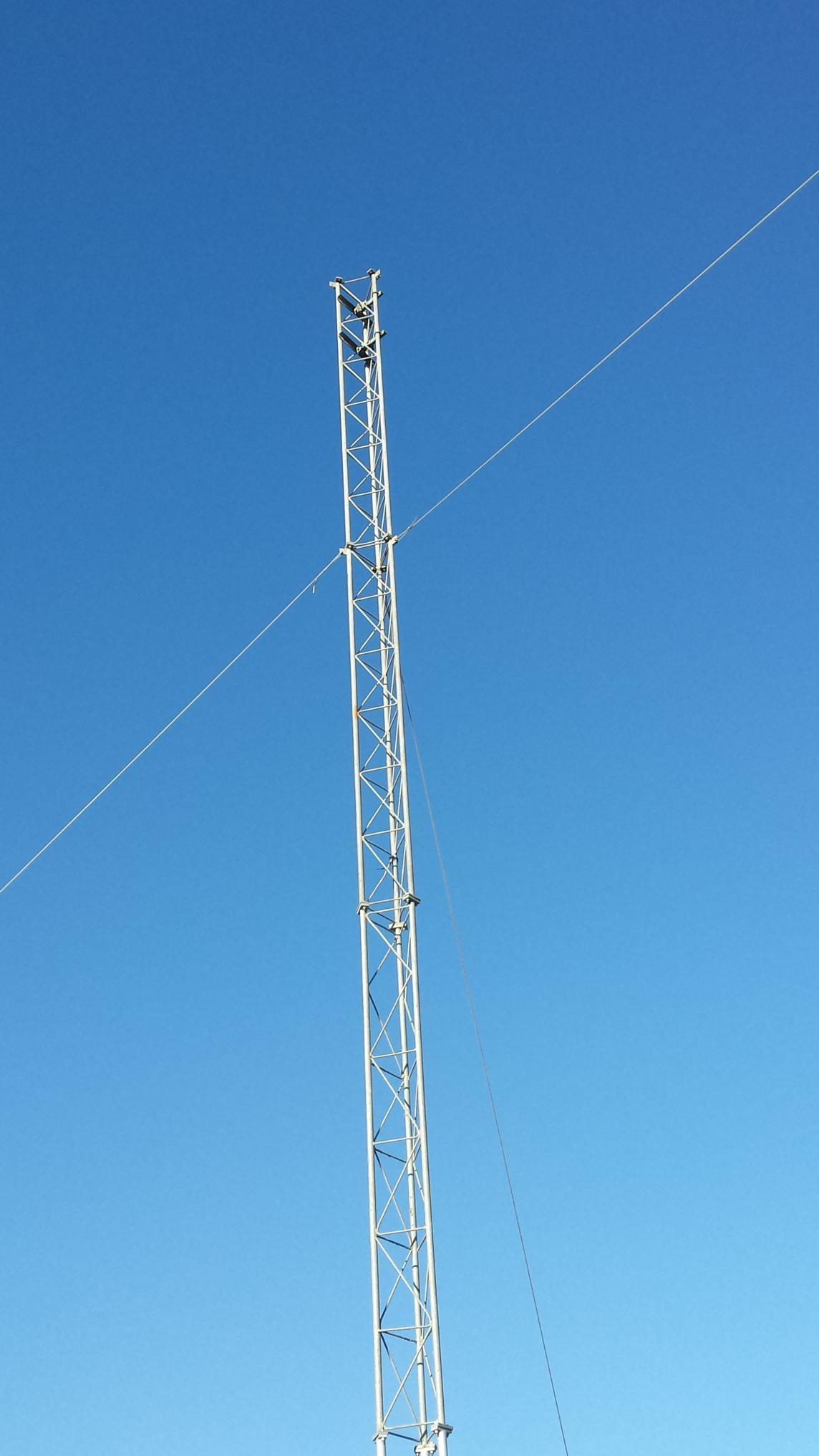

ok guys stay wires are up!
thanks Razor!
Just in time. This wind is hectic.
Awesome Sandman. No beer bottles this time?
Looking awesome! What thickness stay wires? :slight_smile:
thats some thick cable

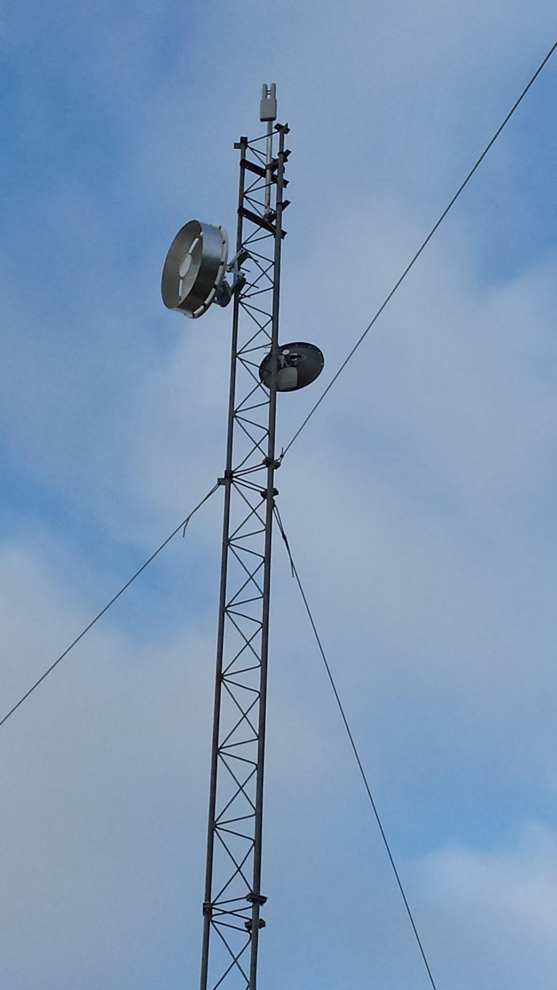

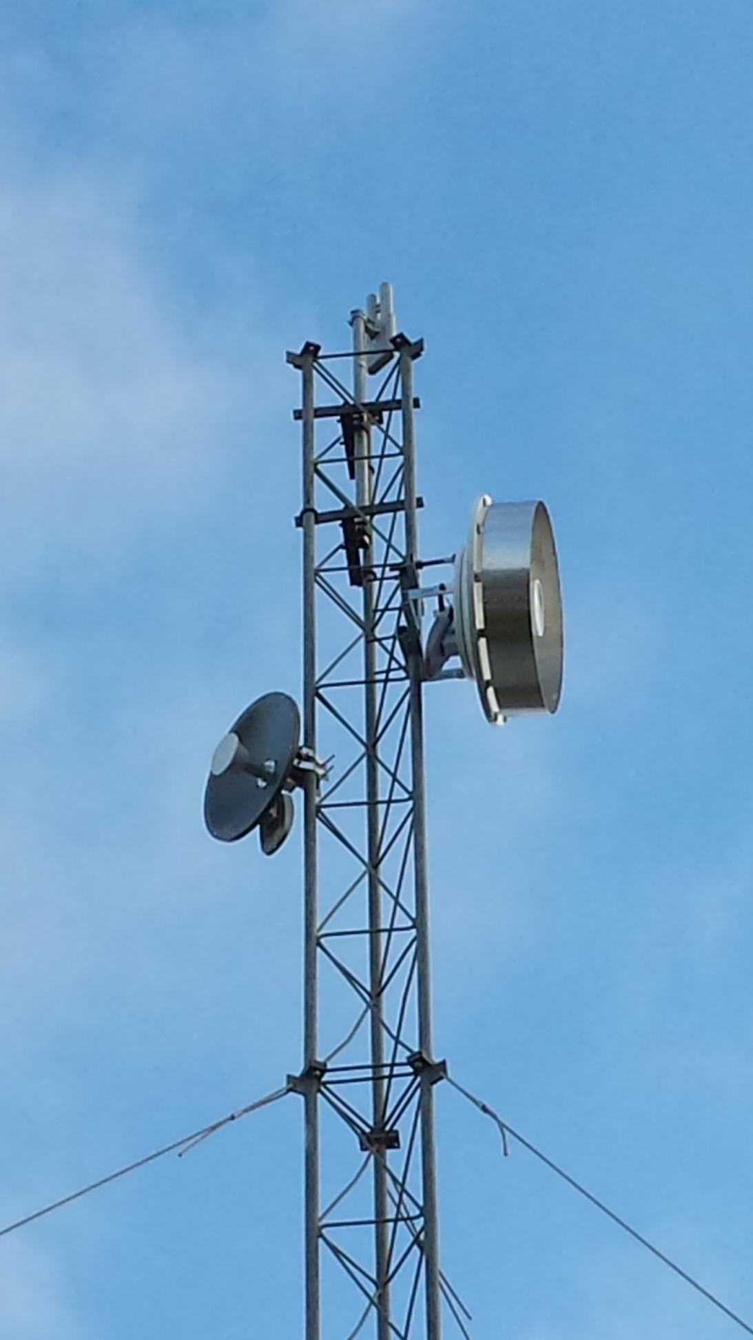

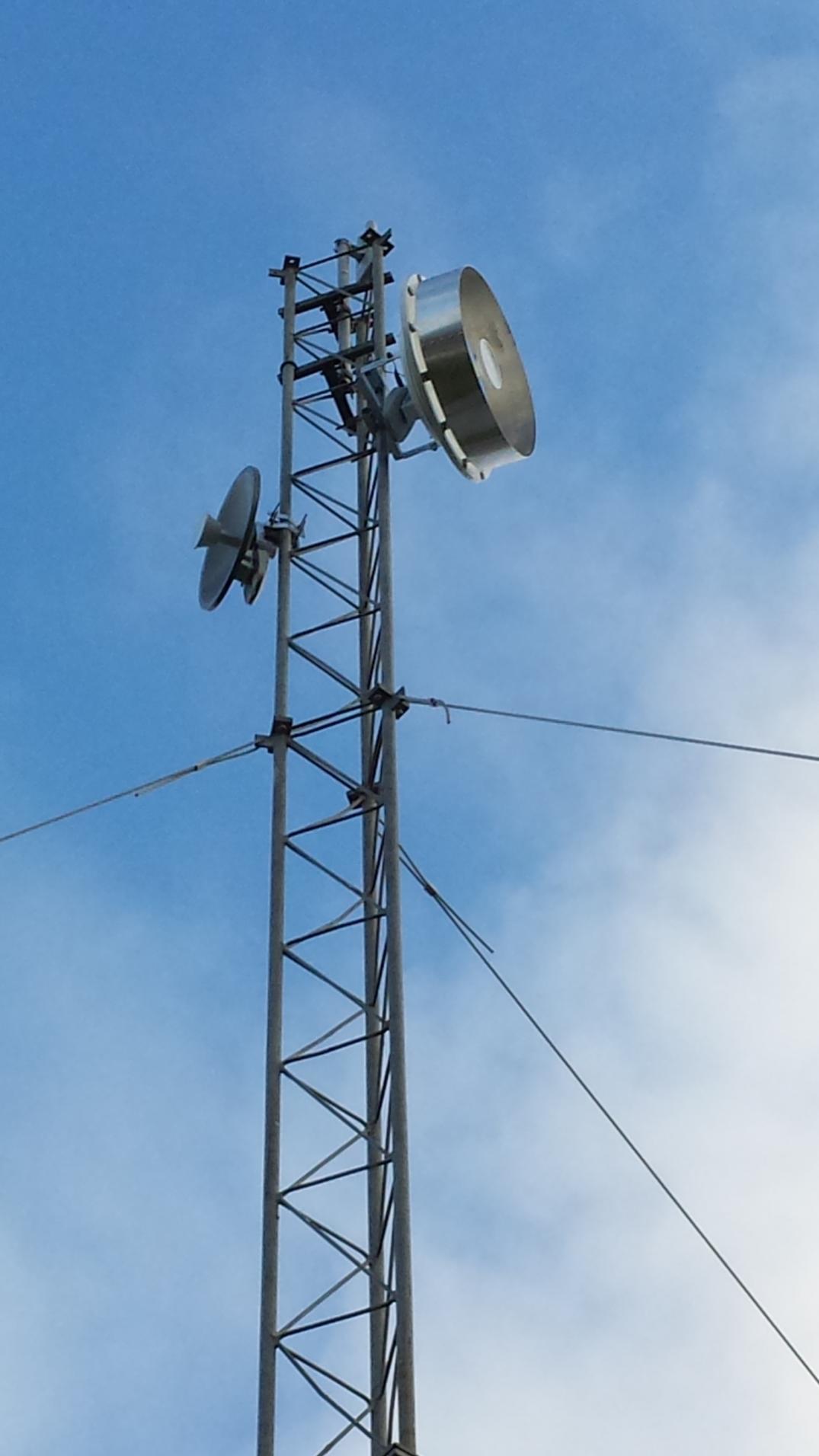

so we started to put up the links today.
:bounce:

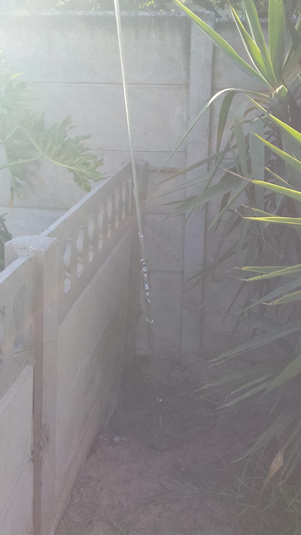

What on Earth is that one staywire connected to in the third picture?
Razor ek dink ek kan jou scan nou op dai hoogte
nothing on THIS earth…lol
