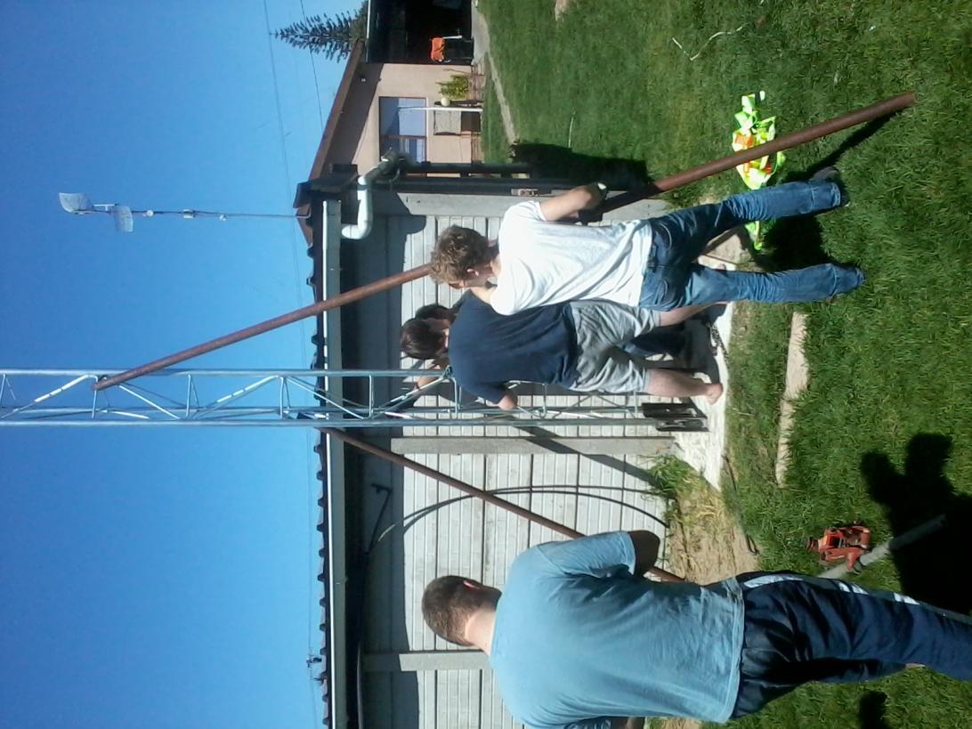

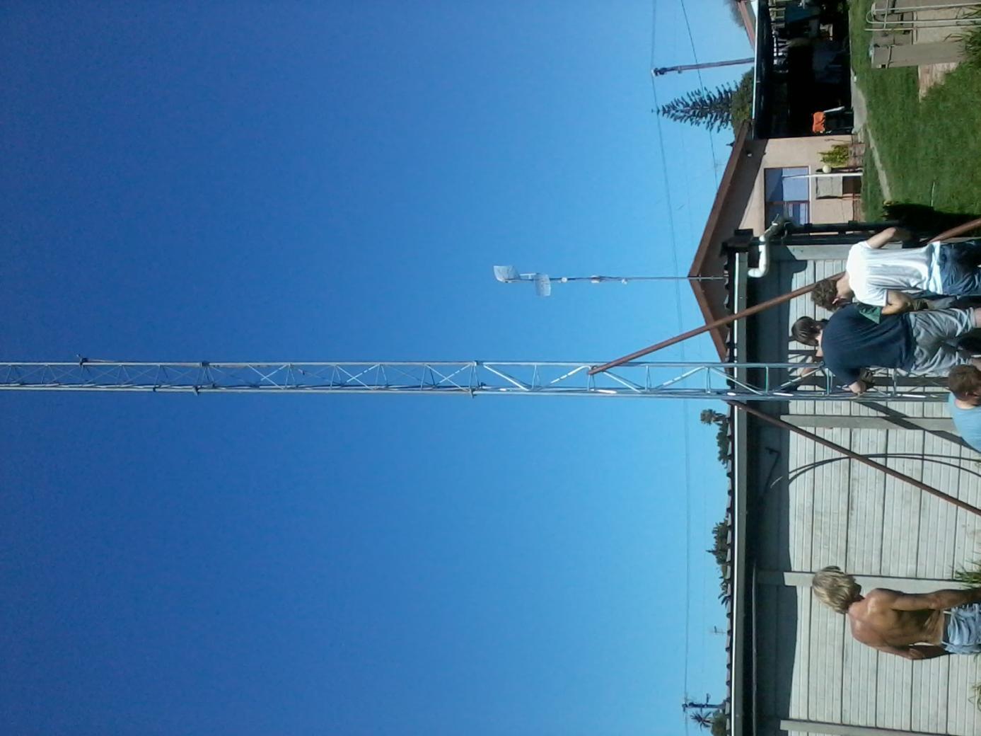

Thanks to Tubby, Johan, Lynton and Razor…Almost there!
Thanks guys for all the help and all the empty beer bottles :stuck_out_tongue:
Possibly the first time ever there were too many people wanting to help :stuck_out_tongue:
lol that was Johan Fault.
Well done guys

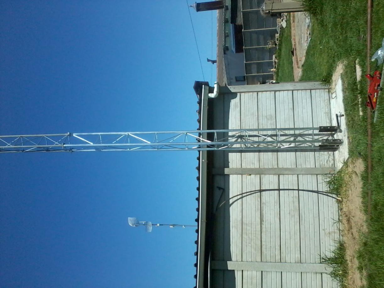

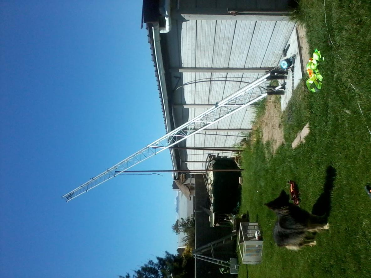

Ok tower up and rug af!!
Woot! We got it up! :smiley:
Possibly you are 100% wrong :stuck_out_tongue: but well done guys, dit lyk goed.
Ek sal laaik van so tower, is julle rooi ligte al op daar bo want daai tower lyk vir my baie hoog.
Wow, very impressive!!!
Any issues regarding local authorities and neighbours?

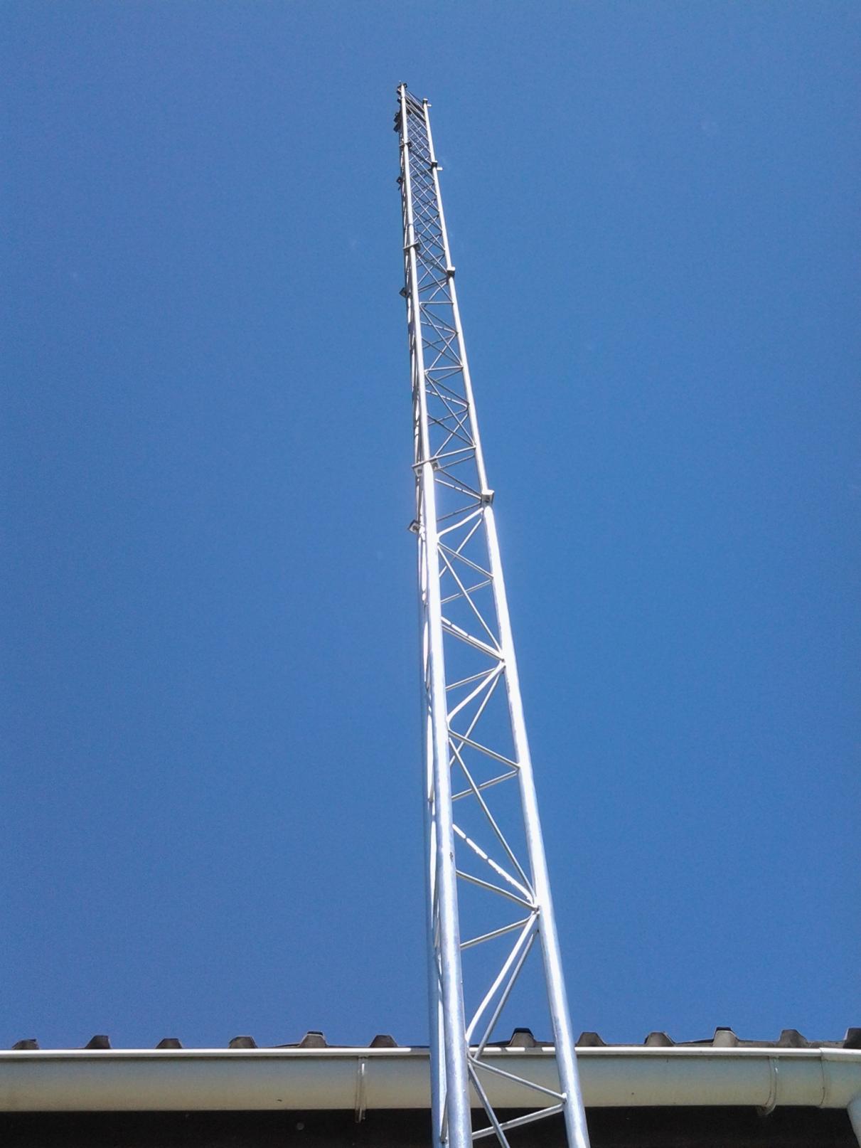

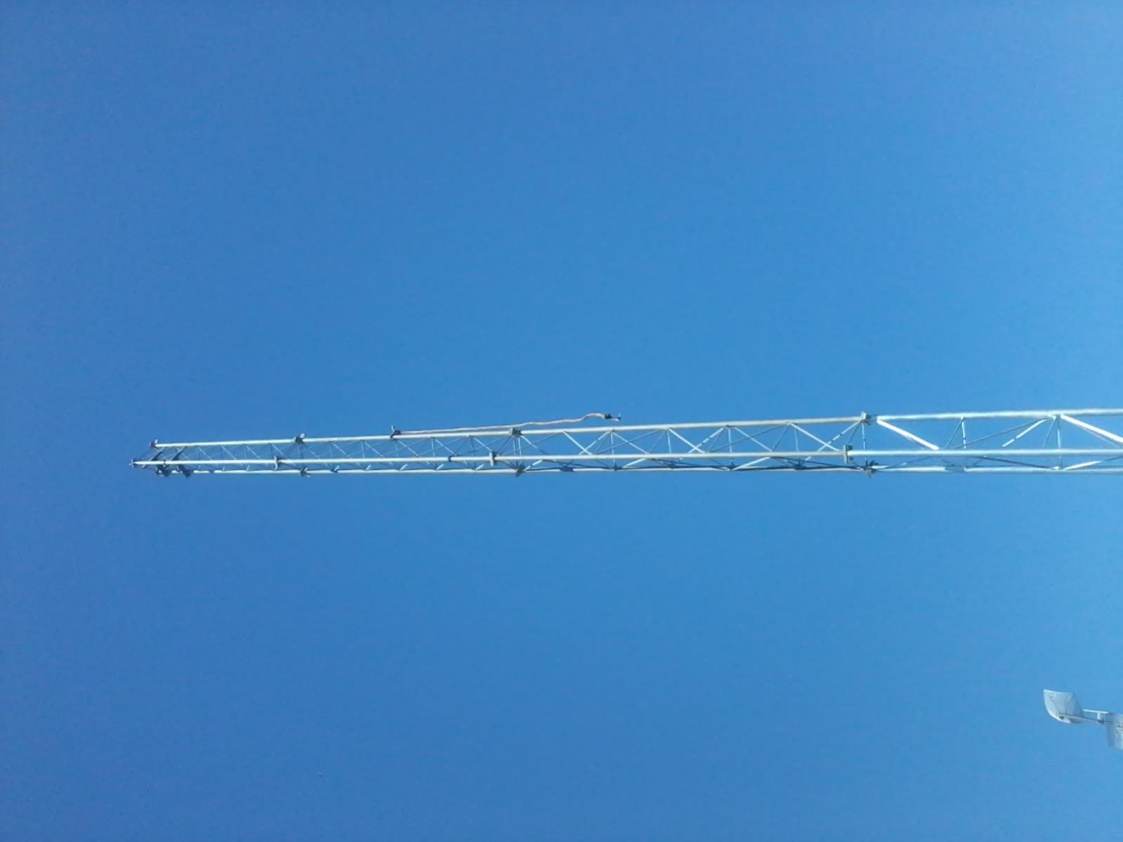

What is the length of the tower?
That tower looks like a 16m to me… maybe an 18?

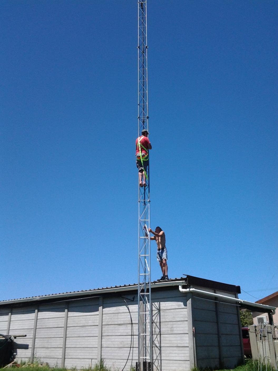

The lack of stays concerns me after the prometheus incident last week…
true! stay wires! get stay wires please!!!

dink hy is 12meter 3X4meters
Hi Guys
The tower is 14.5 meters high, neighbours are razors problem…lol:p
As i understand no higher than 15meters in kraaifontein area.

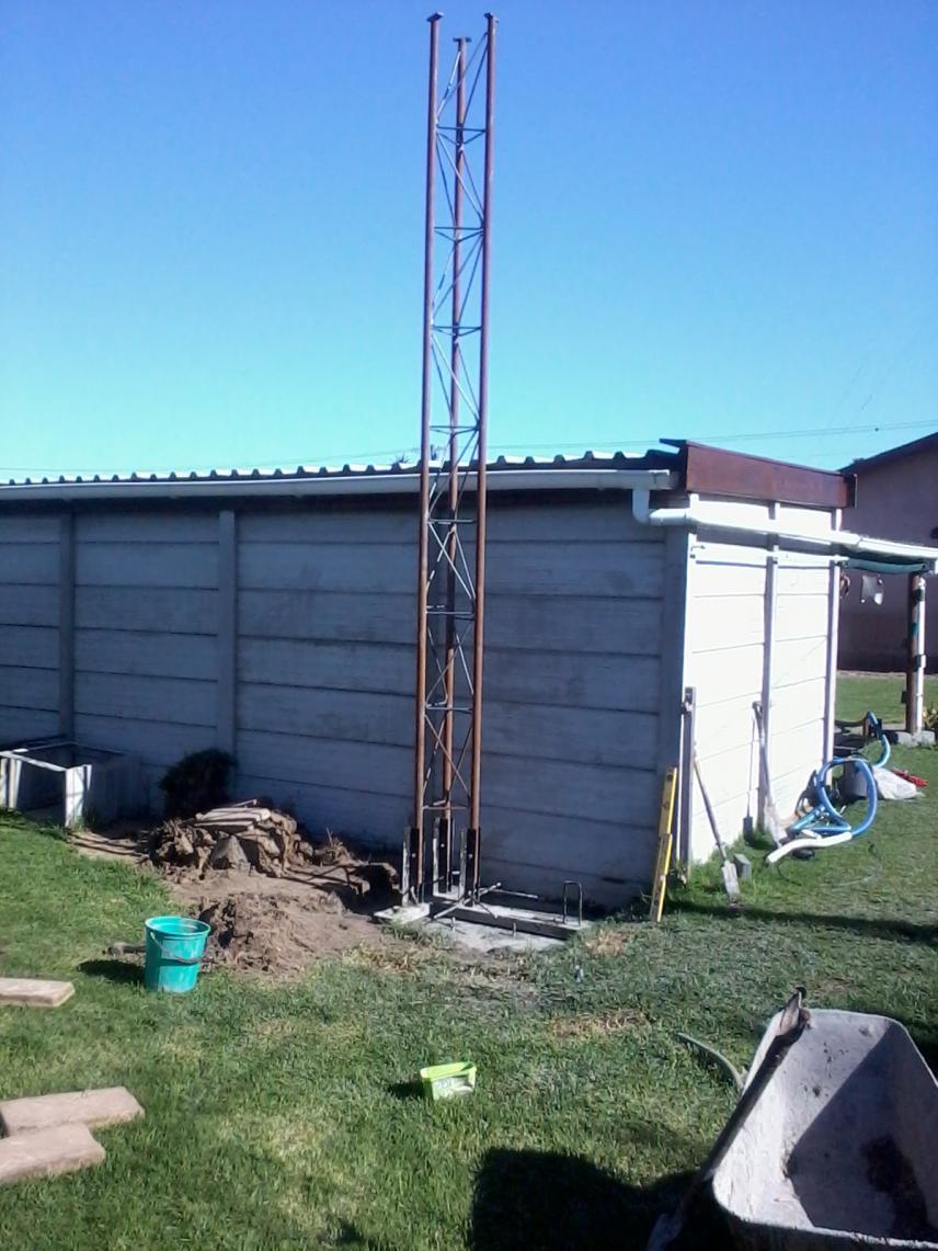

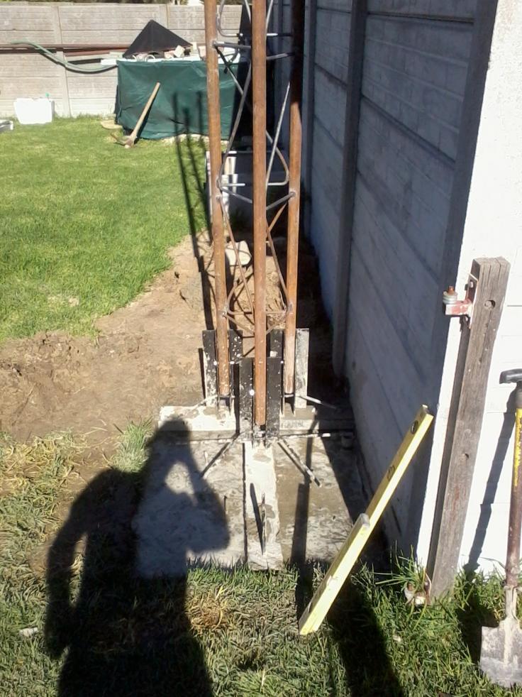

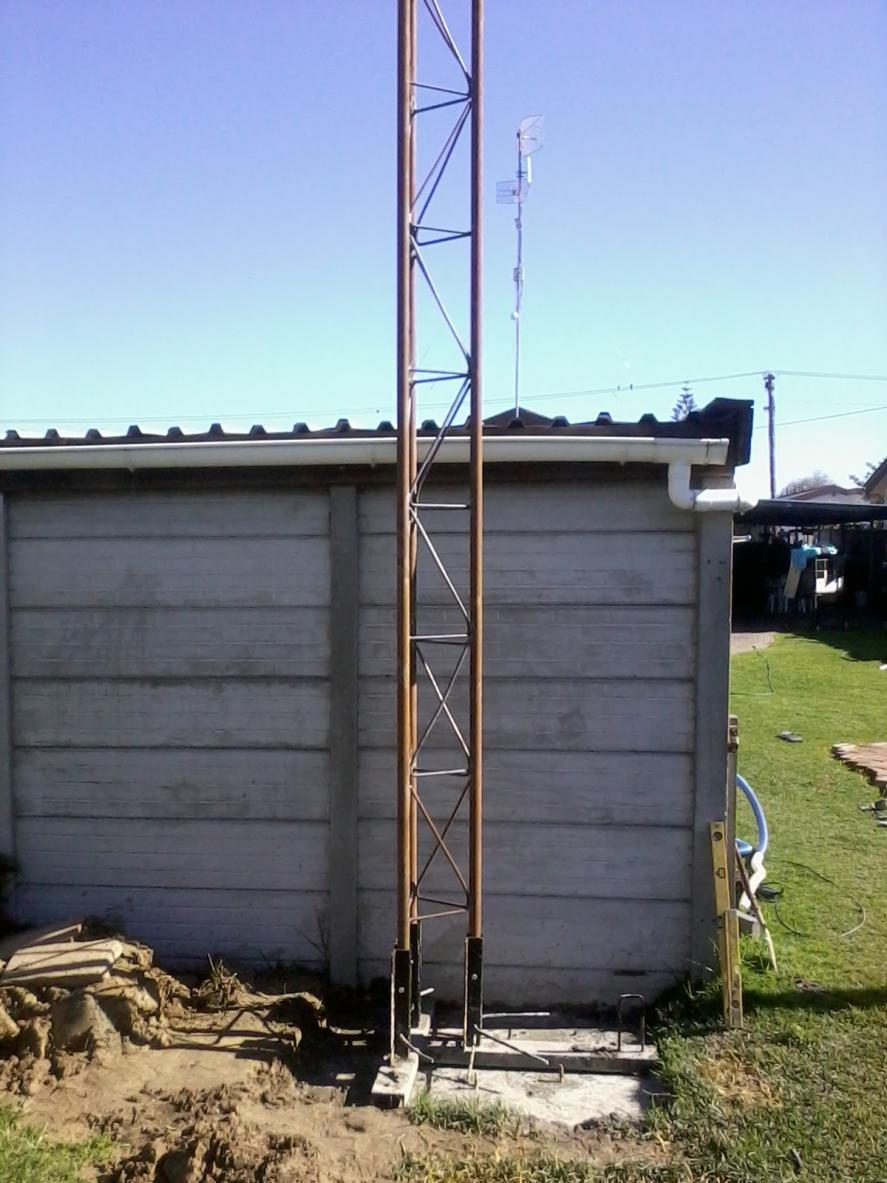

Yes we are busy with the stay wires, but the tower design has been inproved from the specs we got of the forum. We used 3mm poles instead of 2mm, 3 bolts per leg to secure it to the bass thats a total of 9 bolts, the concrete is 1meter in lenght 900 in width and 450 deep with a 2 part bass in the concrete. The arms that the legs bolt onto has been inproved with exstra steel and rond bar.
But as i can see with prometheus there where only a couple of short bolts holding it down in the concrete.
