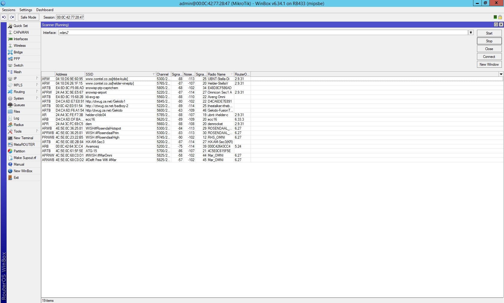

I am having a problem with a rb433. Here the problem. I have setup 2 rb433’s now and they seem to only pickup my rb’s & maybe one other signal close to me. I do however pickup wisp signals but no other ctwug connections. I have tried different grids, different lmr cables, different R52hn cards, another network cable, 2 different pigtails and now even new power supplies and poe injectors. The grids are even facing different direction but i still only pickup my links. Only thing i am thinking maybe could be wrong is the lmr cable to pigtail not tight enough. i only hand tightened it. Anybody that can maybe give some advise.

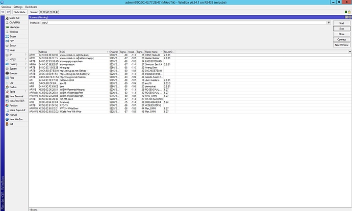

Stiaanm. Simlar results. Only finding links either connected to me, pointing to me or passing by me. Nothing else.

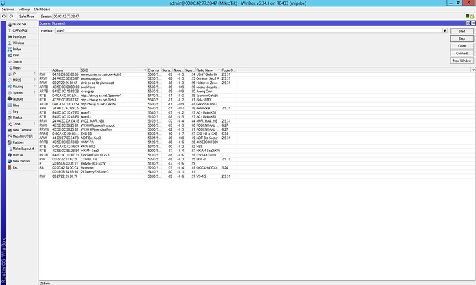

Looking at the scan I noticed two things
  1. You are picking up your own backbone link at 62 this should be between 30 and 50 in most cases
  2. Not a lot of ssid
    a. seems you polarity could an issue(as pilgrim stated)
    b. lmr or pigtails are the problem

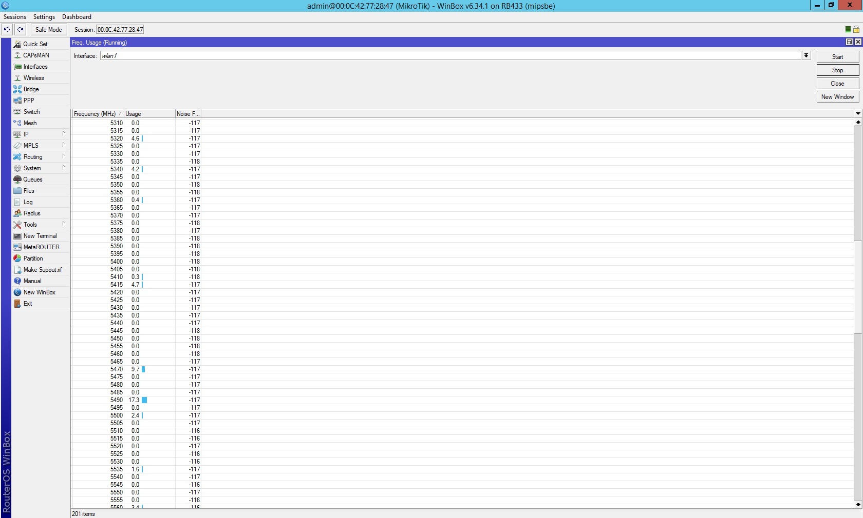

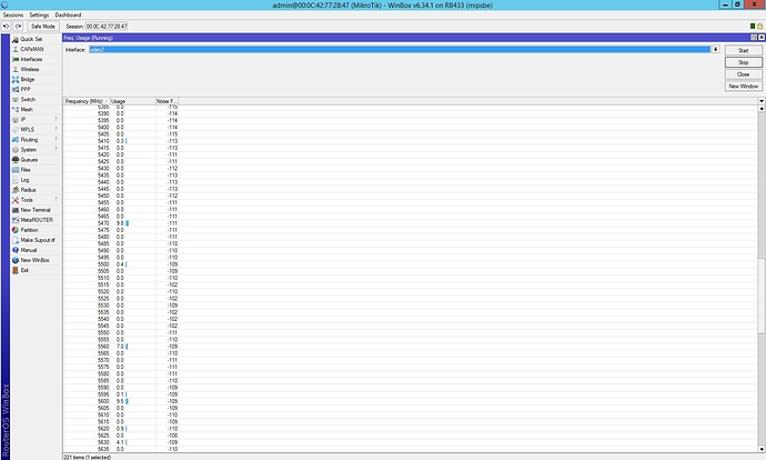

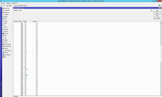

Test lmr and pigtail by doing a freq scan if you mostly see 0.0 it could that you cables are the problem send a pic aswell
feed should be alingend as follow (((((!))))) and not like this (((((–)))))

Here you go Ogon. Does it mean new Cables then?

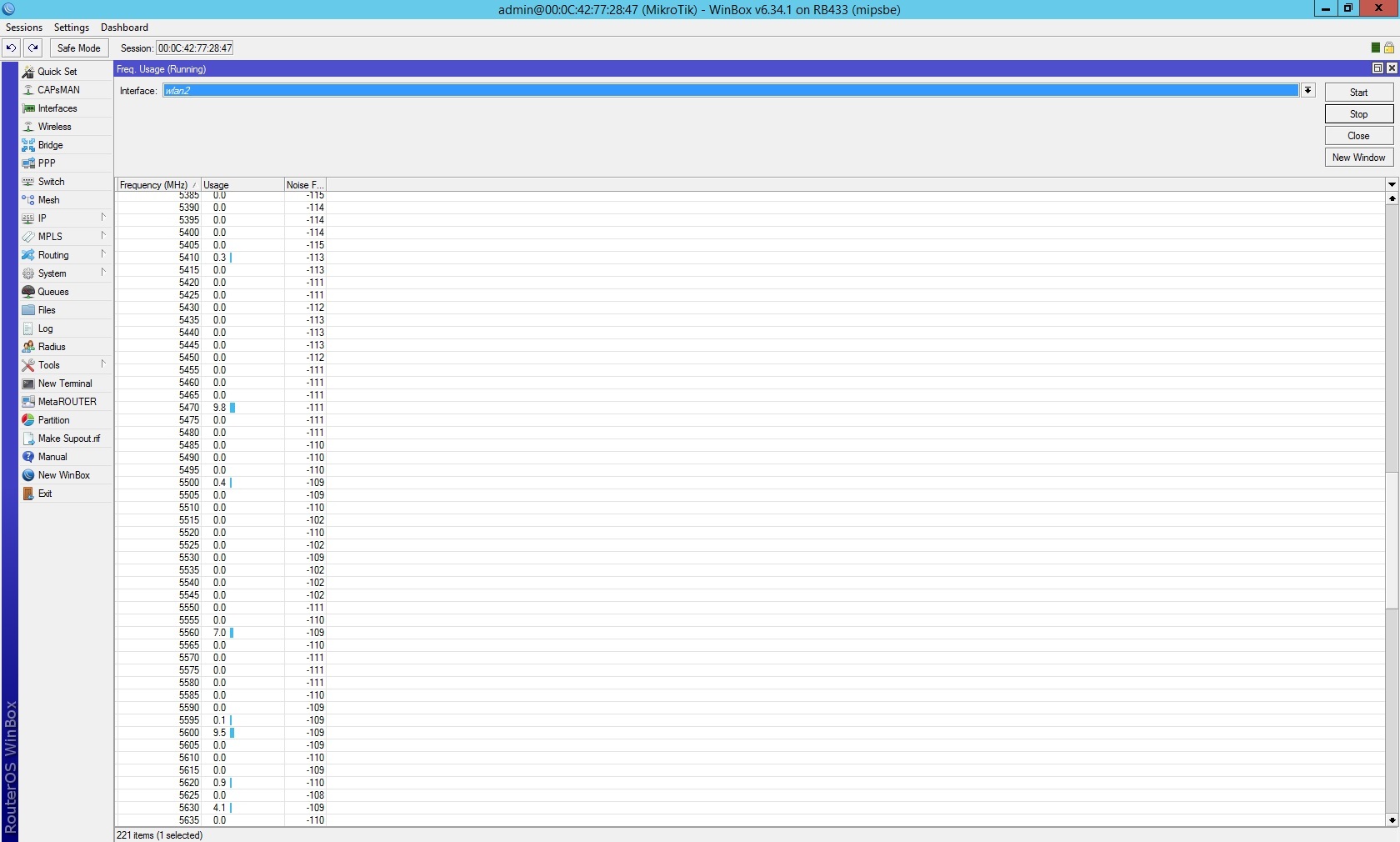

Looking at the frequency usage it looks like it could be lmr or pigtail or maybe your area is just not wifi active
Will sort out that 5600 link Ogon. Will give these lmr cable a go. Like i said when i use a groove it works. pickup allot of people, when i use the rb433 no joy.
