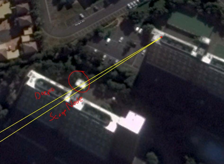

Hi all,
Pics are here
username and password: ctwug
I can clearly see ScoopNode’s wall facing me and looks like [URL=“http://wind.ctwug.za.net/?page=nodes&node=11751”]Doepa ’s Grid.

Why Doepa/ScoopNode can’t get to IO
If I am correct, that is definitely ScoopNode. Skoups will just have to confirm, but it looks very positive
