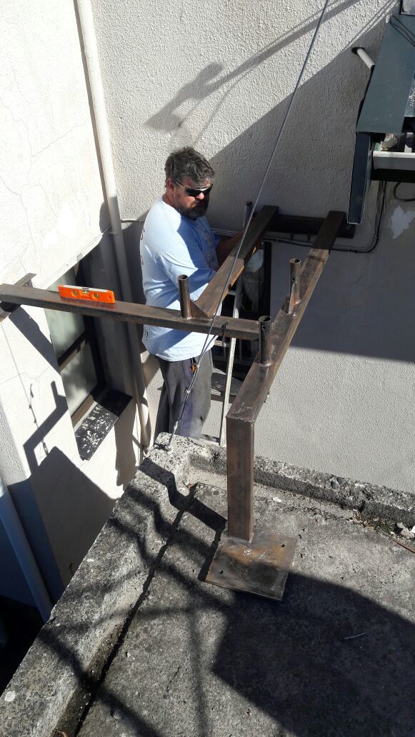

Went to test fit the base bracket today, will send for galvanising next week
