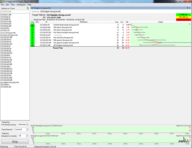

There is a serious problem with Saturn. Graphire has tried to look into it however there seems to be no Radius Login. Some of the Rb’s don’t even respond. Sector speed have dropped to below 150 kbit/s.
