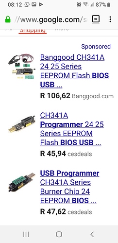

I searched a bit . . . And found that the usb bios programmers are actually not that expensive . . .
