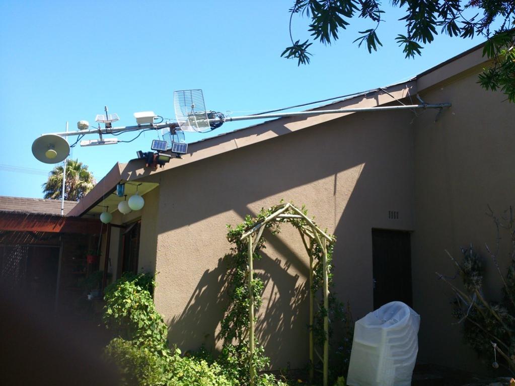

Unfortunately during maintenance at my node the bracket and bolts finally gave in and the entire setup is now sitting on the roof. This means that the sneaki node will be down for a few days till I can get it fixed.
Many apologies…

As for damage, well bracket is screwed, lan cables a bit sliced but gear looks good and no dishes, grids or sxts were damaged. Unfortunately I have to rely on other people and my own funding so I will try to get things back to normal order as soon as possible.

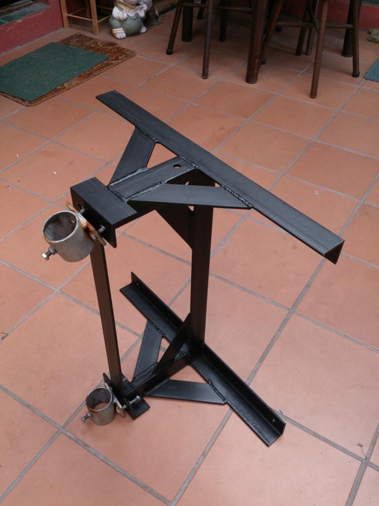

Some good news, a custom bracket was welded finish on Friday and currently going through painting phases to prevent rust from occurring.

I finished the second coat of paint on the bracket and will be doing the final coat today.
Hence tomorrow we will be putting up the bracket, and getting the mast attached to the bracket. I might need help with this so if you want to aid then please pop me a mail or sms. If time permits I will also do the stay wires tomorrow, the mast will not be permanently upright until the stay wires are done.

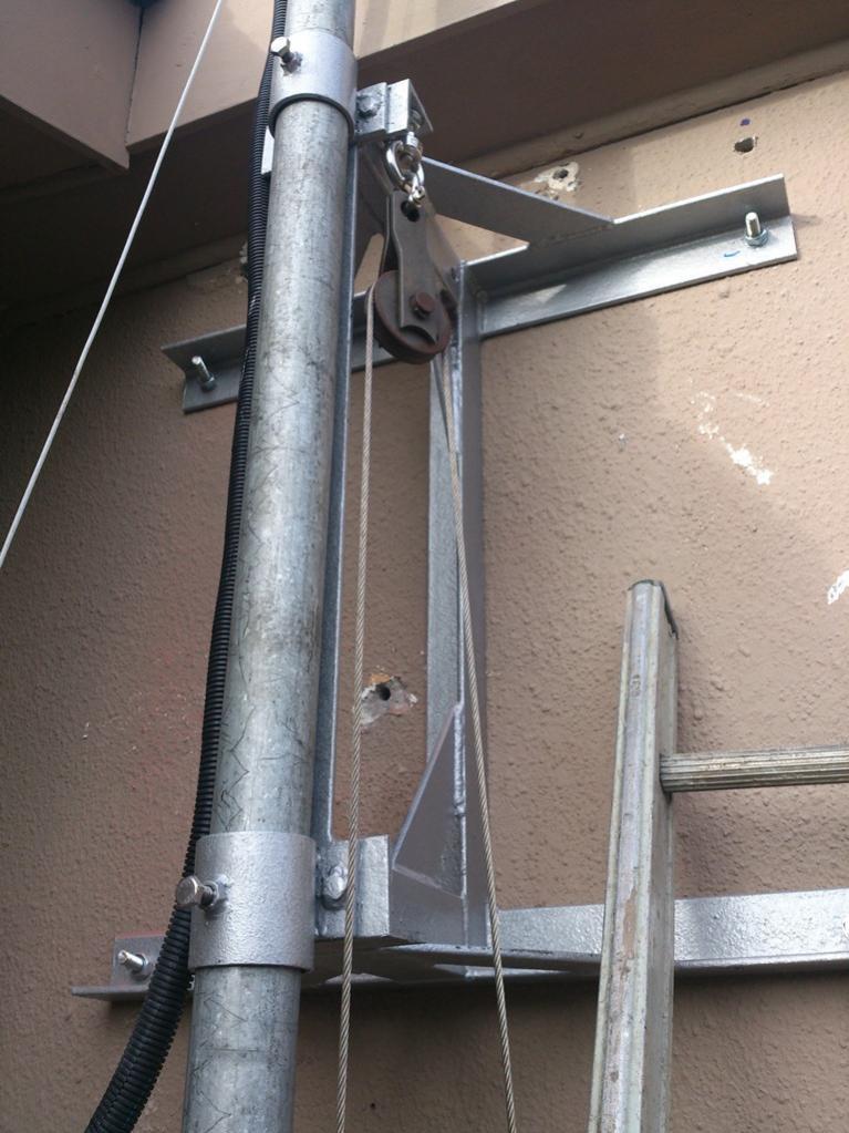

With lot of work done last night, finally the mast is back on the bracket.

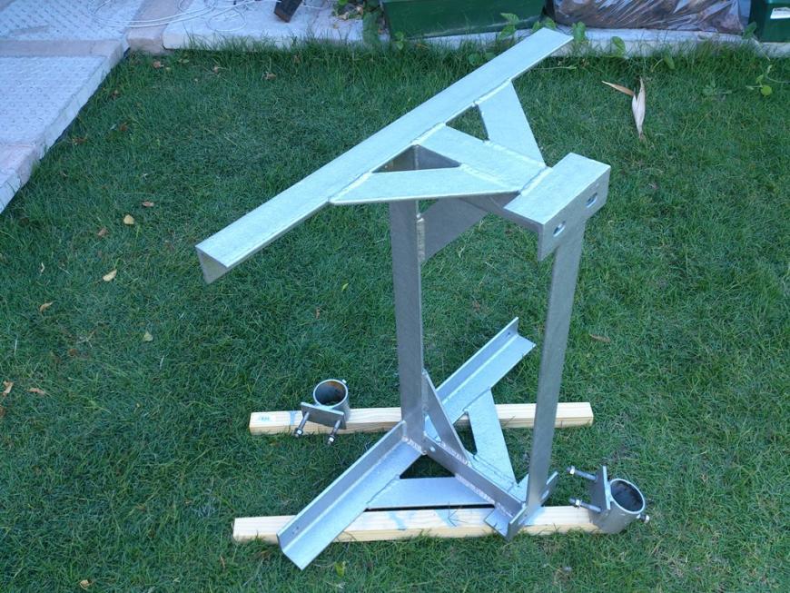

Firstly the bracket:
Then we needed one of these:
To this:

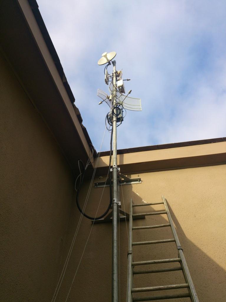

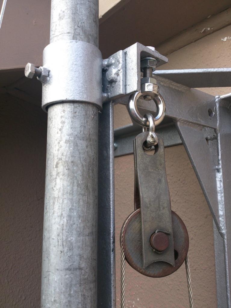

We put up the bracket back onto the wall with custom parts and even my pulley system is working again.
Hence we went from this:
To:
I will be doing the maintenance as well as putting up a nanobridge to yeti tonight. Hopefully once this is done then only the stay wires need to be sorted out.
Again many apologies for the inconvenience.

Do you perhaps have a cutting list and some costing? I’d be interested in doing the same at my place with a pully. I like the two brackets to keep the pole mounted. Will this be sufficient?

Well done on getting ure node back up and running again, the new setup sure looks nice and tidy… must say I’m pretty imprest with the bracket you’ve got there - It looks nice and sturdy. Any chance that I might order one from you, I would like to use the same setup on my Node … That pully system I really admire as well. So lemme know what it will cost to adopt a similar setup on my node - Thanks.

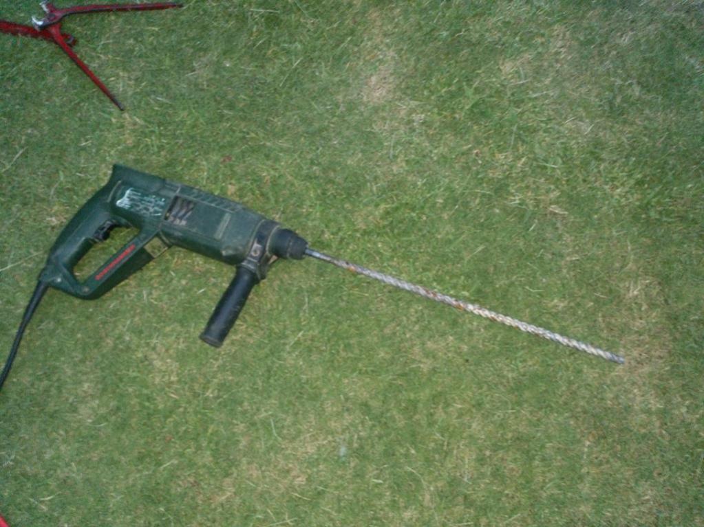

With regards to the bracket, depends on the weight of the mast. First thing I noticed when the mast came down that it weighed a lot, even more than I was expecting, from such a little gear. I mean to put it to perspective it took two people just to bring the mast down. I would advise wuggers to be careful when using the tripod brackets, they not as strong as they look especially with the Cape Town wind. I over compensated and used 50mm x 50mm angle iron with ready bar going through the wall into the roof and inside of the roof used plates to distribute the weight of the pull.
As to cutting list I cant say and I had the bracket created by a company of which I am good contact with. I just gave them the design, which I had help with from an engineer, and they did the rest.
At a later stage I will also upgrade the winch to make it easier to use.
If you want arrange a visit and I will show you how it works.
