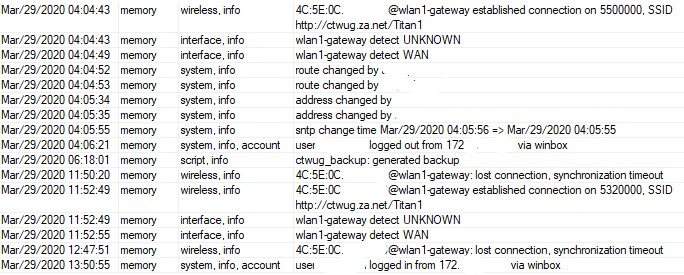

Just fFYI, uptime/connection time to titan1
