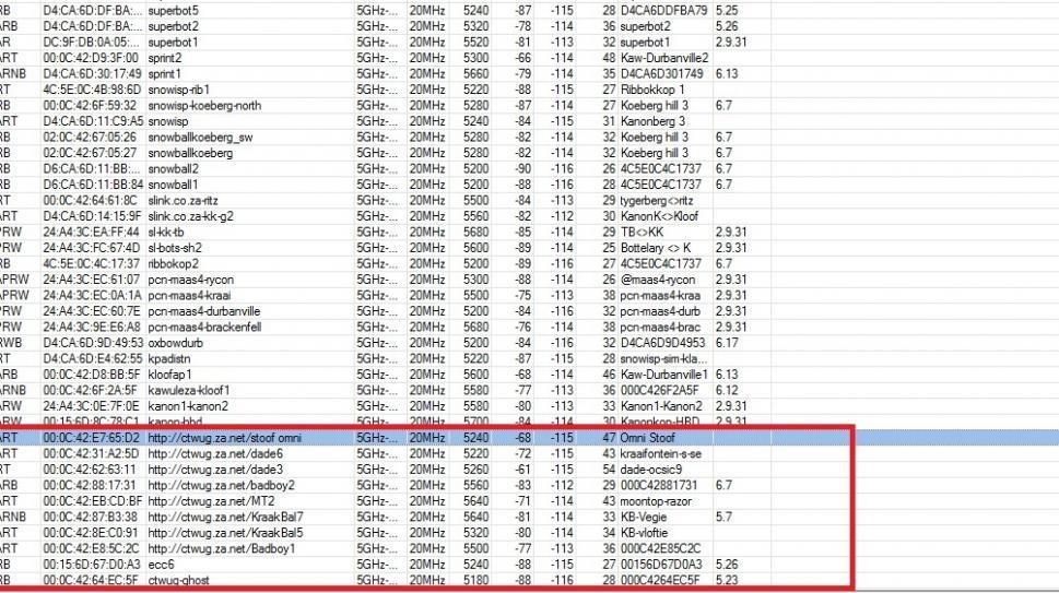

Ek het toe 'n scan gedoen.Ek het maar eers vanaand gescan so het nie baie tyd gehad om te fine tune nie.Maar op die pic is die volgende mense wat ek kon optel.
Met meer tuning vanoggend dink ek Stoof is my beste opsie vir 'n konneksie.
Dade3 -61 looks like the best
dade3 is unfortunately a BB-link, so no good on this one.
If you have no success, may I suggest (this will unfortunately require additional kit in both cases) contacting Monkleys as to the possibility of supplying you a BB-link, or alternatively talk to Anglosaxon as to the possibility of a 2.4GHz BB- link that will run through those monster trees.
I have a 2.4GHz link running from me to Spleeghe through some trees, and sync at 120Mbps with a 90+ ccq, so that should be no problem

Ek het op wind gaan kyk en volgens WIND wys dit dat dade3 'n access point is wat al reeds 4 kliente het.
Maar as ek scan wys dit na a bb-link.
dade3 is backbone :-/
daar is wel plek op dade6 is jy hom wil probeer.
Dankie dade ek scan dade6 op -62.
