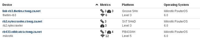

So the routers on NMS running the oldest RouterOS (6.0) are:
On WMS (which includes more routers not running OSPF) there are a couple of routers still running 5.x?
