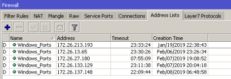

What is the firewall rule you are using?
Just an, input TCP port 135-139,445 add to address list and drop.
hi pc oorgedoen virus is af dankie
The automated version just looks at tcp/445. On a specific IP. Might be that these didn’t scan that IP, or not that port.
