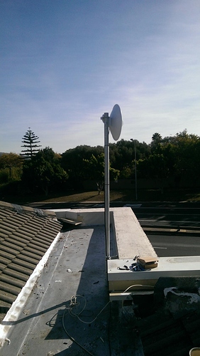

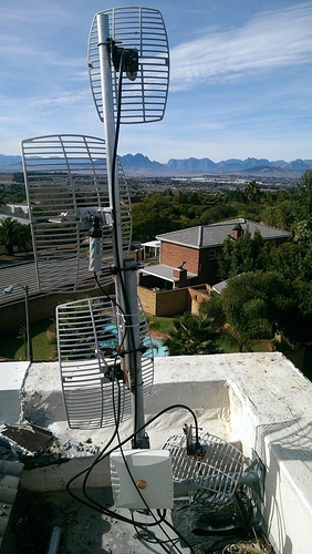

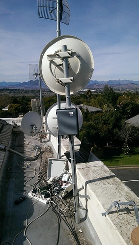

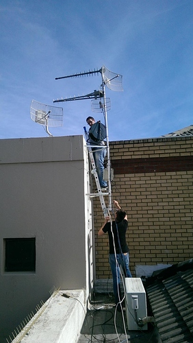

Some pictures of the maintenance we did at Callisto a week ago.
Our job consisted of the following:
  1. Remounting all bent brackets/poles
  2. Relaying damaged Ethernet cable
  3. Aligning kit
  4. Doing some tidy up work in the enclosure
Still a lot of work left, but will post any updates here.
Take note, we are working here with oldish kit. As you can see, the one dish was even mounted up side down, so now the LMR’s are all wrong (It also was damaged previously).
Maybe if DDAY goes well all these issues can be fixed, properly :wink:
Thanks Goose and Tinuva for assisting on the day.

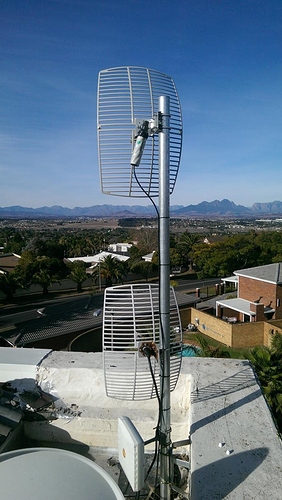

Another picture:
Oh right…I was meant to upload pictures :stuck_out_tongue:
Ek sien daai 2 grids is dieselfde gepolarize. Een (dink die onderste een) wys na my toe. Dis baie maklik vir my om by my kit uit te kom so laat weet as julle jom 90 degs wil swaai.
Hi
Dankie vir al die harde werk wat julle doen.
Wacko141 aka Goose could we perhaps get u on the Durbanville Whatsapp Group?That would help with setting up the link to Morne04 also?
Thanks
Die ander grid is op die oomblik net as 'n toets link na Stiaanm, ons gaan dit seker nog upgrade na 'n dish.
So ek dink vir nou, hou ons die polarity van jou link net so, ek het ingelog en daai link sync mooi.
