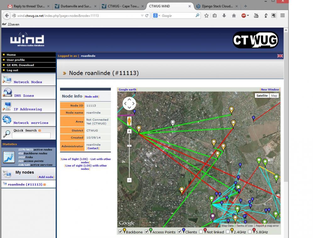

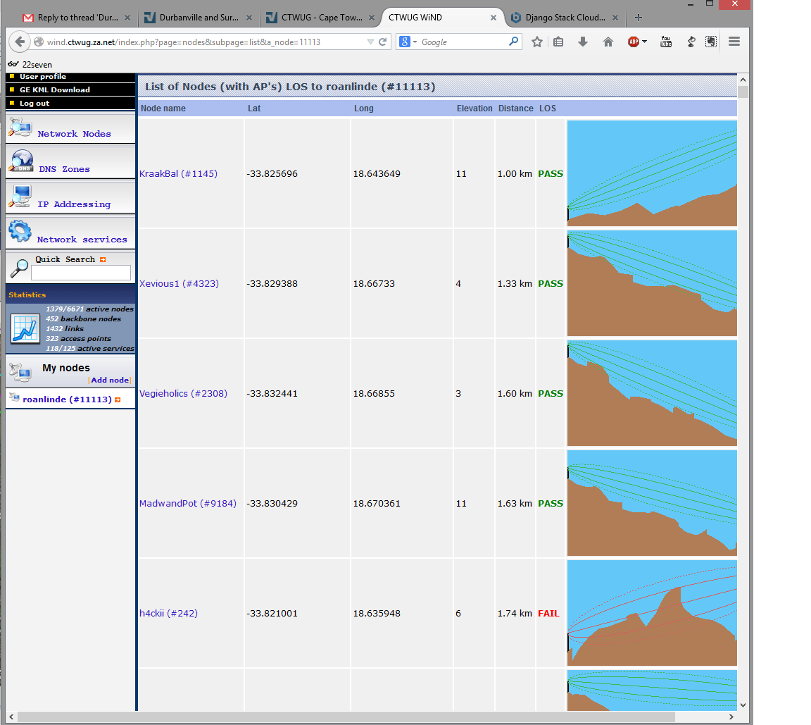

The dish I would like to put up will sit at me mom’s house (Vierlanden) - home owners I will be renting from didn’t seem to thrilled about the idea, so before I burn bridges and have to find residence on the street (along with the imminent kitchen knife threat mentioned above), it will have to do - albeit losing half the functionality.
See screenshots below, WiND # 11113 - also roanlinde
Hope I did these attachments correctly

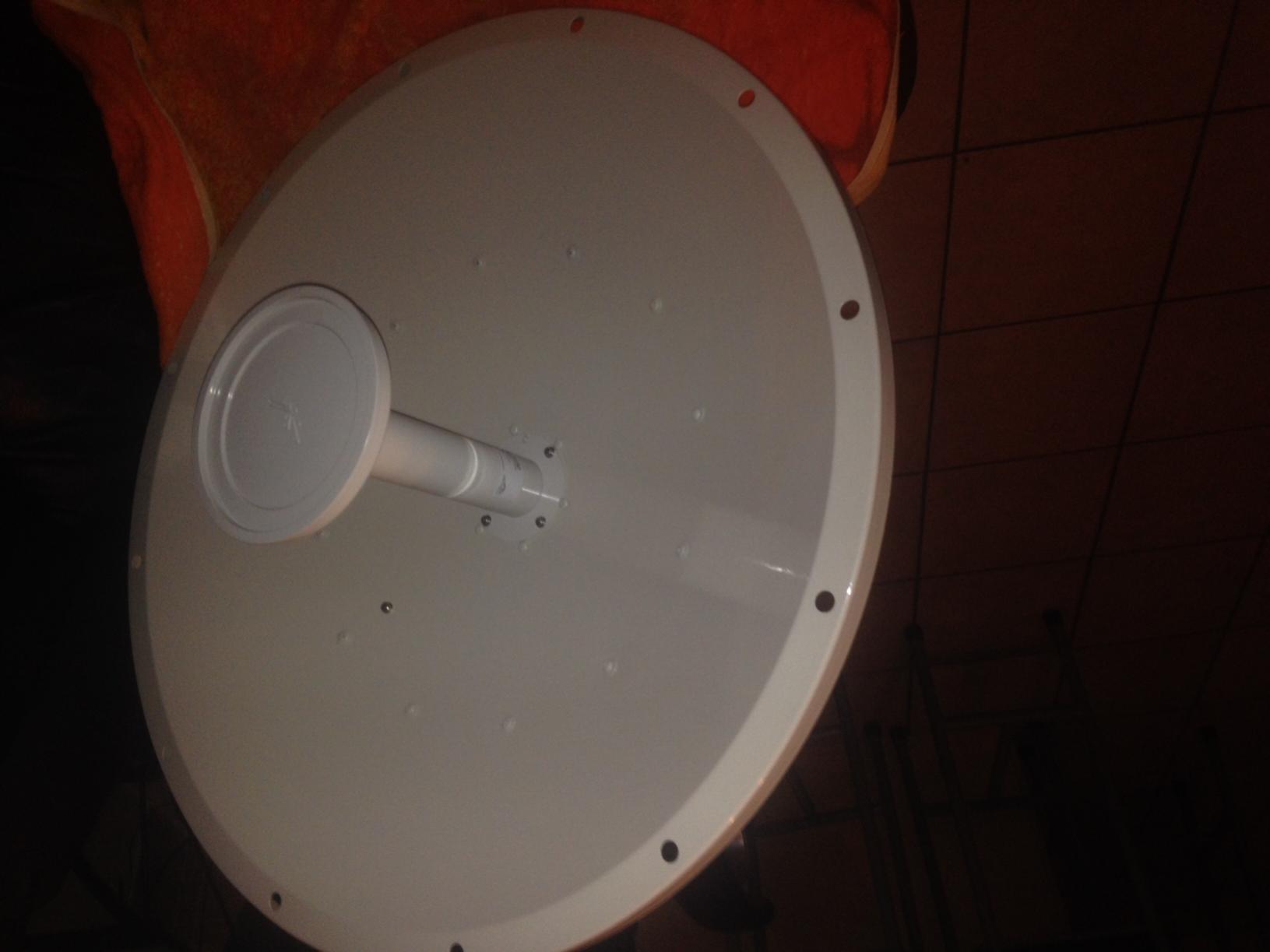

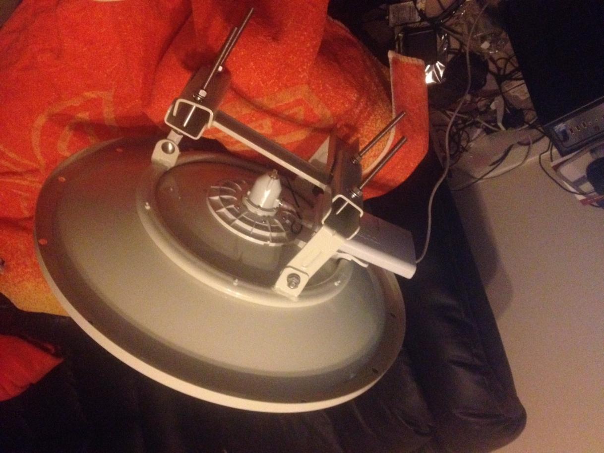

Hi Aqua, got my new -AIR-D530 - 5GHz AirMax Dish - and sommer new RB 912G 5GHz, can I finally bug you for a connect to Aquarat, also hope this stronger link could help your cause,
Just assembled tonight, waterproofing now, will drop the old baby and put up tomorrow afternoon, hope she’ll do.

Just make sure you push those plastic covers (That comes with the cable between the dish and antenna) to the max over the pigtail connection. They are awesome sealers :slight_smile:
having some fitting issues with the dome cover… won’t fit with RB there… :frowning: doing it wrong i guess, will google :wink:
bit tired now, had 16 hour days for the last 2 weeks…
So amped though to get him up… damn u CT wind…! damn u!!
What can this baby all do… lol
Dome cover? You mean cover the routerboard? Don’t put that on, it isn’t needed and wont fit with those LMR’s.
Make sure you don’t bend those black cables too much, they are very very sensitive.

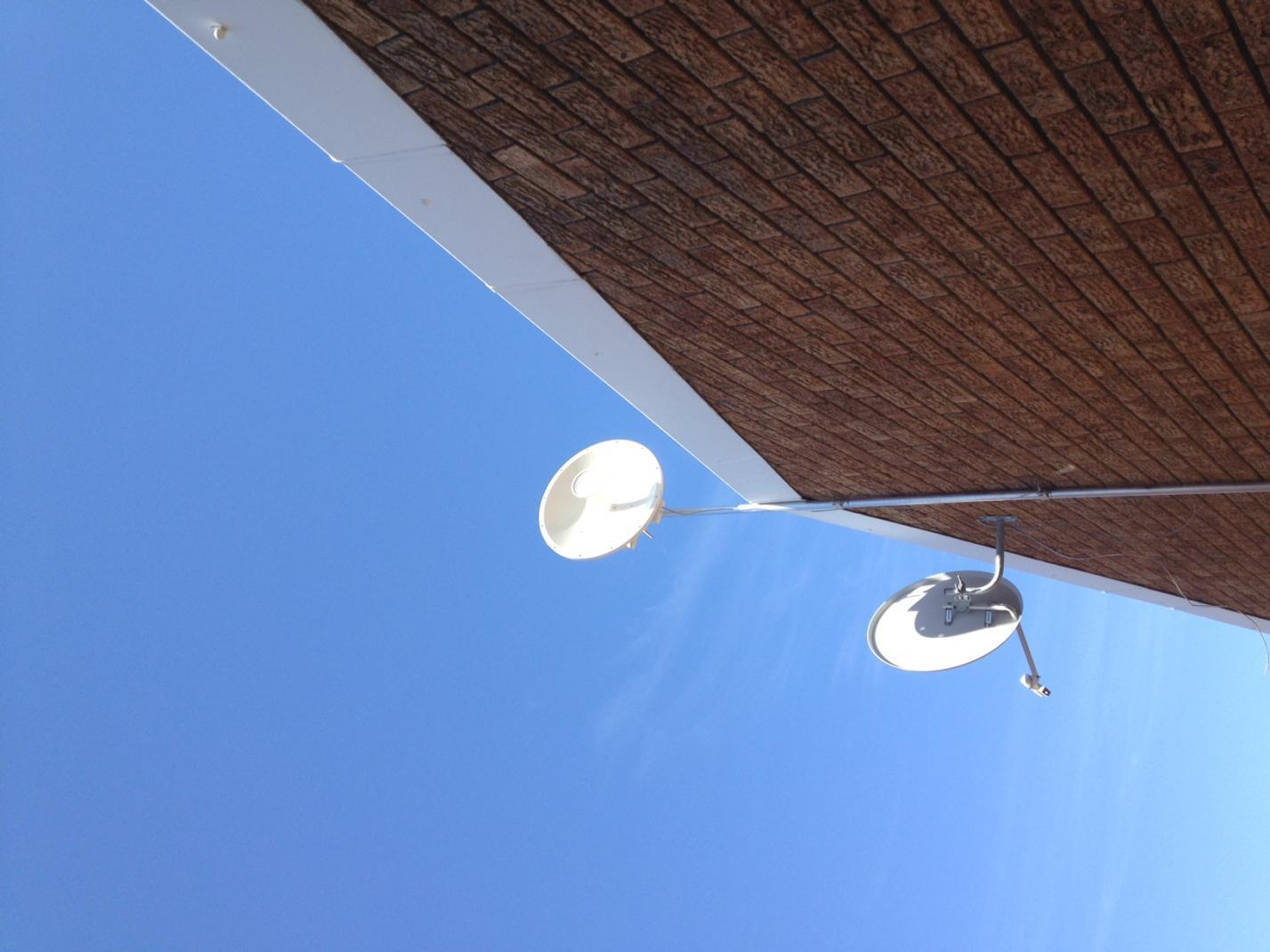

Some pics from the dish upgrade :
ta, in progress, wind making it difficult, also i see after taking down pole my tripod was cracked on the welds… gonna get a new one tomorrow morning and complete install, progressing slowly.
Has anybody got a better suggestion to mounting on the wall, the brackets seem to crack under stress once a year.
will do aqua, gonna check weight on new bracket tomorrow, dish is heavy… yoh yoh yoh :wink:

That looks like a very very thin pipe for something like a dish? It’s very low so it should be okay.
/me looks on sector
ta, eks nou by die werk, maar ja… ek het so gesukkel, staywires sal op kom more of oor more, wind test maar vandag. My skoonpa was ook van die mening, maar ek het myself blou gesoek vir groter bracket wat my 35mm pyp kan vas maak, ek beplan om maar nog twee wall mounting te kry (as ek kan vind) en staywires op te sit, daarom het ek eers besluit op 2m af teen murr en 1m op vir veiligheid.
Any suggestions vir waar ek nog sulke brackets kan kry, ek was na elke liewe HDW winkel toe in die kaap, en niemand het iets vir n 35mm pyp gehad nie, net 25 en soos jy se, 35 is dalk klaar n klein bietjie te min, m aar een man job was nog klaar frustrating genoeg met paal vas hou en self vas maak
