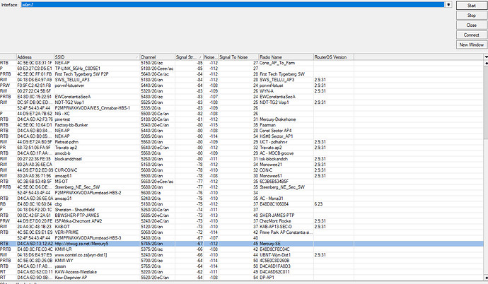

Ok, I did, ran the test again at 329 degrees (Aimed dead at mercury according to google earth, with LOS)
Anyone?
:neutral_face:
Your best bet is to create a PTP to zahier as Ash did, or to get the double story owner interested in CTWUG so that he can be used as a relay node.
That may not be an option for me as well, from my roof I look straight into a tree
I have done another scan and again can confirm I have LOS with Sirius, using the binoculors I can see the base of Ou Kaap Se Weg and the location.(Google Earth tells me is 6.24 km)
Can anyone explain to me why I can’t buy the MikroTik 5GHz 30dBi Dish? From reading I see the test kit is only 24dbi so surely higher dbi = better connection?
Finally, I have to return the test kit on Wednesday so I’m running out of time to use it.

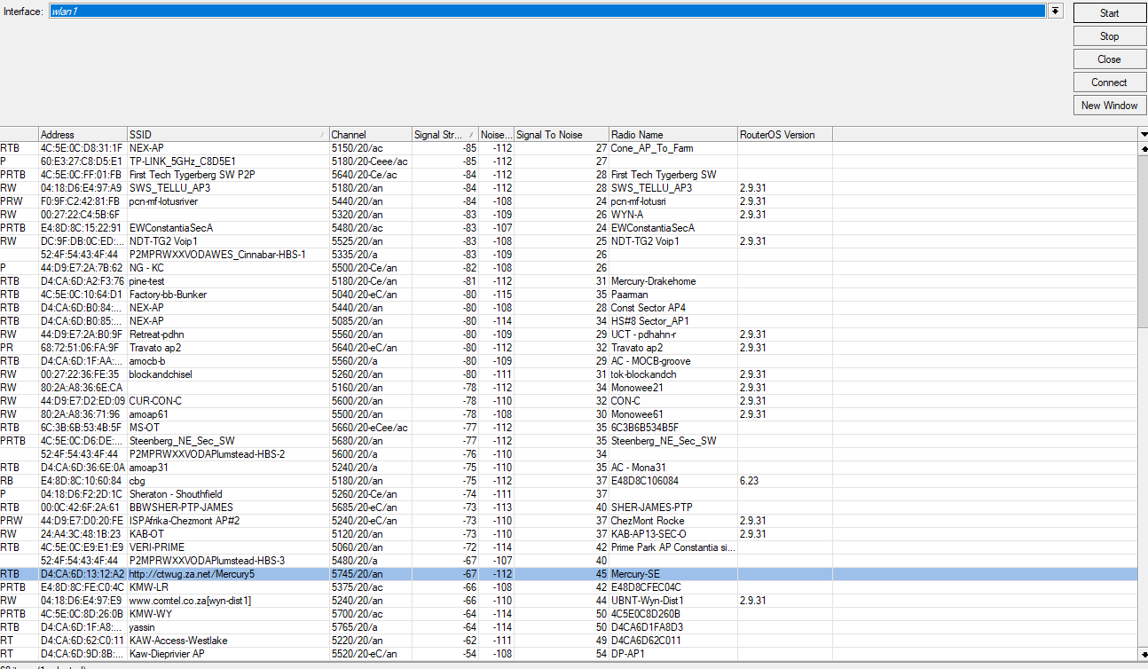

Good news, changing the TX Power Mode to “card rates” and setting TX Power to 25 yielded the below:
so it’s not all doom and gloom

Looks good @Diesal, considering you already have the radio card, you might as well get yourself a 30db Dish. You could also have a look on the forum classifieds, you might pick up a good 2nd Hand Dish for a good price (@Bronny).

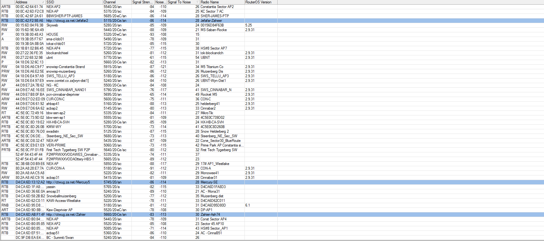

TX is transmitting power and when you scan transmitting is switch off and you loose your connection. Here is a test a did a few days ago before posting.
On the right I set the TX power to 30 on an high powered sxt and left to 3 which is the minimum it can go. Both scan ran for about 2 mins and there is no noticeable difference.
By accident I forgot to turn power back from 3 to default and was later(two days) told by a friend that my link to Fubar is badly broken and signal was in the 80’s which actually proofs my whole point.

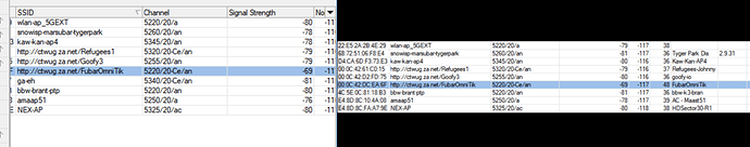

Im pulling your leg. Did the same test a few days ago and got same result as you. Never to old to learn
Damn, I must have been on some hard drugs the first time I did it, with settings reset I now get:
Much better. What did you change?
He aimed better lol.
100% my fault.
