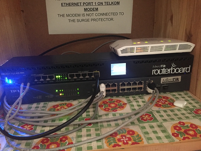

Decided that it was time to sort the network cupboard out as well while I’m busy.
Nice @Diesal 10/10 for the commitment, I am sure you will be up and running in no time.
Nyc setup buddy 10/10 go big or go home like they say

@Diesal Are you sorted now?
Nice flowers
