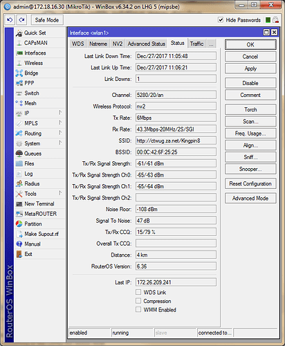

I wonder is someone can help me … i have installed the LHG and getting way better signal but TT / DC are not connecting ( I most likely did something in the config but dunno what
The LHG is currently connected to the wug, -59 … yay … ccq still crap though ( maby cause I am not downloading at this time

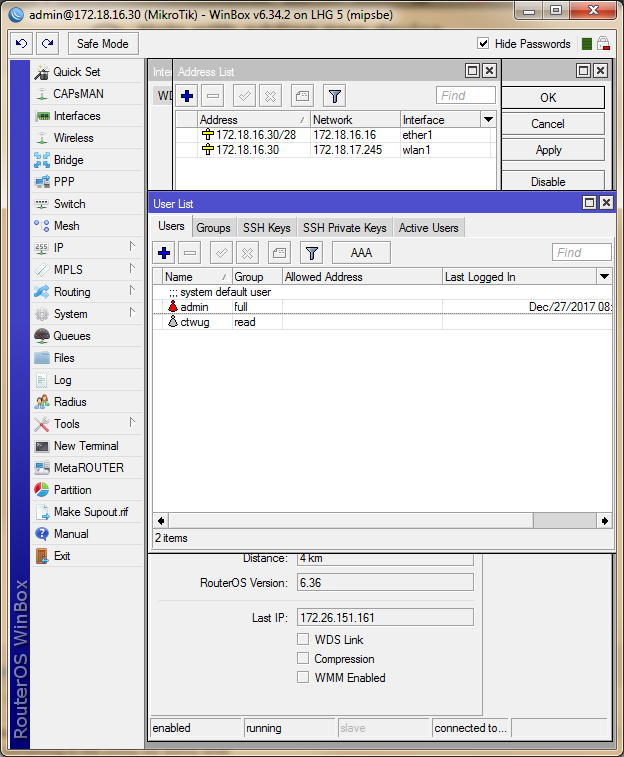

i tried to view your settings via the read account could not get in maybe mac server is not enabled on your rb or there is still default firewall rules on the rb. Did u add the route under ip then routes?

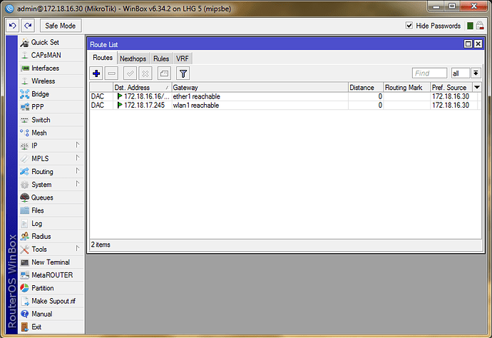

this is what is there but I dont recall adding it
u are missing the 172.16.0.0/12 route
in the terminal window u can paste this line and press enter it will add the missing route
/ip route add dst-address=172.16.0.0/12 gateway=172.16.17.245 comment=“Route to WUG”
EDIT: lol made a typo should be
/ip route add dst-address=172.16.0.0/12 gateway=172.18.17.245 comment=“Route to WUG”
it sais unreachable …
