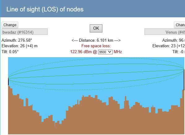

I had a look at your Node on Wind now, you are extremely close to Node Euro (no sector up there yet unfortunately), the Administrator of this node is @Trojan, perhaps speak to a couple of your buddies to get some community funding together to get a sector put up there, I’m sure he won’t mind.

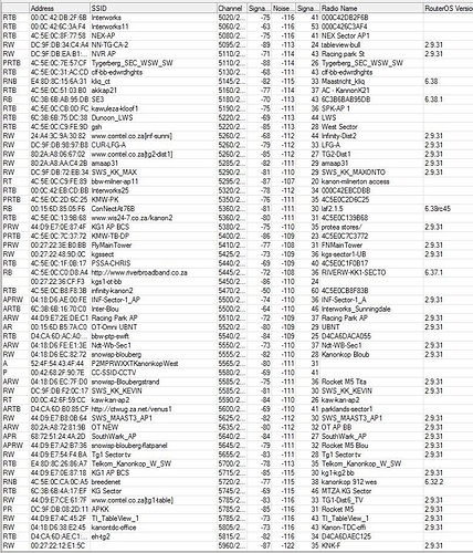

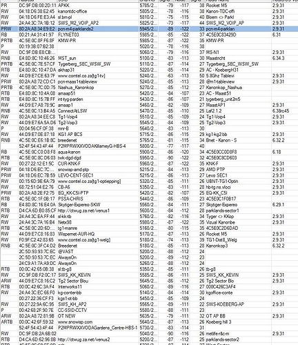

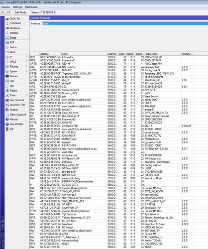

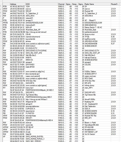

scan results from my house. any advice on the equipment to buy
Looks like you can see Venus2 quite clearly. Not sure if there’s space on that sector though?
Hey @pkarairwa, the scan to Node Venus in Parklands looks decent considering the distance. You only posted two scan pics, did you do a full 360 degree scan in segments? Scan in one direction and let the scan run for about 5-10 minutes, move slighly into a different direciton and repeat which you continue to do until you have covered 360 degrees.

First contact for the Parklands area is @darkwing, he will be able to assist you further. According to Wind Node Venus might still have space for you depending on what hardware they are using there. CTWUG Highsite Rules.
Below information is to assist Darkwing. Node Euro might not be a client on that Venus sector anymore, @Trojan can confirm, I know they were in the process of moving but not sure if the move has been completed yet.
Thanks, Venus2 is still your best bet but you will need to wait for @darkwing to respond. Keep in mind that the guys do this in their free time so won’t always respond immediately.

@pkarairwa, just out of curiosity, what device did you scan with?
@Firestarter l used the LHG5
