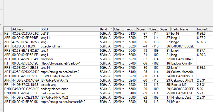

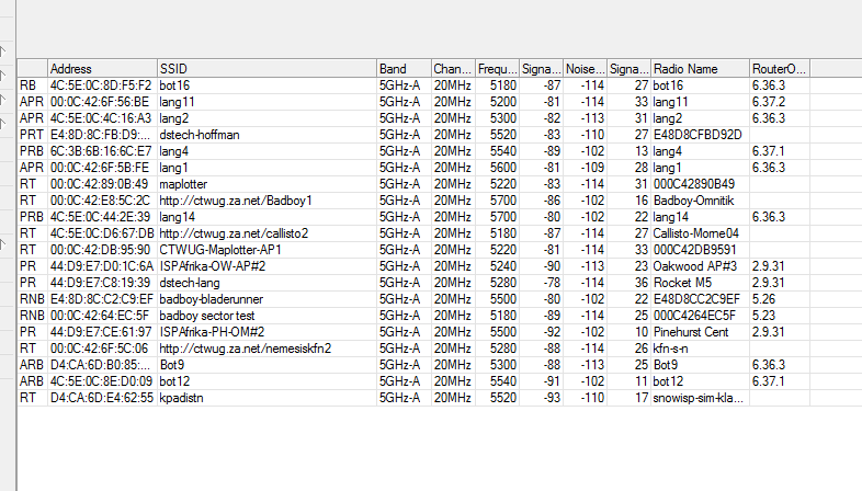

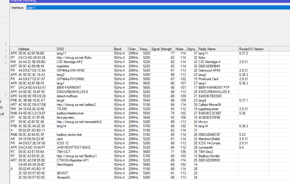

Good day guys i borrowed a test kit from someone and this is the scan results im stil a newbie …
Whats the next step …Thanks in advance
who gave u the kit they should have explained most off the stuff or maybe even set the settings for you before u took the kit also what kit did u use? But not good results and i would suggest putting a custom scan list 4900-6000 and frequency mode on superchannel because some equipment run on custom freq and on superchannel mode then it will pick up anything in that scan range

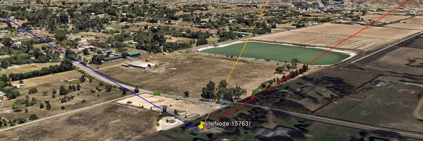

As important as mentioned by razor1, please plot your node with more accuracy. It currently shows you out in the fields at a T-juction, doubt whether that is where you are staying :smile:
hy wil wug op sit in die bos :grinning:
i have some 2.4ghz equipment if you want to try to connect to me, but first get your node properly plotted and maybe i am high enough to help you.
hi good day i have adjusted the coordinates accordingly now hope its right. ive also added stiaan and wolffie as co admin to the node.with the help of my work colleague thanks in advance

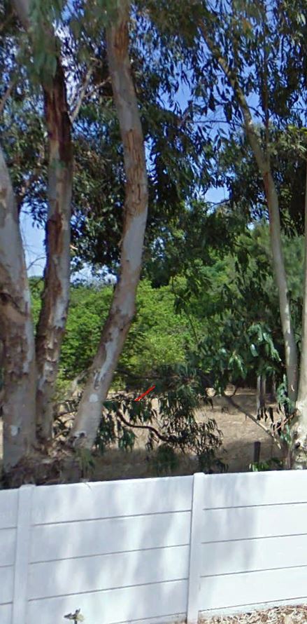

My thoughts would be that you are most likely to have success to wolffie (Node 2883), might need to play with the physical placement of your mast to bypass some of the closer trees.
Blue = wolffie
Red = Darksaint
Orange = Badboy
Towards wolffie (you should be able to clear them due to elevation):
Towards Darksaint:

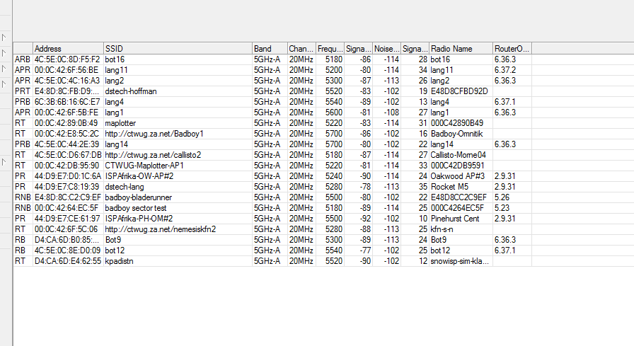

Hi Wolfie

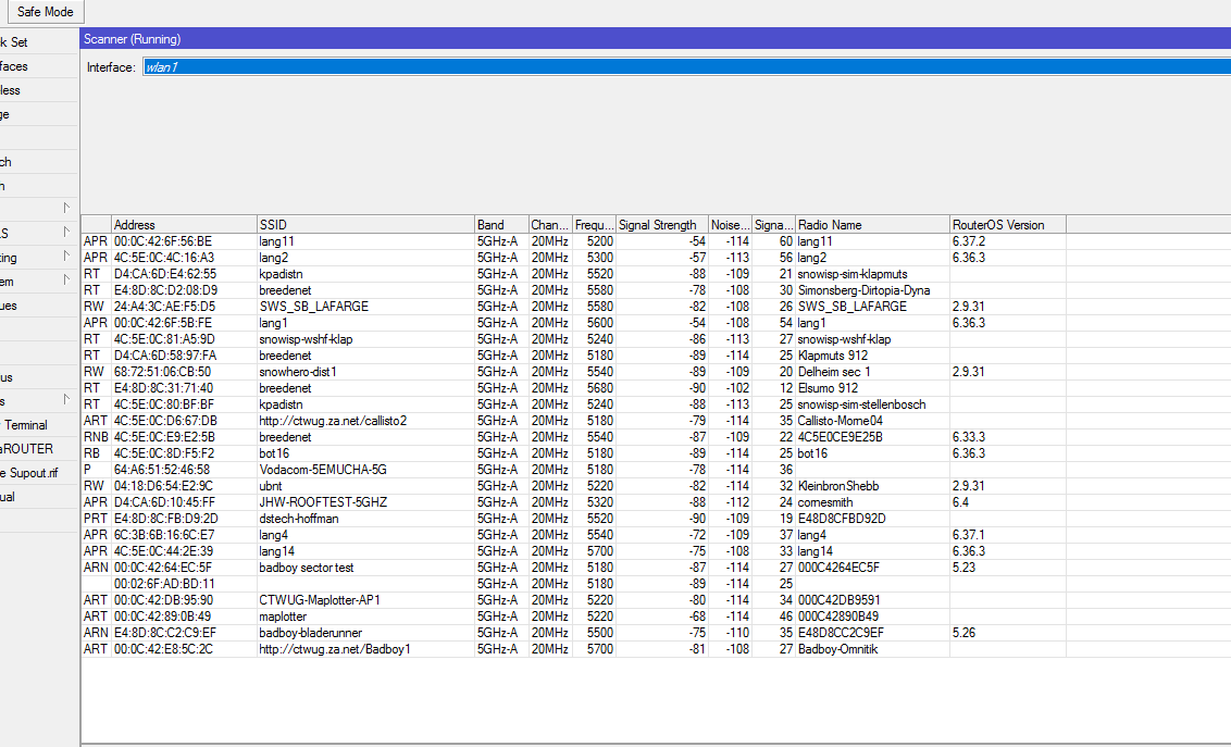

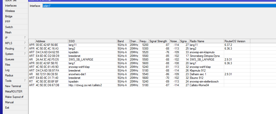

i have try 100 times may be i am doing something wrong but this is what i
get. I some professional help. I am scanning from my roof.

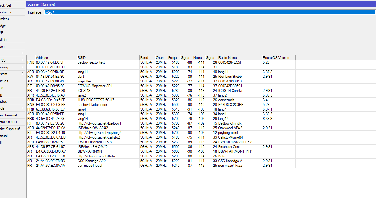

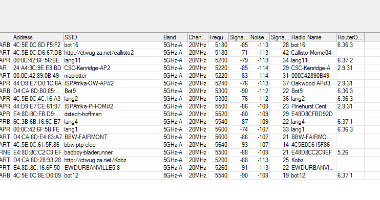

This might sound a bit weird, have to ask to confirm though:
What equipment are you using to scan? Which direction is it pointing during the scan?
From the scans attached, signals in each seem to be just about the same to the same sites.
en scan list is nogsteeds op default en hy het ook nou nog nie die vorige vrae beantwoord nie
Het in die rigtings gewys na aanleiding van die foto wat ek ontvang het
Hoe lank en waarmee?
