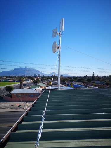

1 x 750GR3 RB
2 x Powerbeams
Existing Litebeam at WESA
New Powerbeam to WESA at Firestarter
New Powerbeam to MARS at Firestarter

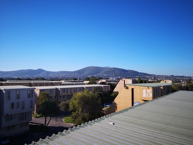

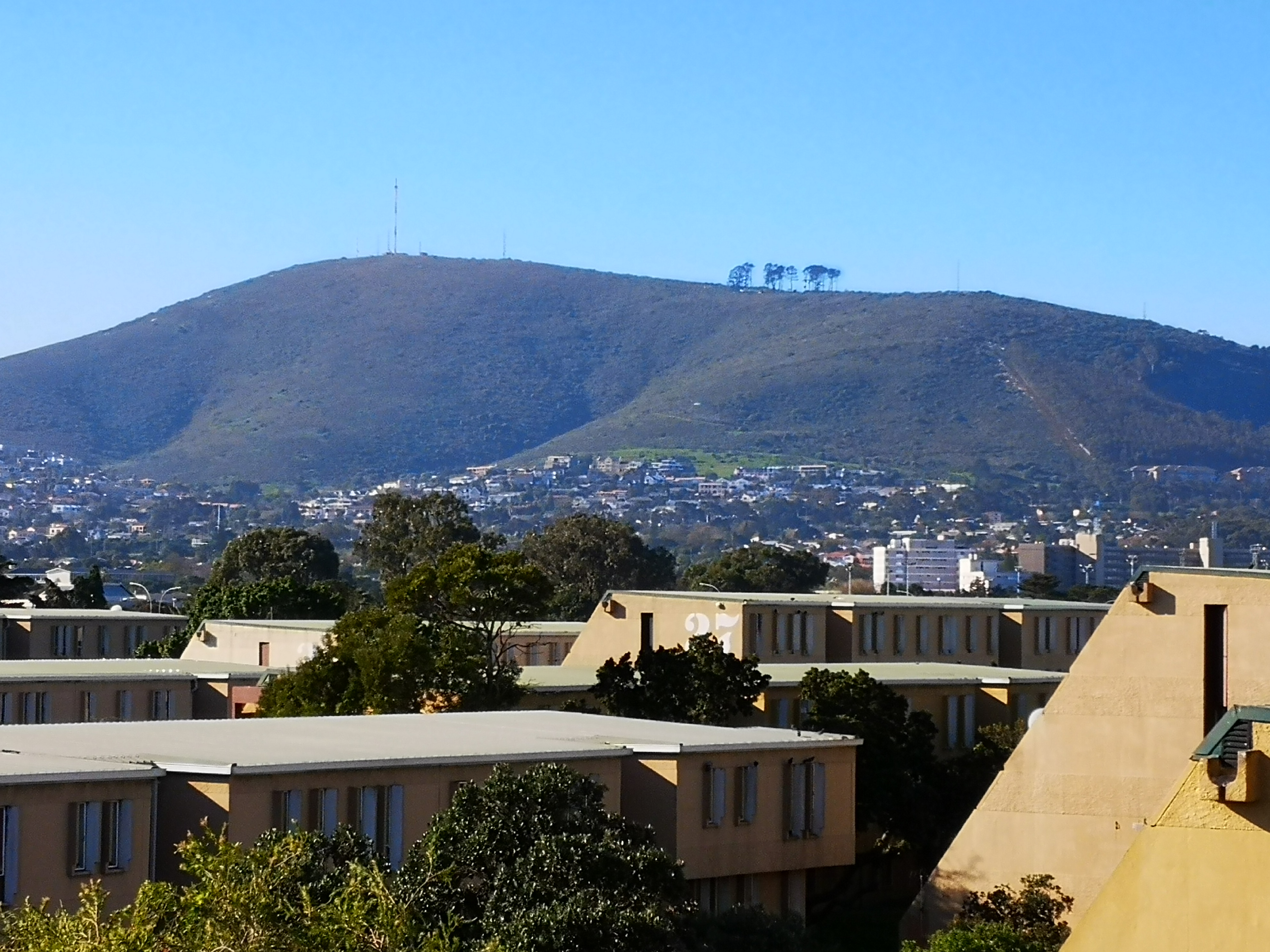

KGB Side :

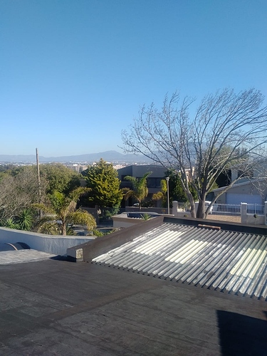

Parow Park side
There are more photos than this one taken from the two poles
