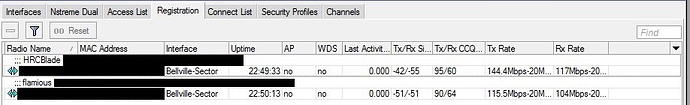

let me give you a rundown of what happened.
about two weeks ago ar 03:00 my receiving ccq dropped to about 45-50. and four hours later, titan-bellville went down.
4 days later the sire was rebooted and the links went up again. but the ccq problem persisted.
it is the tx ccq of the sector that stays low, even when my signal was -48 to -51, and it gets worse when it rains. yet both hrcblade and my tx ccq remains 90+
see the [redacted] grabs below
so i can only deduce that it is some fault with the antenna or its pigtail…
