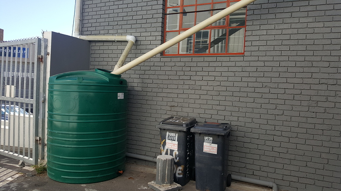

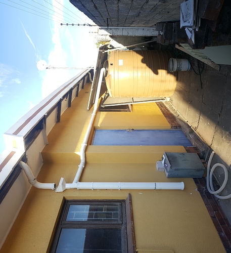

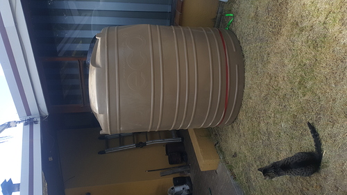

Made my own first flush system this weekend, and installed 3 x 2500L tanks. Now it must just rain!

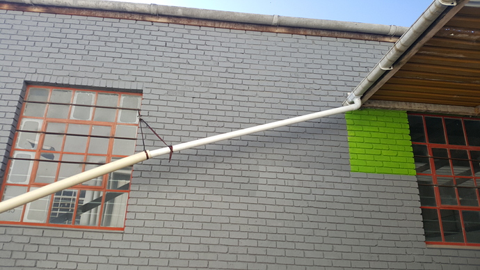

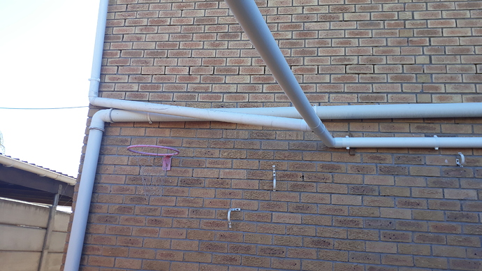

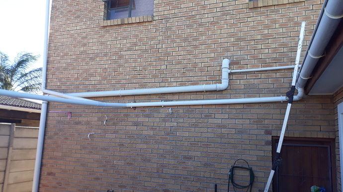

then I realised that the roofs at work represents HUGE catchment real estate and rigged a temp system there. Pipes will be neatened up next week. should fill thqat tank QUICKLY if we gat any decent rain.
I will gladly explain if anyone wants to know the ins and outs of the first flush rain diverter or anything harvesting related.

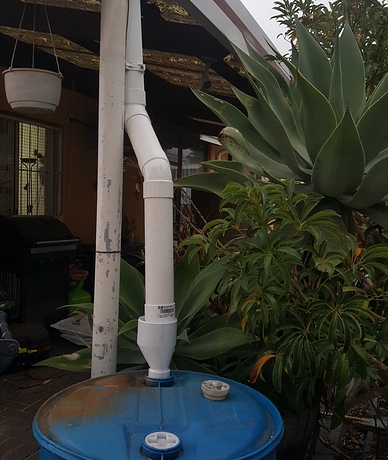

2 x 45-degree bends, a 110mm to 40mm Reducer and a drum. simple.
