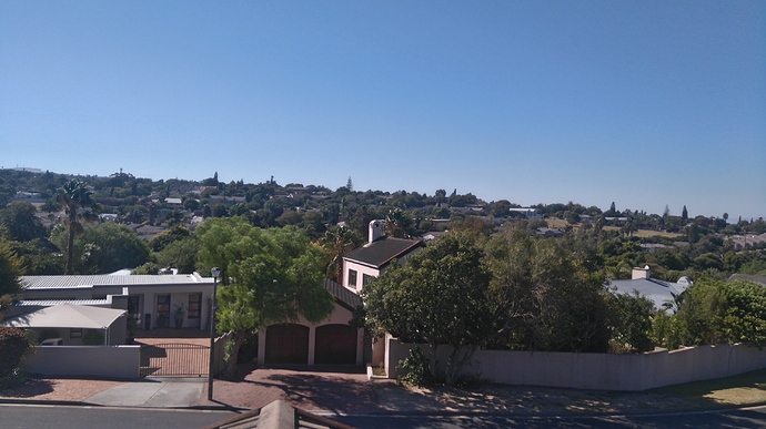

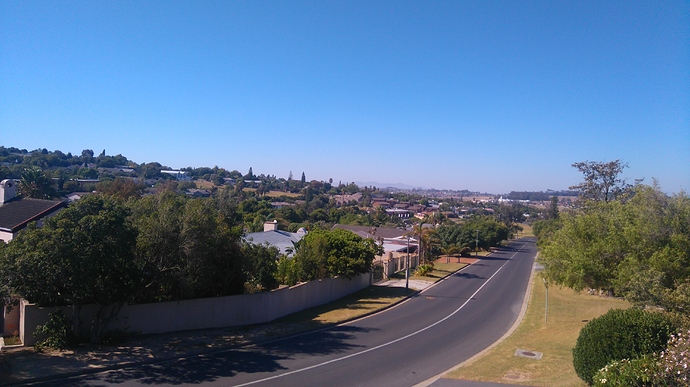

I did hop on my roof last night quick and did a 30 second look. i can just
about see Zassie’s kit (i think) but SOLO i cant see at all. ok there is a
tree in the way so will likely have to do a scan to see if we can see each
other.
Think i need a list of what i need to get this up and going … lol…
Hey @jacktherabit
I would say, jump on your roof again and take some hi-resolution photos and post them here so we can have a look.
The whole AC thing is not an issue, the kit that @Gordon808 is will to swap for is more then fine for what we wish to do.
We can always try a test kit scan for piece of mind, but those photo’s i’v mentioned above can tell us all we need to know hopefully.
So i would say next step is to take some photos for us. all the way around you.

Hi there folks,
@Zassie so finally got a few mins to get on the roof and take a few pics, so the double story house to the right of the chimney there is a nice tall Palm, i can see 2 dishes through it, which im guessing is Zassie, then the other pic is behind me and to the left of the tree, i think thats Solo? also took a pic down the road looking towards Glen Gary as i know there are some guys down that side too. bu the looks of it a 4m pole will do?
(hope this helps Zassie?? )
