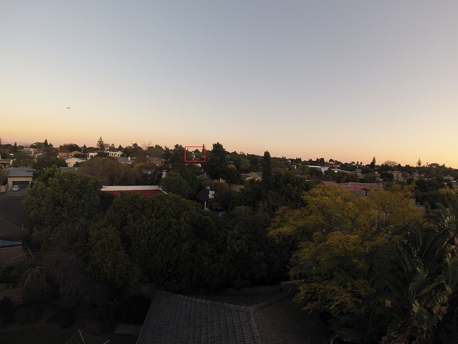

This is what my LOS pics look like from the very top of my pole.
The red square is where i think you should be… Weird i don’t see any palm trees tho xD
I will get Solo to have a look and confirm that that is his site that you see!
But everything looks great so far!

yup thats me, you just see my roof no the right for that square. (however
dont want the pole up on that side as my cabinet is in the garage. which is
to the left ) if that all makes sense… lol.
but i think we will be able to get a good link going…

I would rather mount the mast where we can clearly see there is LOS, just lay a longer LAN cable. It shouldn’t be more than a 100meters. Just make sure you use proper outdoor cable with shielded connectors.

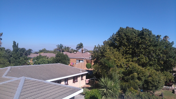

So heard back from Solo,
Circle is solo and square is voyager!
So this is great news and should be a really simple and easy link to setup!
I would definitely say this is all go from my side!
